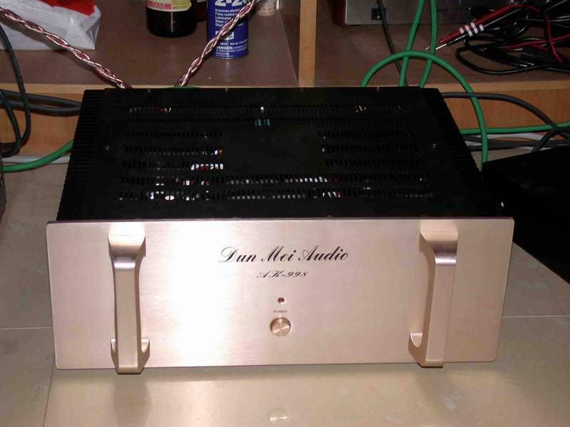

Can you post the circuit with the PNP devices, please? You use better PNP devices or they sound better in general?
Regards
PS - BTW, nice work. Congratulations! What about the finish of the front panel?

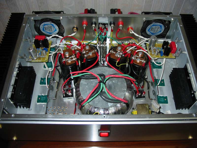

The PNP BJTs amp sounds better than two amps of NPN BJTs amp.
the BJTs of the PNP amp:
2SA970 2SB649A MJ15025*2
the BJTs of the NPN amp:
2SC2240 2SD669A MJ15003(or 2N3055 or 2SD555)*2
The circuit and the front panel pic will post days later,because of i have not a scanner .
Cheers.

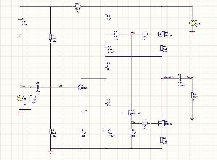

Just curious if anyone has actually built a mosfet version of jlh. I simulated a jlh1969 with irf540 as output devices (you have to change some of the values) and it looked very nice on paper but i have no idea how well it will do in reality.
So anyone tried mosfets on those amps?

OK, here is the mosfet jlh1969 that I put together.
it uses two irf540 as output devices. No signs of instability in simulation (so no gate stoppers for the IRFs), and A/C hum (for a 10vpp ripple on the supply rail) is 50mvpp.
THD at full power: 0.12% @20Khz, 0.07% at 10Khz, 0.05% @ 1Khz, and 0.05% @ 100hz.
response flat to 100Khz and starts to roll off after 300Khz.
I haven't built one yet and would love to see other's experience with a mosfet jlh.
