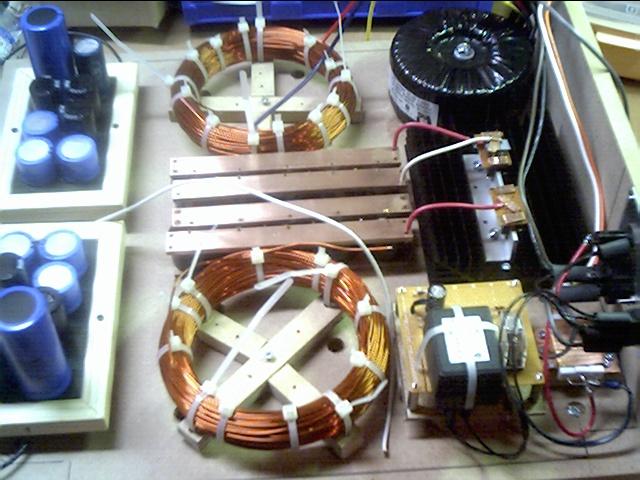

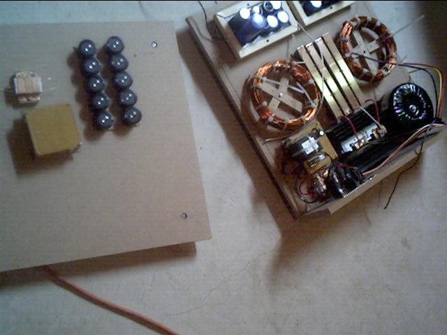

Inspired by Argo to try inductor instead of cap multiplier.
Yes I made four of them with 14awg. They measure from 2.89mH to 2.93mH
Chris

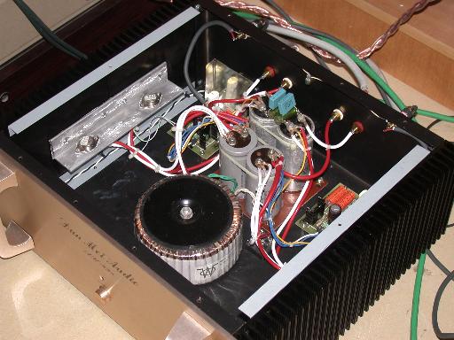

HI,all.
I am a new come from China.
I DIY three JLH 20W AMPS months ag😵ne of them using PNP power BJTS,and sounds best .
(soorry,my Engish may be POOR tocannot explain what i mean.But i would try my best .)
the PIC of AMP is in another PC.I will show it tomorrow.

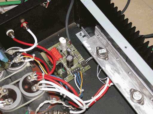

JLH Cl A
Nice work X.G ! Neat layout. Most of my projects start off neat but after changing components, messing about with the circuit etc it becomes a mess. In Audio Amateur years ago, Nelson Pass had a photo of a project ( 40 watt Cl A ?) in the prototype stage, being a heap of components in space soldered together ! Maybe he could post it if he still has it. Maybe someone in touch could raise this with him.
Cheers T
Cheers T
Re: JLH Cl A
Thanks your encouraging
cheers
