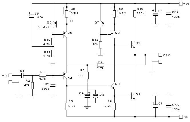

Hello All,
here the results of my JLH amplifier.
It was build as follows:
C1 = 2u2 MKT
C4 = 470u
C4a = 100nF MKT
C6,7 = 220u
Q4,5,6,7 = BC559C
Q8 = BD140
Q3 = 2SC3421
Q1,2 = MJ15003 (paired)
schematic:
power supply:
2x15V 120VA C-L-C topology.
After building it without C4a, I noticed some oscillations around 14KHz,
cause of this was the inductive component of C4,
100nF was placed in parallel with it, and the oscillations were gone.
further the higher spectrum was checked, and some oscillations were found in the higher regions.
after placing a capacitor of 33pF in parallel with R8, this was solved also.
The spectrum is from 8Hz to 94KHz now (-3dB),
with a good looking sine wave (no distortion meter present to check).
When Q3 is replaced with a BD139, the the extra cap over R8 can be removed and
the spectrum gets much larger, so I will test the sonics of both configurations.
And I will do some test with WIMA input capacitor and elna silmic for C4.
Greetings.
