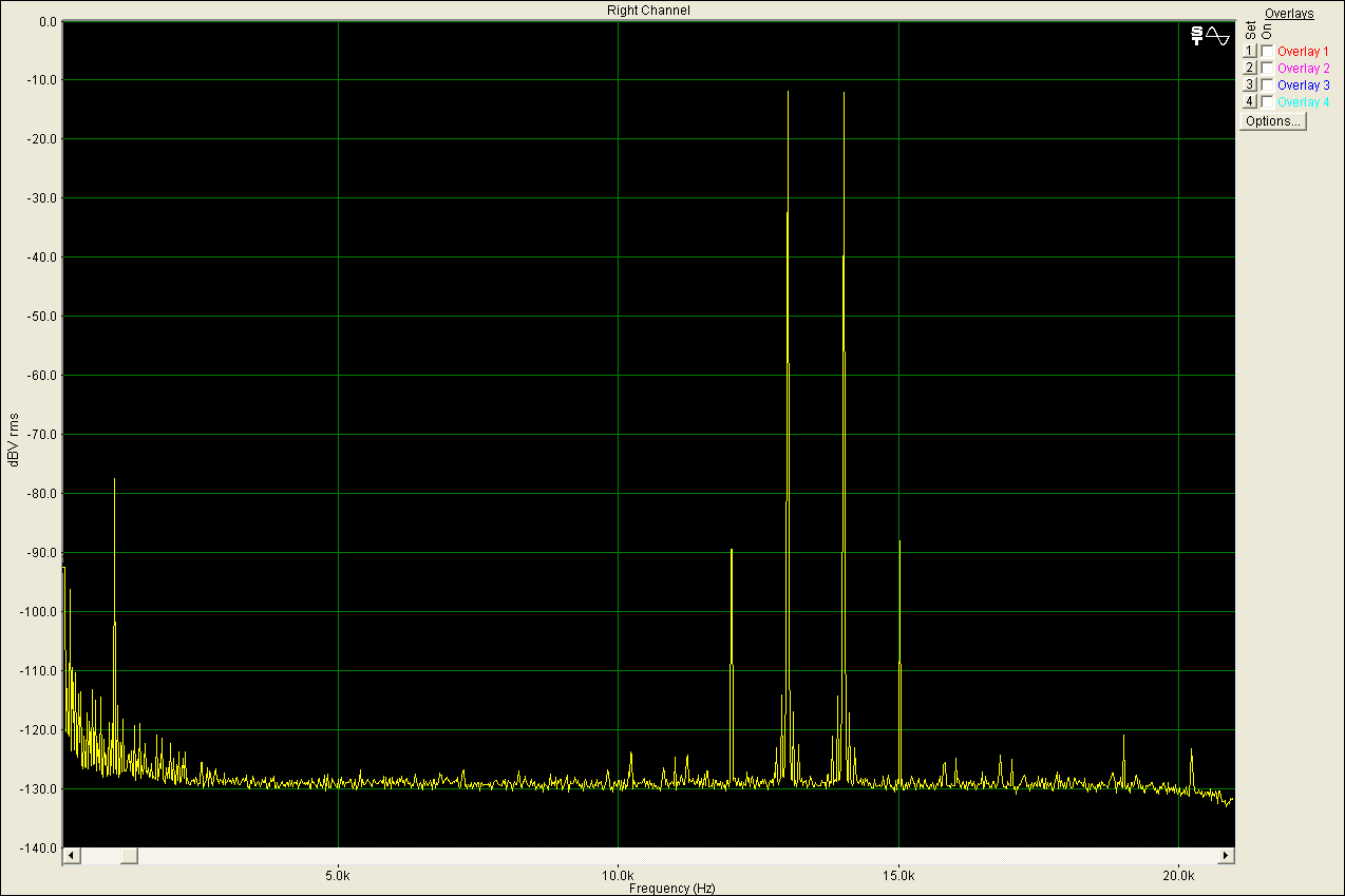

Just tried what must be the No10 version of a cheap oscillator. It is a single Wien oscillator with damped lamp. The cold resistance of the lamp + 82R is 140R and rises to 146R due to meter current. 300R seems enough to get a reliable gain of 3. The idea here is to ask the same question as people did when the TL071 and LF351N op amps came along. Could one modern op amp beat two LM741's? With a filter stage I think it is just about better with one. Hum seems better. A better use of a NE5532.
The filter is a Chebyshev that is ideal for unchanging frequencies, not great for EQ stages. I found a sweet spot to have near unity gain. The filtering is about 7 dB at 20 kHz which is fine, theoretical would be 10 dB. The Sallen Key filter is the easiest to make and isn't asking the impossible of the op amp, GBP of about 1 MHz needed. Use 33K for circa 1 kHz. You will have plenty to drive a variable resistor.

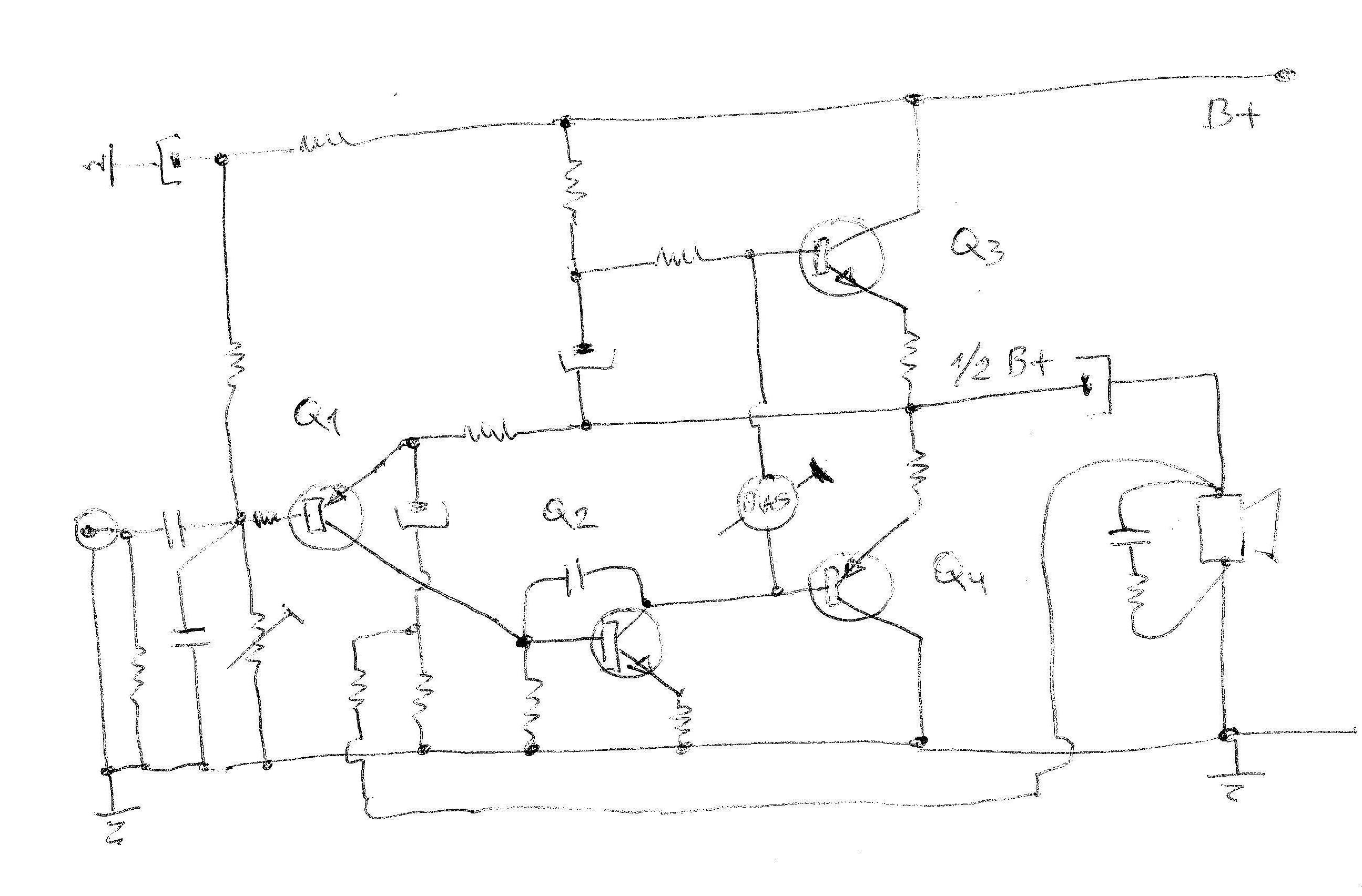

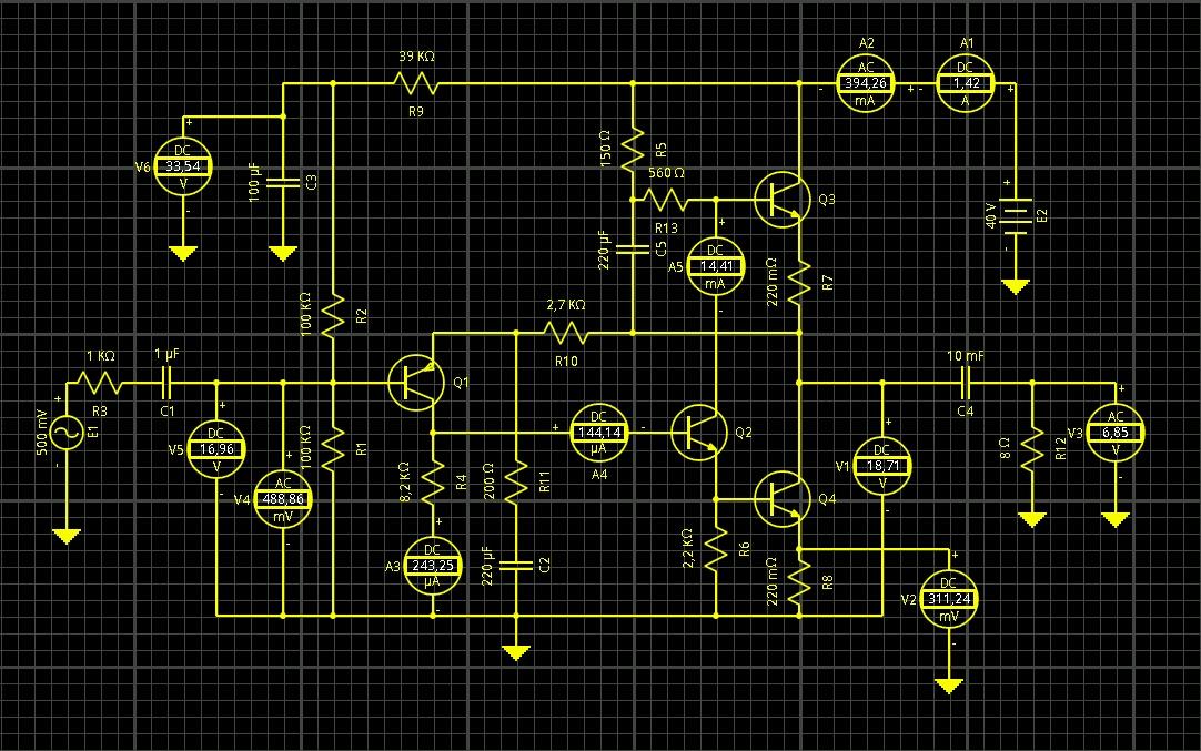

What about this simple JLH1969 `Complementary power pair` four BJT amp alternative ? ,
since in year 1969 Mr.JLH did not have complementary output power pairs available ,
where all four transistors will work in non switching A class regime ,
and where Q1 can be BC212 ,2SA872,..., Q2-2N1711 ,BD139,2SD669 ,..., Q3&Q4- 2N3055/2N2955,-2SC5200/2SA1943,...,

Nobody makes this simple A class amp, anyway personally I`m interested in most simple variant with most available BJT`s ,and to be DIY easy&safe for most of DIY members ,
where Q1-BC212 , Q2-2N1711(BD139) , Q3/Q4-2N3055/2N2955 ,with B+ around let`s say 24V / 8 ohm LS , ...
I think that nothing is wrong for output coupling cap if is wrapped in GNFB loop ,
and yes this simple topology is heart of any simple Quasy AB class amp from 60` and 70` .

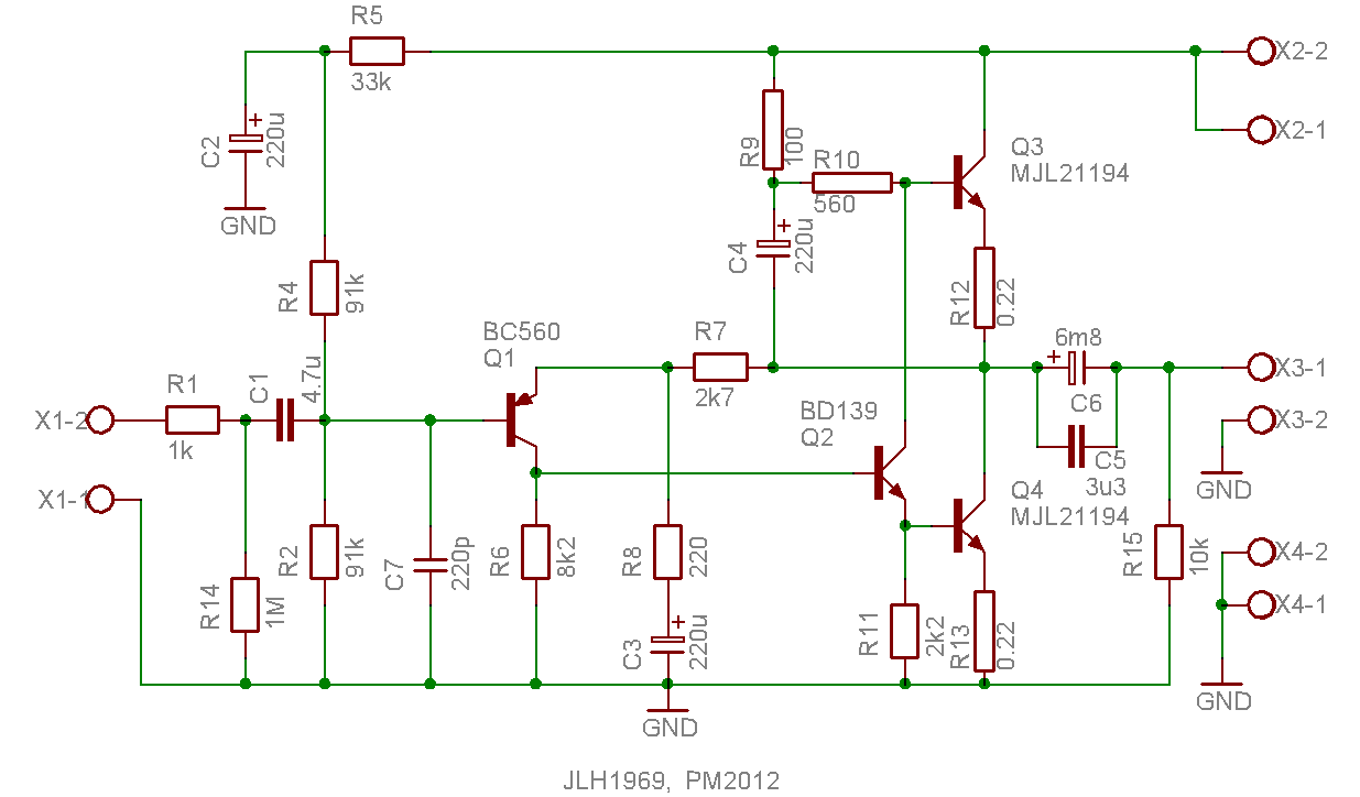

PMA had some good reasons backed by his measurements regarding why JLH is enduringly popular:
"If you do not need high power, this amp is perfect"!
(Underlining add by me)
1st transistor is BC560, driver is BD139 and output devices are MJL21194

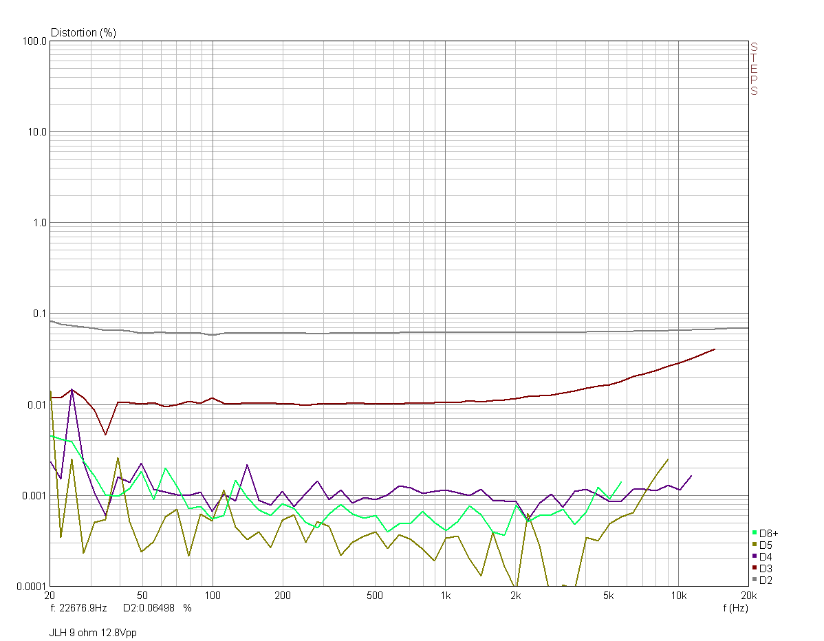

Anyway, I find several important points that might be the reason why this design is timeless.
For home listening, I have measured by oscilloscope and by transient recorder that I do not listen at higher voltage amplitudes than 2Vpeak. And most often it is like 500mV peak. So, the power is not an issue and THD at 100W is totally unimportant at such conditions, but 1st watt (as per Nelson), or rather 1st 100mW are important. The JLH, with its quite high idle current and possibility to give about 1.7x idle current for the reason of phase-inverted drive of the upper and lower output device covers low power area much better than ANY class B or class AB biased somewhere at 200mA. And THIS counts. At low power, the JLH has NO higher harmonics in the spectrum, though with high NFB "low distortion" amplifiers you will find low level high order harmonics (above 9th) as a rule of thumb, if you have enough resolution. This results in a dry, tough sound. These high harmonics are a result of NFB that suppresses low order harmonics at expense of creating high order harmonics, yes in a very low level.
The other important point is that JLH distortion is independent of frequency (which is not the case of the MOSFET PLH).
And, the output impedance is not that non-linear as class AB amplifier's.
So, if you do not need high power, this amplifier is perfect. In case you invite 20 people to listen in a room of 100m2 area, then forget JLH, I agree, and get high power high NFB "up-to-date" design, I agree. In case you need to install a sound system for a rock concert, then go for PA and forget ANY hi-end hifi amplifier.

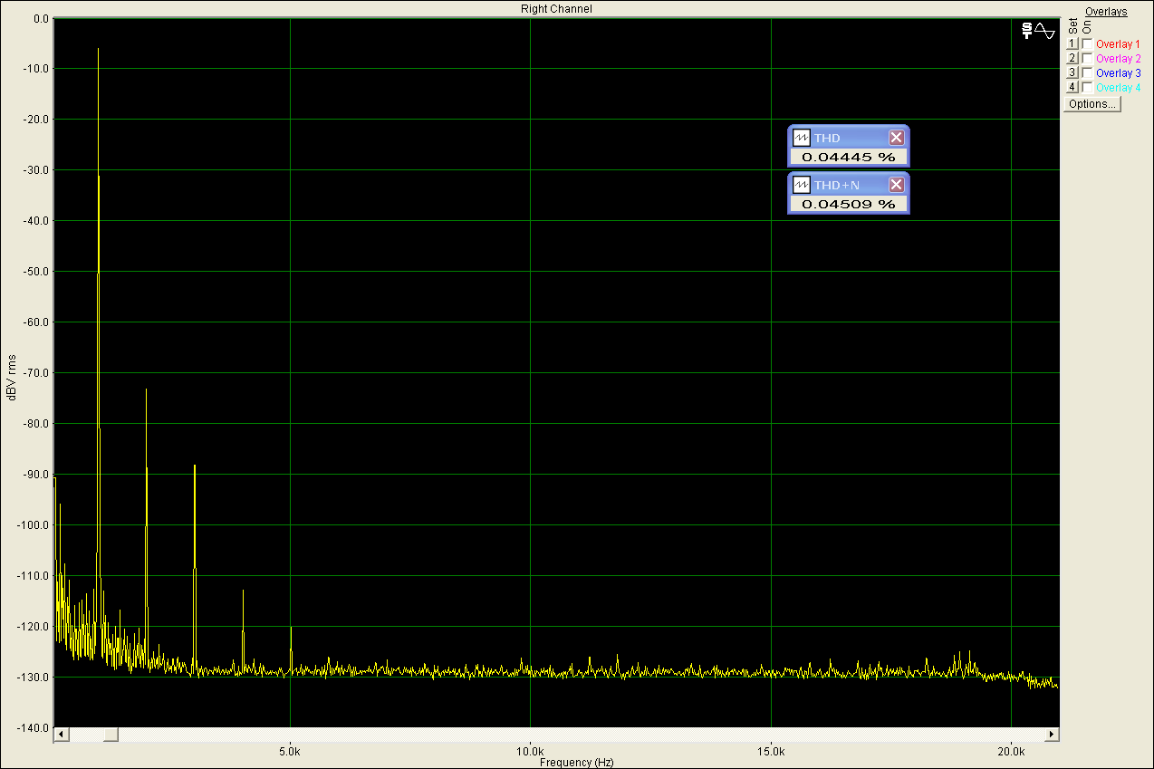

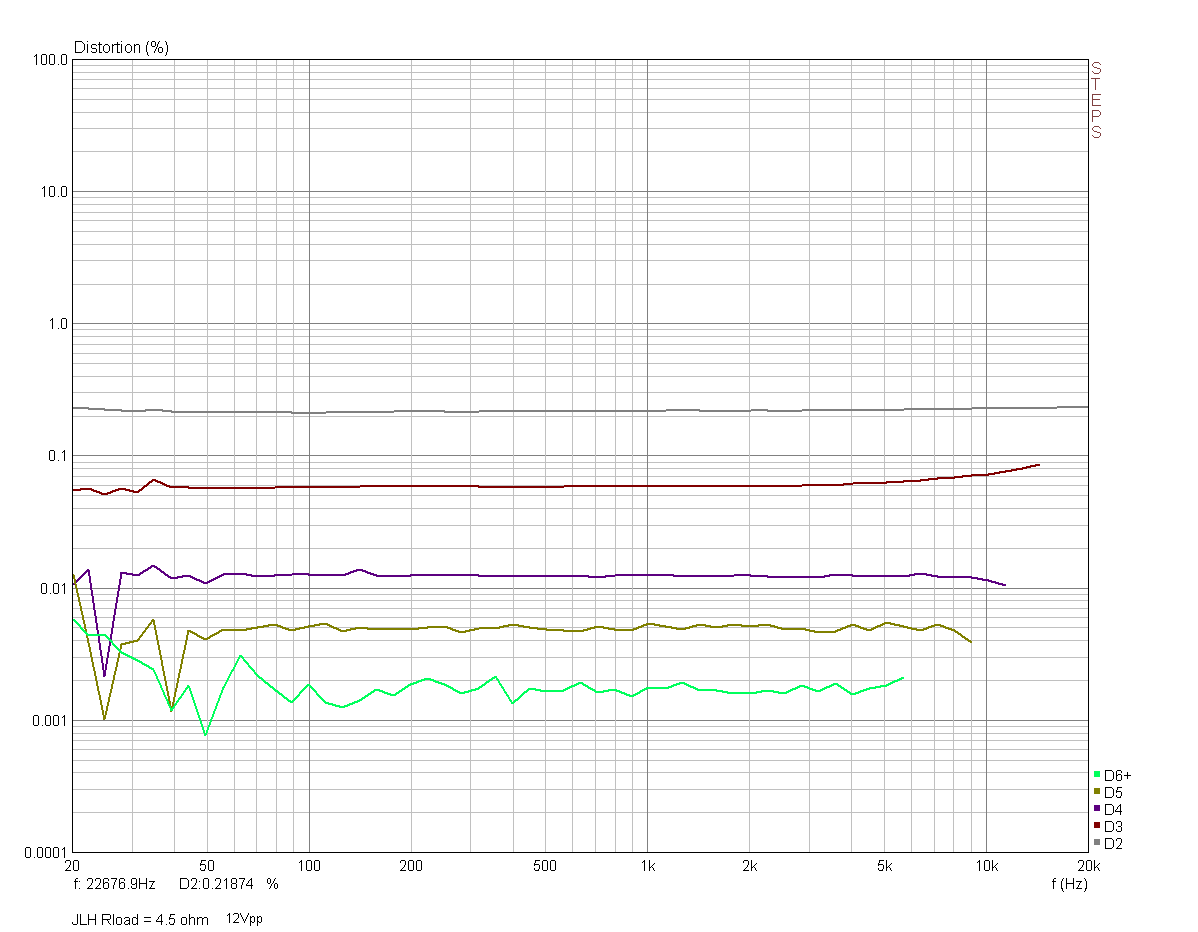

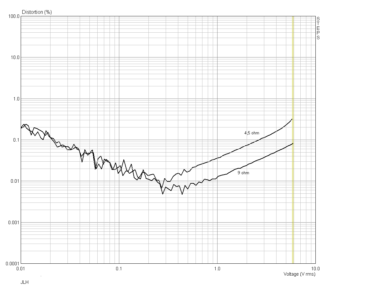

Several measurements for a version with power supply voltage +27V, one toroidal center tapped transformer 300VA, two separated bridge rectifiers and filters, one per each channel. Capacitor bank 20400 uF per channel (3 x 6800uF). Common ground for two channels. Idle current 1A per channel.
As one can see, THD depends on voltage (amplitude), but is almost independent on frequency. This is IMO very important. The circuit has OLG about 54 dB with frequency corner above 100kHz. This explains why THD does not depend on frequency in audio range.
After years, it is still very competitive design, in case its limited power is sufficient for the user. As long as JLH plays within its power limits, it sounds very good and will surpass most of contemporary class AB amplifiers.

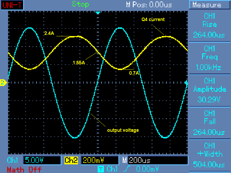

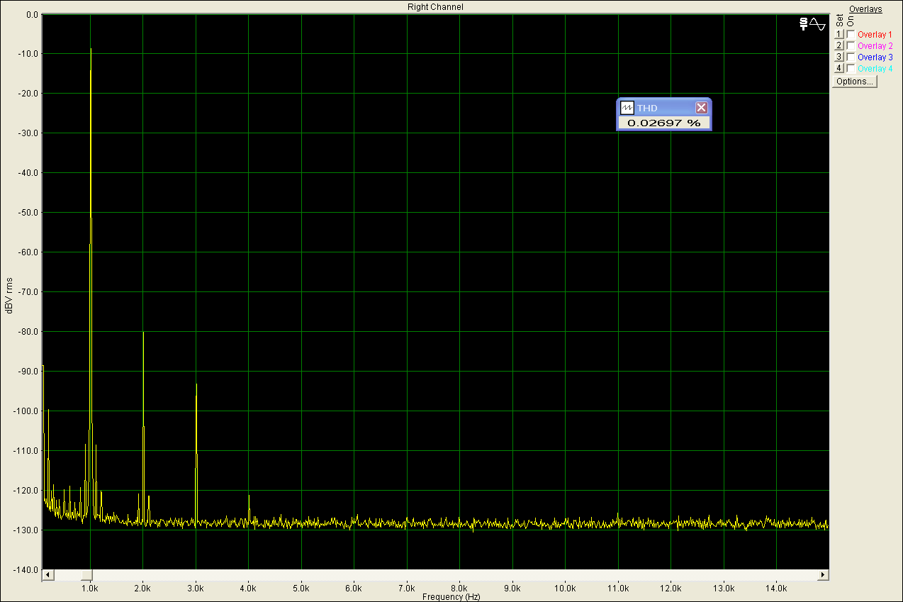

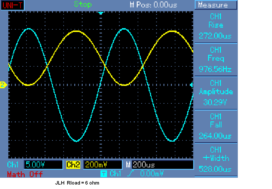

The distortion falls with higher supply voltage. This is for +42V, output swing 16Vpp and 8 ohm load. Just 2nd and 3rd ...
The maximum output voltage swing is about 34Vpp with this power supply. Idle current is 1.5A.

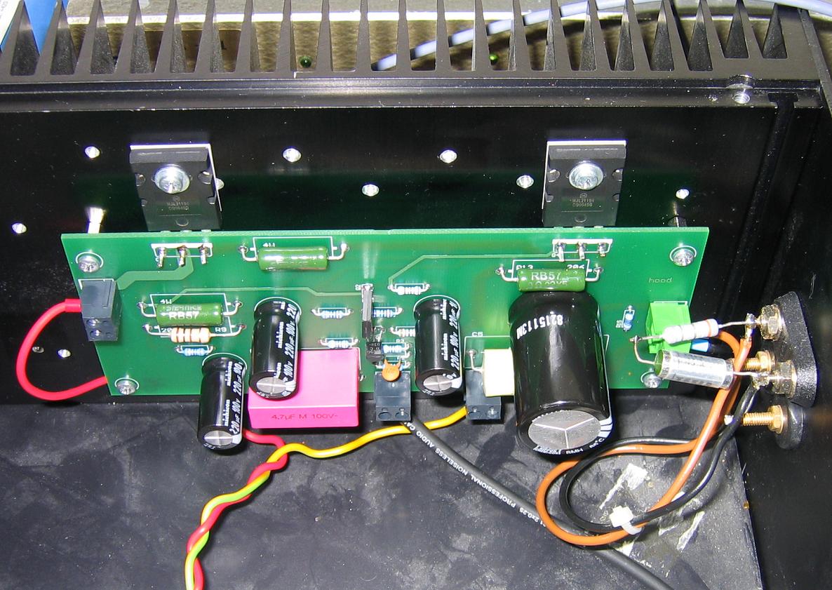

Evening gents,
I've received the PCBs, following advice on here and elsewhere I went for a blank PCB so that I can buy my own genuine parts here in the UK or from reputable sellers like OnSemi.
The only snag is that I don't have a parts list or schematic, so I don't yet know what I am building or what's in it. The PCB is 2-sided, I bought his one.
2pcs JLH 1969 class A amplifier amp stereo high quality bare PCB 10W DIY audio | eBay
It looks to be good quality, I am told that it's the original cicuit, based on TO3 package 2N 3055s with a 3rd one each side that seems to be set up as a voltage regulator. Has anyone used these boards and do they have a schematic? If you have a parts list, better again.
for the list part, all references are printed on the pcb
for the diagram, you will find it on another kit with reguled psu on the net.
they are all the same.
for the setting, it's like the others, a pot for setting the middle point of the psu voltage and the other for the quiescent current
