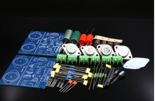

I think there will be problems finding much documentation for PCBs since in China, they don't usually come with lists or schematics that relate to the particular design because all the essential info is printed on it anyway. Considering how few parts there are, how difficult is it to read off the values printed on the PCB and multiply by 2 for a parts list? That's what those guys will be doing if not just buying the kit of parts.
If you want to check the suggested parts types or typical substitutes that will have been discussed here over and over, you have but to read up a few builds in this thread, check the seller's pics of assembled kits on their websites etc. I don't think I have seen these particular boards before but there are quite a few that are similar in having a separate power supply or capacitance multiplier/filter circuit for each amplifier on the same board. I attach a pic below of simpler boards for checking out suitable general parts types.
This item looks close to your boards and is completed, maybe serving as a visual guide :Assembeld Hood 1969 PNP Mj2955 Class a Power Amp Board 2 CH Amplifier | eBay The attached pic only shows parts for the amplifier but you can surely identify the few extra parts used in the regulator sections. Good Transistors to start with would be 6 * MJ15003 (yes, not cheap if genuine), 2 * 2N3906, 2 * BD139-16, taking care to get the pins correct for the smaller transistors as these may be arranged differently. There are an additional 2 * TO92 style transistors near the large smoothing caps, that are probably also identified on the board.
this jlh amp kit is a PNP and i do not know if stevec67 is able to tell the difference between a pnp jlh and npn.@ stevec67 ...
I risk having trouble explaining him in English, could you please?

Yes, If stevec67 tried to read part numbers and polarities from my linked Ebay pic, I can see how that would be confusing.this jlh amp kit is a PNP and i do not know if stevec67 is able to tell the difference between a pnp jlh and npn.
An explanation of PNP v NPN type transistor differences probably isn't necessary but I guess there are several possible reasons why anyone would choose to reverse them from JLH's design. It could be for cost advantage, but I think it would be novelty and an anticipated difference in sound quality that could make such a variation worth selling.
I'll just detail what would need to change if transistor "gender" is reversed. I am not suggesting that stevec do this:
First, TR4 is changed to 2N3904, TR3 to BD140-16 and TR1,2 become MJ15004, MJ2955 or even TIP2955. You can spot such changes quite easily on kits. The opposite gender types chosen here are called complements of those used in the original circuit because they are close to being their electrical mirror twins but fitted just the same, as NPN for PNP or PNP for NPN type.
The regulated DC power supply must also be reversed in polarity by using similar, opposite gender transistors. Then all the polarized components such as the electrolytic capacitors and diodes, zeners, rectifier diodes or bridges must have their +/- terminals reversed too, the caps simply by rotating them 180° in the vertical axis (i.e. normal to the PCB surface). The bridge rectifier connections would require more thought. This is how designs were in the days of germanium transistors, when it was the NPN type that was difficult to make.
I think the PCB could really be the same for either version and still be used as an assembly guide, noting the polarity differences. The only really necessary guide is the PCB itself and the ability to convert the strange markings on the PCB to everyday parts specifications.
Unfortunately, some Chinese boards mix the marking code standards and use whatever suits the space available. There you'll need to apply common sense, read the resistor value with the aid of a colour band chart, look at the schematic and work a few examples through to become proficient. Of course, check any resistor colour bands you first read and calculate, by measurement with a DMM.
