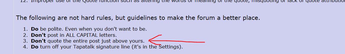

huggygood, please read the rules regarding use of quotes and in particular quoting the entire post you are replying to, particularly when it is just above.
Thanks.
