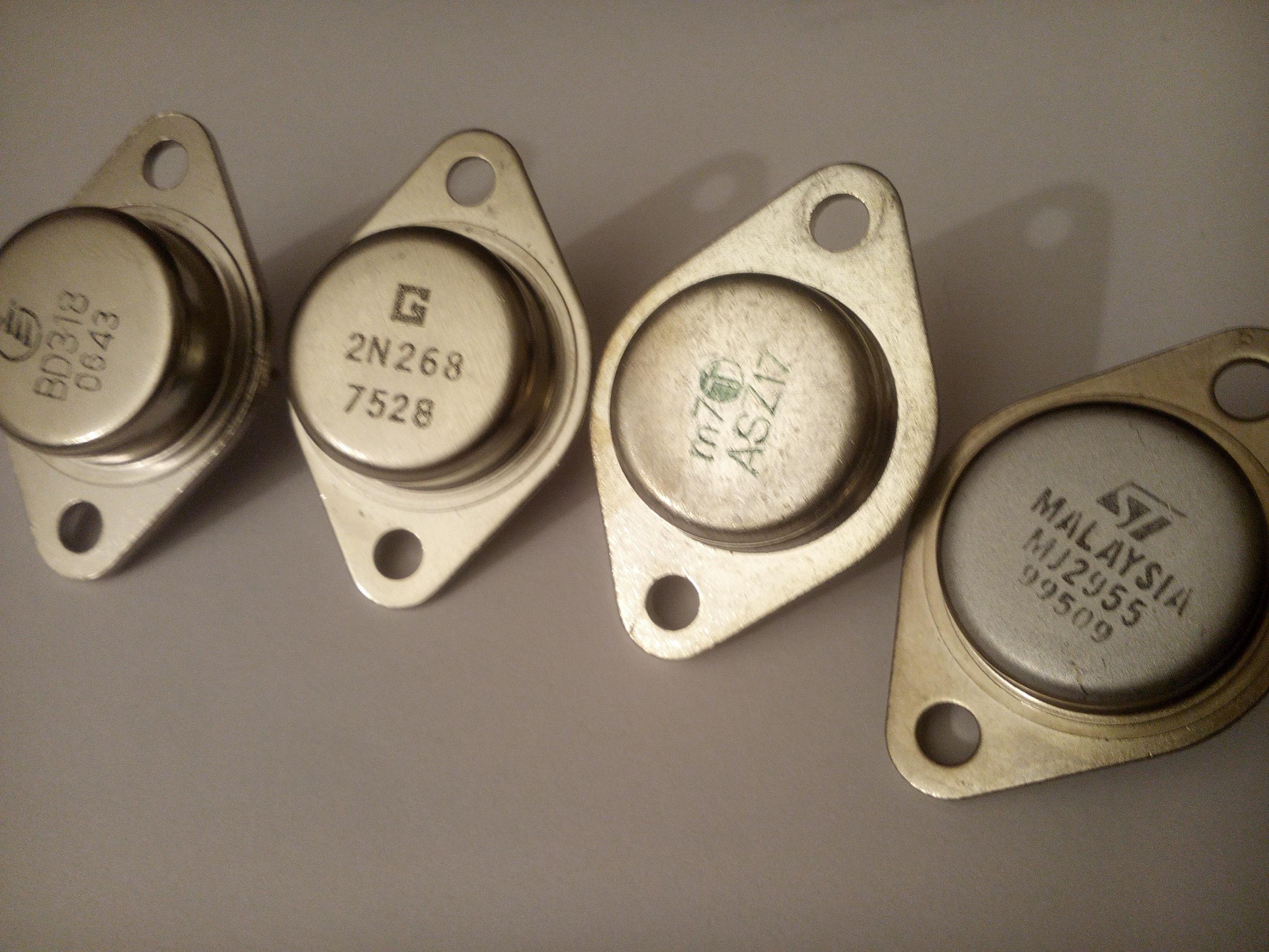

Picture: What we are talking about.
The MJ2955! sound a little little bit lazy and stately/solemn, more slowly, compared with BD318 and ASZ17. Fine, great stage, minimal more flat, but there is a twisted "krzlzz" in the sound, finer quieter than the "KRZZ" of the ASZ17;-)-; A little bit more strenuous. Not as contoured and focussed as the both mentioned. The "bass" a little bit bloated, with echo.

TO-3-pause;-)
The MJ2955 is not pleasant;-!!!

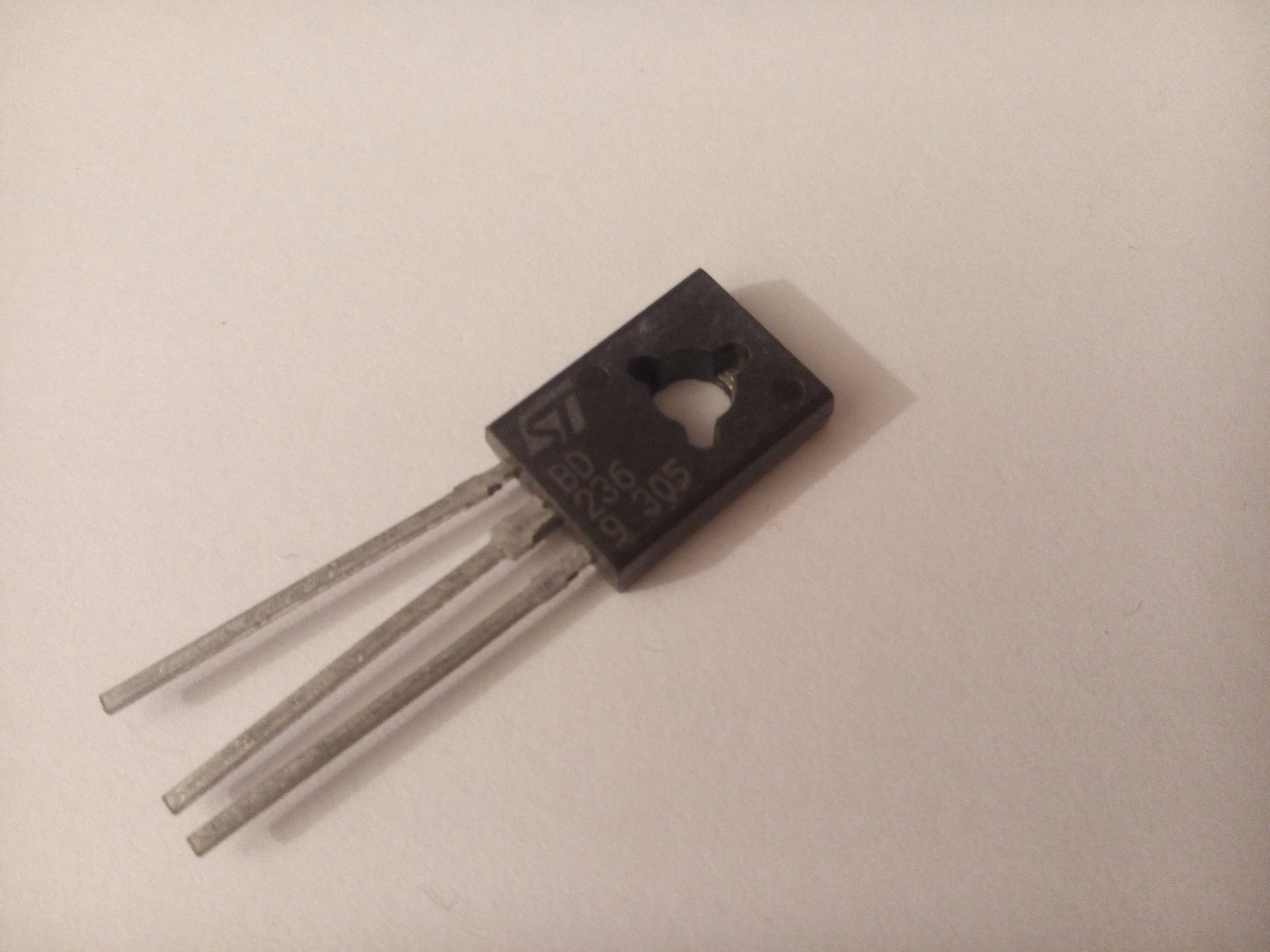

To compare. With BD236;-))))))))))))
THAT is sound;-) 3D endless! flow, solution, "bass"-power: on point, not background or the contoures leaving. Much more "right"-)
Breath, air, DELIGHT;-!!!
My suggesstion, again and again: case as small as possible: definition of current. Per less diameter, form and less material: "sound". The most TO-3 are made of questionable materials.
fT is not necessary for sound. May be, the less MHz, the better;-?!?! All other parameters "for the cat"-)
Sound is not a resultat of the common specifications.

I would speculate that you are not listening to the BD236 at all. What you are listening to is how easy it is to drive. As BD236 mostly is a nothing special device, it's higher gain might be what you like. When a valve like 2A3 or even EL34 one can say it has a sound. A transistor of 3 MHz ft with a typical gain of 100 has no real sound in a high feedback design like this. However like the ideal chain-cog on a bicycle it can be the right thing you need. If you sincerely hear the BD236 as good I suspect TIP36 would be very similar. If you play with the gain of the amplifier you should notice a larger change in sound. Higher gain although more distorted can sound more open. If inside sensible limits I would not say it's a like for distortion. Play with it and see what you get. Very often 400 mV is a good sensetivity.
