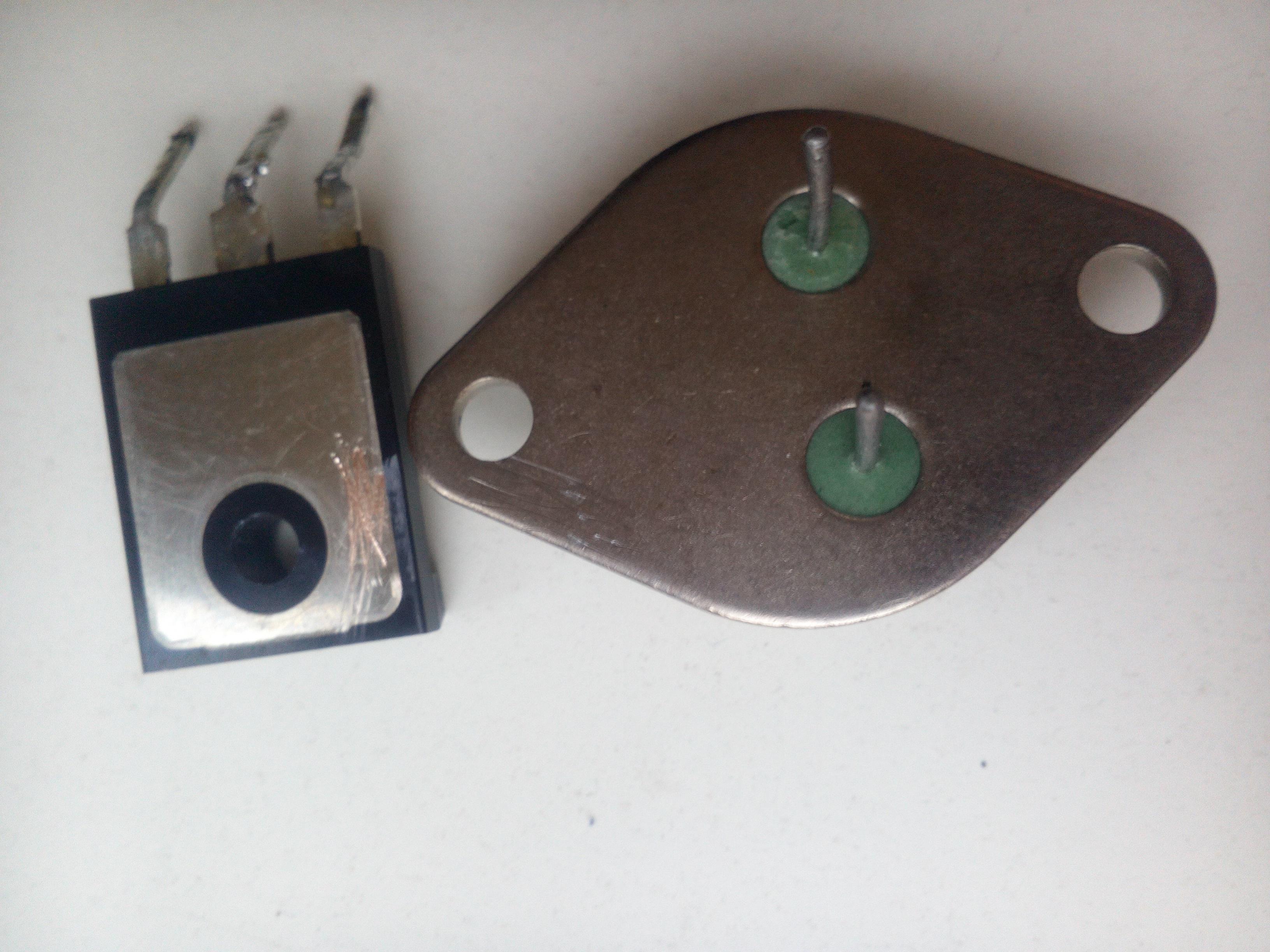

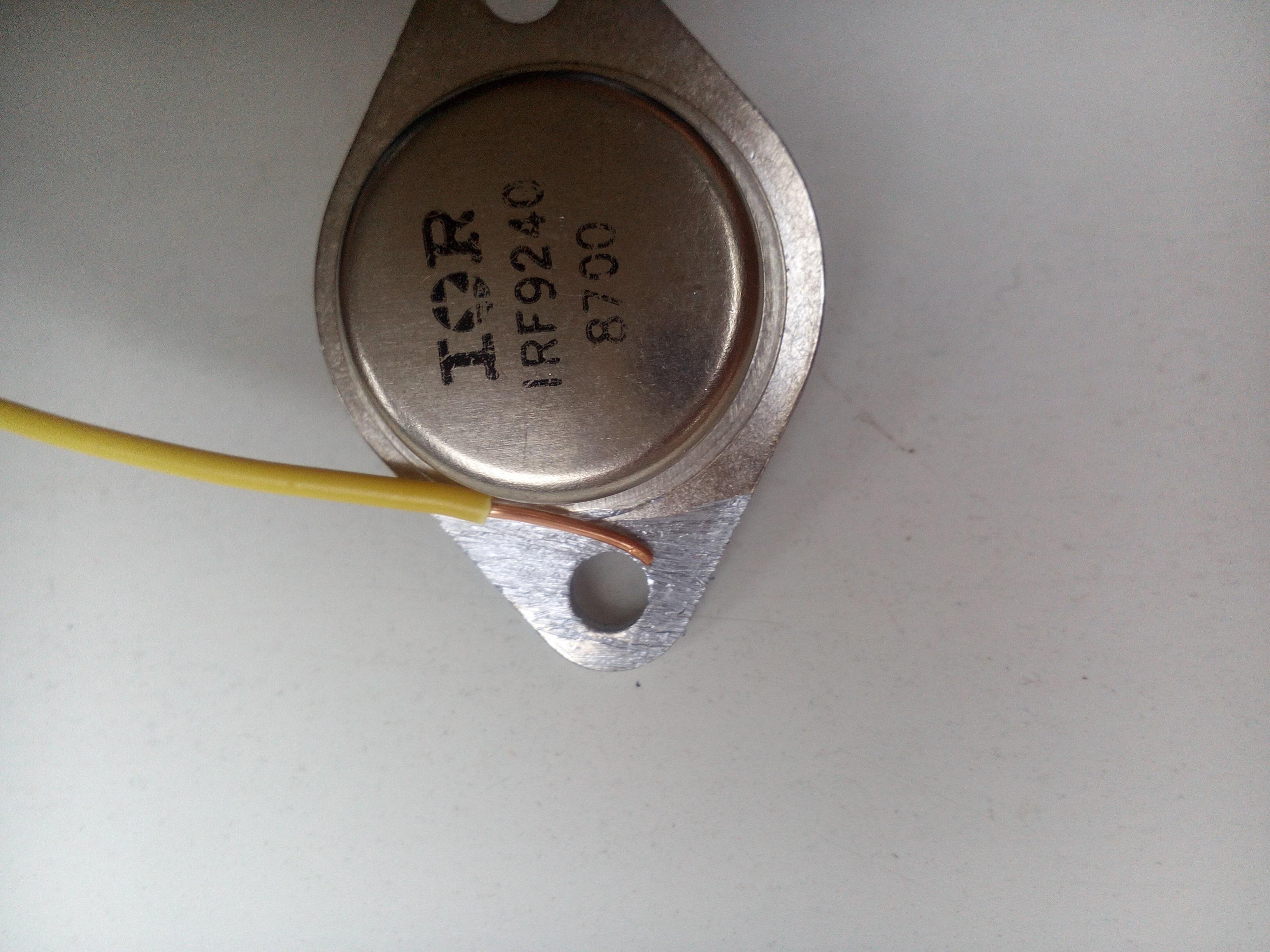

I did build in the TO-3 without any rack. Cutted the contact and set the wire. NEVER use screws and discs for circuit, for current.
Quasi the same parameters, IRF9240 and IRFP9240, but a big audible difference.-)
We talking about materials and diameters, regarding circuit and current, now;-!!!
More flat and more sluggish. Minimal overcast and indistinct. The depths a half tone behind. The highs smore sibilant. Less 3-D, less contours. More dreamy. Something like this.
The generally TO-3 character - compared with more little casings;-!!! (Again and again and again the same experience;-)
