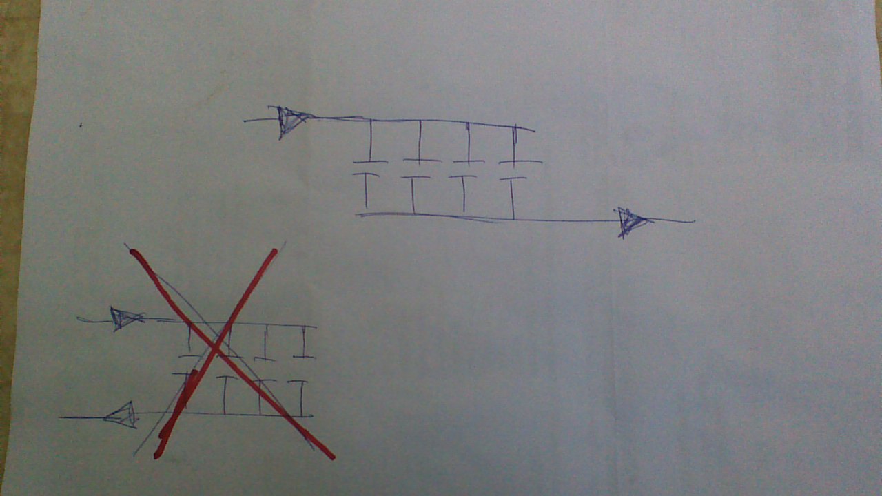

To remember one of the finest circuits:
(but this is more a clh than a jlh,-)
Great amps!
I suggest to build the origin: One (+) psu for all, not the Two (+ and -) psu-version. To get out the signal use 4 x 470 uF or so. Connected as shown (coupling caps in general). NOT 4,7 mF and 10 uF or so. Everytime the same values, same types.
My suggests,-!

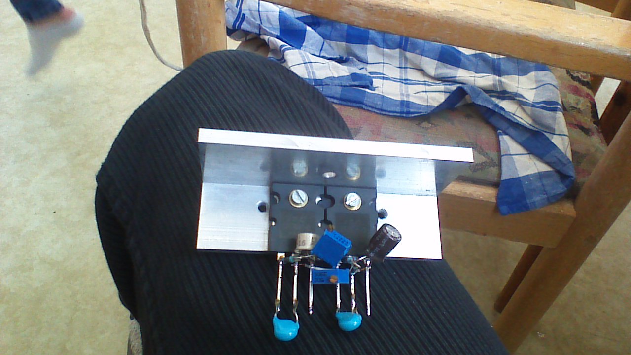

I would aim for transitors to be mounted side by side rather than one above the other, if at all possible.... saves baking the top transistor with the heat from the bottom one!
Also somewhat surprisingly black heatsink will dissipate heat MUCH MORE efficiently than silver.
If heat sink is very deep (say copper block with heat pipes, fins and a fan) close mounting is not an issue if sink doesn't even get warm. Same with water cooling block. Inside computers and laptops, tight spacing is the norm. I may try forced convection CPU coolers on the OPS of my next class A project. Much less expensive than massive aluminum heat sink.
Such a thing, some little and very quiet - you do not hear - fans, and you blow xxxx watt dissipation away. You will have radiators cool as the room. Not more. A dream, a dream, a dream,-)
But not necessary for a LITTLE JLH,-)

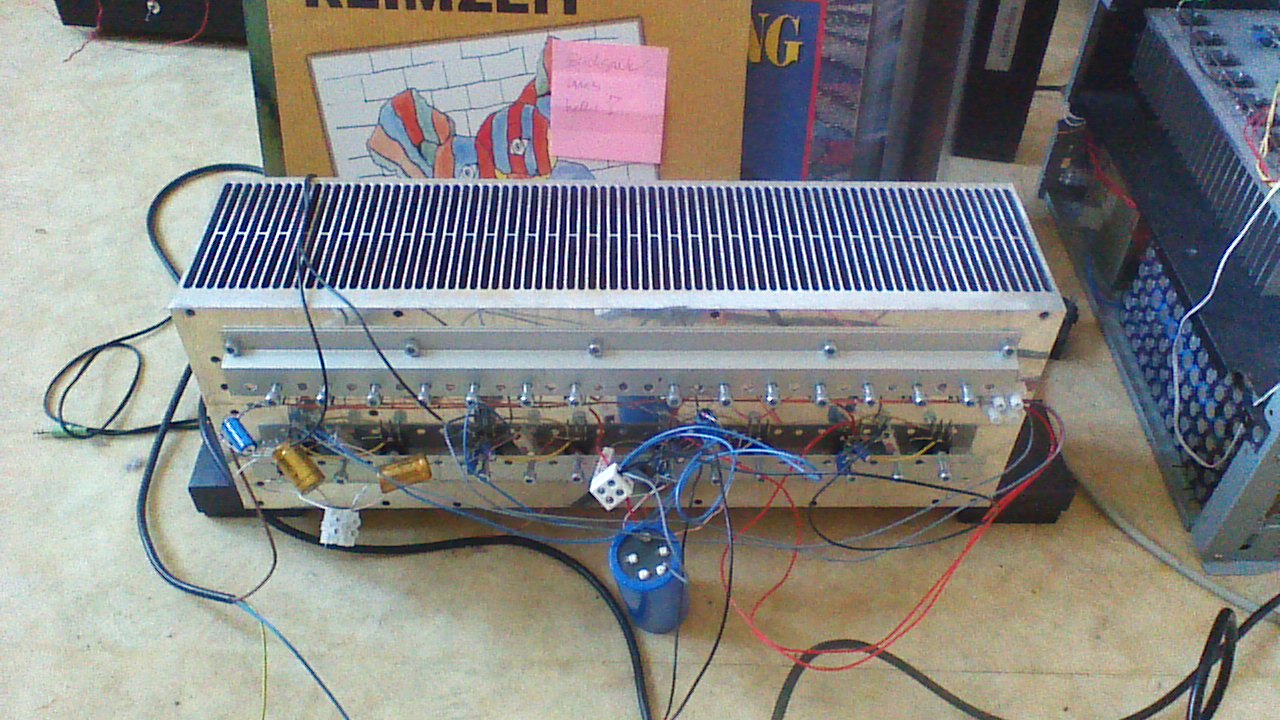

So where you at with it Tom ?
I had a Spice file of the JLH (one I made earlier as you do🙂) so I just tried your supply (no problem) but was rather surprised that the transistor types (models) made such a difference to the AC gain.
The files are here if anyone wants a play.
Tom... if you are still having problems then measure and record the voltages at each transistor for E,C and B and post the results. Also check by measurement that all the resistors are what they are supposed to be.
As Nico says, the JLH works pretty much out of the bag so something basic is amiss somewhere.
