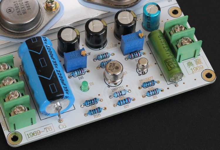

HELLO everyone;
I do not have electronic knowledge only know how to solder 🙂
I bought JHL kit here below on aliexpress;
http://www.ebay.co.uk/itm/1pc-JLH-1969-Assembled-class-A-amplifier-Board-high-quality-PCB-MOT-2N3055-/121808157174?hash=item1c5c54f9f6:g:4xwAAOSw7hRWPGLS
It uses 2N3055 + 2N1711 + 2N2907 (I dont know which version it is but i want to use same pcb and upgrade it as described here below😉
The Class-A Amplifier Site - JLH Class-A Update
i can buy the componenets but what modifications i need to make on pcb itself?
Thanks....

You will need to reverse engineer the PCB to generate the schematic that has been used.
Then you get a chance to see if the PCB is suitable for your new project.

Hi Potstip,
If you don't know electronics at all I seriously suggest that you enjoy the JLH 1969 board just as you bought it.
The architecture of the updated circuit is fundamentally different.
Personally, I would prefer to build the updated circuit by hand from scratch rather than trying to adapt the 1969 board.
If you really want the updated version, I suggest you search for a board designed especially for this.
Also adjusting the DC offset for the newer version takes care & time and if you get it wrong you could blow up your speakers.
Sorry to appear unsupportive but I honestly think you should build the power supply for the one you have and see how good it sounds.

Thanks Mike,
then i will build it as it be. but i will buy new components probably the parts came with could be fake 🙂
http://eu.mouser.com/_/?Keyword=2N3055&FS=True
can i use Transition Frequency ft 6MHz (2N3055AG) İNSTEAD OF 2.5Mhz? Is it matter?
Thanks in advance.....

I cannot say for sure, but the circuit could oscillate if you upgrade the transistors.
The thing is this: Creating a "finished" design can take weeks or months of fiddling around to get everything working properly. When you buy a finished kit, someone has done all of that work for you. If I were you I would take advantage of that so you can get to enjoying the music as soon as possible.
Then, if you feel like being more adventurous later you can try to build the newer version but at least you will have a working amp quite soon.
If however you don't trust the people who sold you these boards then best not to buy from them.

I have had pretty good luck with several kits I have bought from Aliexpress. Build it as is with parts supplied and it should be ok. The vendors on Aliexpress don't want a black eye rating so will try to sell you a product that will actually work. The output BJTs may not be name brand but will probably work and are different than fakes where they take a puny BJT and encase it in a big BJT. Those blow up immediately. That board looks pretty nice actually so you should build it and enjoy the original sound of the 1969 variant.
Always use a mains bulb tester for initial power on test and adjusting. Or use 10ohm 10w safety resistor in power rails.

Hi Potstip,
The 1969 version sound very good to my ears. The other version with the +Ve/-Ve also sound great and you could simply buy the free PCB at Siliconray.com which is a vendor on this forum. Try to buy 2-3MHz ft output transistors to avoid possible oscillation.

That looks like a very good quality kit/build and there is nothing wrong with the JLH'69 amplifier. As others have suggested, yes - finish this version and test it carefully, then enjoy. The sound quality will be fine as I doubt there are fakes there that are a problem - from the appearance of your pic. at least.
