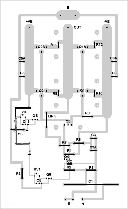

JLH 10 Watt class A amplifier
Colin,
This is my first attemp and could be wrong.
Hi, if anyone see anything wrong please correct me .
The new parts VR2, Q7, Q8 and R12 is from the updated JLH for ESL.
Parts removed from the original ESL pcb overlay are R5, C4, C4a, RV2.
See attached
Chris
Star earth
Chris,
In my opinion you should try splitting and creating several ground points, connecting them all to another single point working as your amp star ground.
To start with, the speaker's (-) point should be connected to the star ground. The input and the grounds bypassing V+ and V- should also go to that point.
Maybe other experts here have a different opinion.
Carlos
JLH PCB
Hi Chris
Thankyou for sending me the updated of the PCB I had a go and nearly got I right .In fact I congratulate may self as my furst attempt at drawing out a PCB. I have built some Kits before but PCBs and parts have been supplied This is my Furst Go at building from the ground up
So thanks again
Colin
:D :cool:

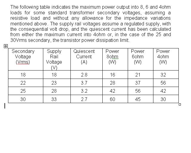

JHL 15 watt Preset Help
JLH Class A 15 Watt Amp Preset Help Post #1
Hi Guys
I am just getting the parts together for the 15 watt JLH As in Fig 2 on Geoff Moss’s Site
My nologe of electronics is not as good as I would like but can build this amp My question is about the Pre sets R1 & R2 as to the position they should be set at be four switching the amp on I am told that R1 should be set in the 12 o’clock potion And R2 set fully ante clockwise before setting up to required Iq
I will be using a 18-0 -18 volt 300 VA transformer mj15003 Trans
1.1 CW Heat sinks as these are the largest that I have
Amp will be running into 6 ohms at about 2.8 Iq
Can you let me now if this is ok?
Regards
Colin
http://www.gmweb.btinternet.co.uk/jlhupdate.htm
__________________
CH
Hi Colin,
The fig2 diagram is used in with an Iq of 2A.
The fig3 diagram however must be used in the case you need the Iq of 2.8.
in the Fig 2 version there is about 44w dissipated in each output device. a 1.1K/W heatsink is not sufficient.
in the Fig 3 version with an Iq of 2.8 the dissipation is 25W per device each device its own heatsink should be ok.
One 300VA transformer is on the edge for two channels...
One channel uses roughly 100W for the amp and some in the powersupply.
I've build a dual mono version of the 1996 version and used
2 225VA transformers.
Regarding the position of R1 and R2 I cannot help you.
I'm about to start a new project and go for the fig3 40W into 8Ohm version .
plan is to use a 300VA transformer for each channel.
