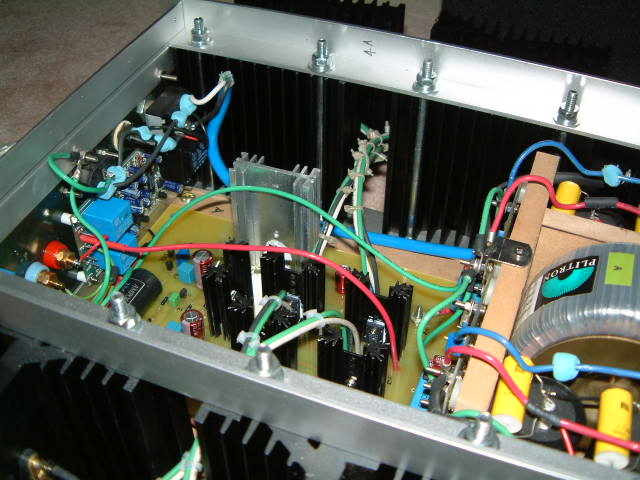

In my particular case if you look at Fig.1 JLH Class A for ESL57 in Geoff Moss's site you will see the feedback pick off point is connected between C4 and R7. That was before. Now I disconnect R7 from C4 and connect R7 very close to OUT.
In general when using feedback, it should follow this method to get the best location where to get feedback signals from IMHO.

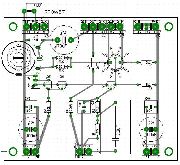

Feedback point
How do you do to go from the first 3rd of the board, where R7 is, to the third 3rd of the board where OUT is?
The reference I'm using for this question is fig 5 on:
http://www.gmweb.btinternet.co.uk/jlhesl.htm
Carlos

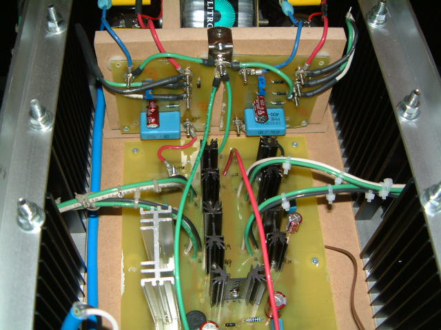

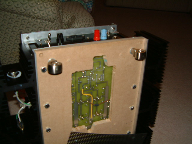

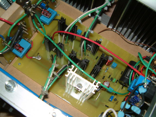

Hi Carlos,
I removed the link between R9 and R7. Use a short length of hook up wire, solder one end onto the track close to the OUT. Press and bend the hook up wire and keep it as close to the board as possible and retrace the wire along the PCB track back to the track where LINK used to be and solder it onto the track thus connect the wire to R7. I did that in five minutes for both channels.

No no, C4 stay as is, sorry that I confused you, told you my english is bad😀
Let's use only Fig.5 as our reference ok, remove the LINK between R9 and R7, use a hook up wire to connect OUT and R7 by the C4 side( left side of R7nin Fig5). Thats all.
Reading back on what I posted for Argo I did make a mistake saying disconnect R7 from C4, no that is a mistake I meant C4 and R9 in Fig.1 and then jump over and bypass R9 and R11, reconnect it between R11 and OUT.

Here is my layout I am currently using if anybody is interested. Still can’t post any picture - no digital camera yet. Its on 8 x 10 cm Veroboard using component leads and solid 1mm tinned copper wire. Output transistors are connected with short 1mm solid wires as well. Signal ground (GND) is separated from power grounds (PE and PE’).

There is an ERROR in the layout picture. Q6 emitter and collector shouldn’t be connected of course.

Thanks for the info Eric, love to learn more, wouldn't it be nicer for all newbies with a new thread regarding NFB take off point? be it point to point or pcbs.
BTW folks, I've forgotten to mention that I did try my best to ensure the hook up wire (length and size) and the exact points of soldering on the pcb track are identical on both channels.
