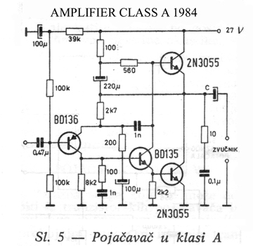

Class A
There...something that i get to work...schematic form yugoslavijan magazine "radio amater" from 1984.
