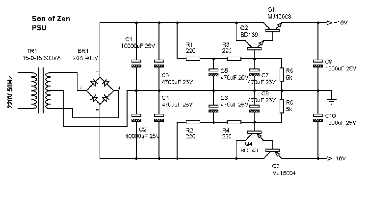

CAPmult
hi,
i build my capmult as in picture but with 4x10000 BC , 4x2000 in middle, and 2x10000+2x6,8+2x200nf in output.
i hav tested the against two psu of 600000! uf.
Result with capmult no hum hearable on speaker, but hearable with 600000uF!
As Tim recommends to use higher grade capacitors i will try in future.
Has anyone ideas how to better the capmult (perhaps more capacitance?.....
Greets,
Ralf

HI Erik
Yes I have study it for a little bit, but I would like to use two bridge rectifiers per transformer per channel. Will there be any different in wiring the pass transistors if I follow the similar way of the LM338K supply schematic on Geoff's site but doing the cap multiplier?
Ralf,
May be we can build a better bridge recitifier with all those soft recovery diode ideas discussed in the forum.
Chris

Chris,
JLH class A with LC filter sounds wonderful. Easily outperforms cap.multy. in many respects.
