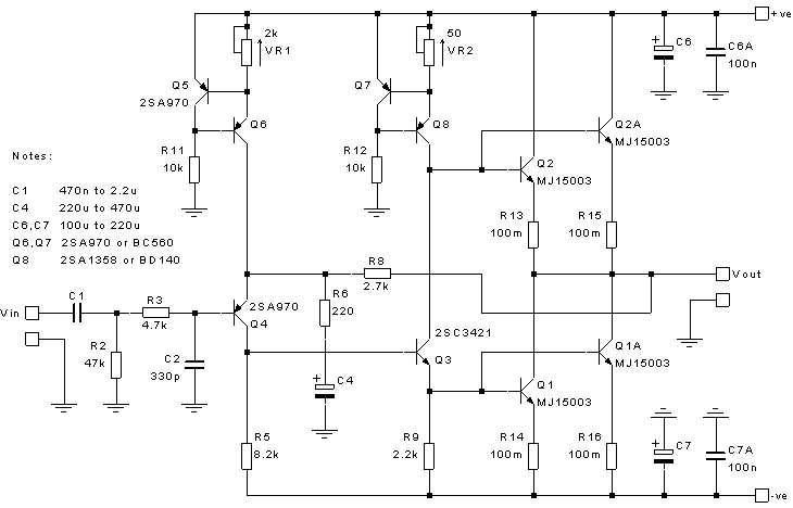

BD139 replace with 2SC5200
Has any one see any problem for me to try the replacement Q4 for the high power updated version? It simulate ok with 20V supply rail and all output transistors the same 2SC5200 and Iq set at 4A. But I think in reality the rail will be a few volt higher if I use the CLC, or cap multiplier supply with the 300VA 22-0-22 transformer. If I remember correctly the voltage after the bridge rectifier with this transformer in my current JLH is around 28V before the LM388K circuit.
If the 2SC5200 is fine to replace BD139 then I will use five of them per channel.
Chris
Chris

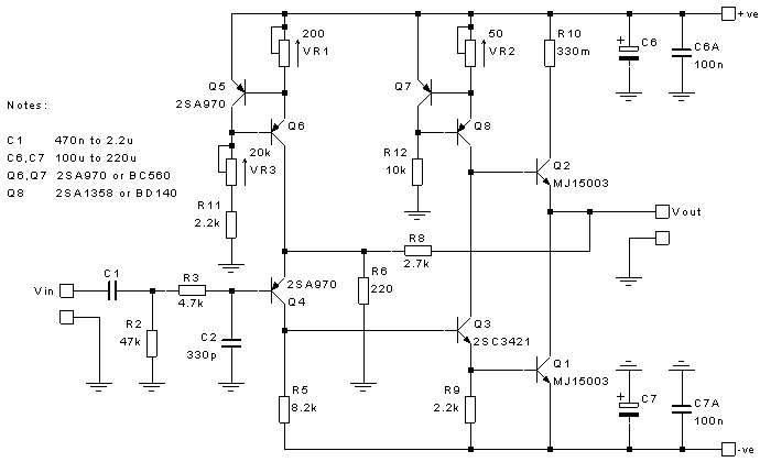

Feedback Capacitor R8 (2k7)
what does it matter to use 2k2 instead of 2k7?
(my Caddock -seller has only 2k2)
thanks,
Ralf
thanks,
Ralf

Re: Feedback Capacitor R8 (2k7)
The DC offset will increase a little, the amount of feedback is reduced.. you can try and listen for the difference between the two values with the normal brand resistors first and if you like the 2k2 sound then get the caddock ones, but make sure you reset the DC offset first after each replacement.
Chris
Sorry, shouldn't I say the amount of feeback is increased instead cos the values go from 2.7k lower to 2.2k so it allow higher feedback
ralf said:Hi,
thanks,
Ralf
Chris

amount of feedback
has someone tested the sound influence by changing the amount of feedback?
How does it sound with zero feedback?
greets,
Ralf
greets,
Ralf
Hi TimA.
Maybe the problem is not the 2sa970 but more 2SC3421...
The miller capacitance cc is 15pF for 2sc3421 and 25pF for 2n1711.
try add a 10 - 22pF across basis and collector of 2sc3421 and use the 2sa970 again. Then i think the problem will disappear.
Even better use 100pF instead and the choice output transistors that will not oscillate is a lot more.
Only a few thoughts from sonnya
Re: amount of feedback
Ralf,
I do not think the JLH class A will work with zero feedback. I think it is one of those kind of design needs the feedback network in order for the amp to work.
As of trying different values and listen for it I have not yet.
But the value of this resistor is rather critical not only to the sound effects upon the amp but it is upmost critical to the stability of it, be careful, (IMHO) I am sure that zero value will destroy speakers...(experienced diyer please comment here)
Chris
ralf said:Hi,
greets,
Ralf
Ralf,
Chris

JLH 'update' schematics
There are many references to Geoff's Class A amplifier site on this thread. Very unfortunately, current circumstances have meant that Geoff has had to close his superb site, at least for the time being. As recent references and discussion here have been with regard to the updated JLH circuit and the updated JLH for ESL circuit, I have attached them both here for future reference, or until Geoff's site is reopened.
Tim.
Tim.
Geoff's JLH amp site
As my current project is the 2003 JLH -ESL- version, one design change is not noted in the diagrams of TimA.
I've incorporated this change into this diagram:
Its the C5 which is connected to a split R11/R10 . It is there to reduce
hum from unregulated power supplies , but I do use it in a project with a regulated ps: it makes good sense.
