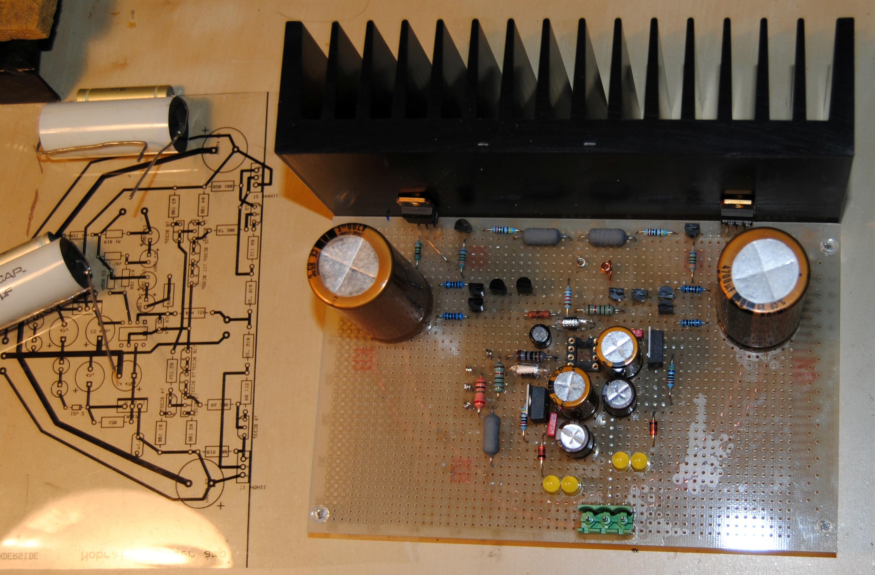

Finally... everything in place.... now the odd part... drill the heatsink.

You should use a dummy load, say 4 to 8 Ohm and put a squarewave in ( 1kHz, 10kHz ) and watch on the scope if there is any overshot. You can then try to put 1uF in parallel.
The square then has ringing but still the amp should not oscillate.
The miller cap in this amp is quite high so the square should be stable.
You can also check the idle.
How can I check the idle ? On the dummy load ?
already heard it's sound in my bench setup..... quite good.... Only one small issue, The heat sinks are not grounded and when I touch them with my hand, sound volume diminishes sensibly... what does this mean ?
Idle settles at 12mA after 5 min (It goes down when heat goes up) must stabilize when properly enclosed.
The output transistors are isolated..... heatsink is not connected to anything. Anyway, today this dimming effect is not aparent..... maybe it was due to the presence of dmm probes.
