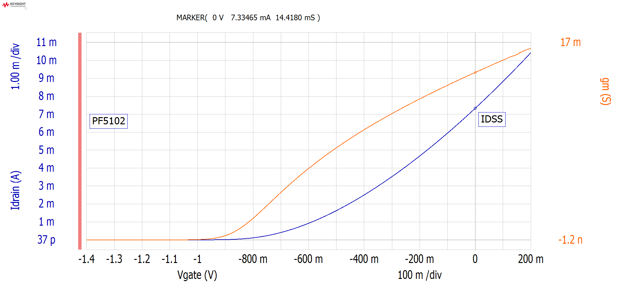

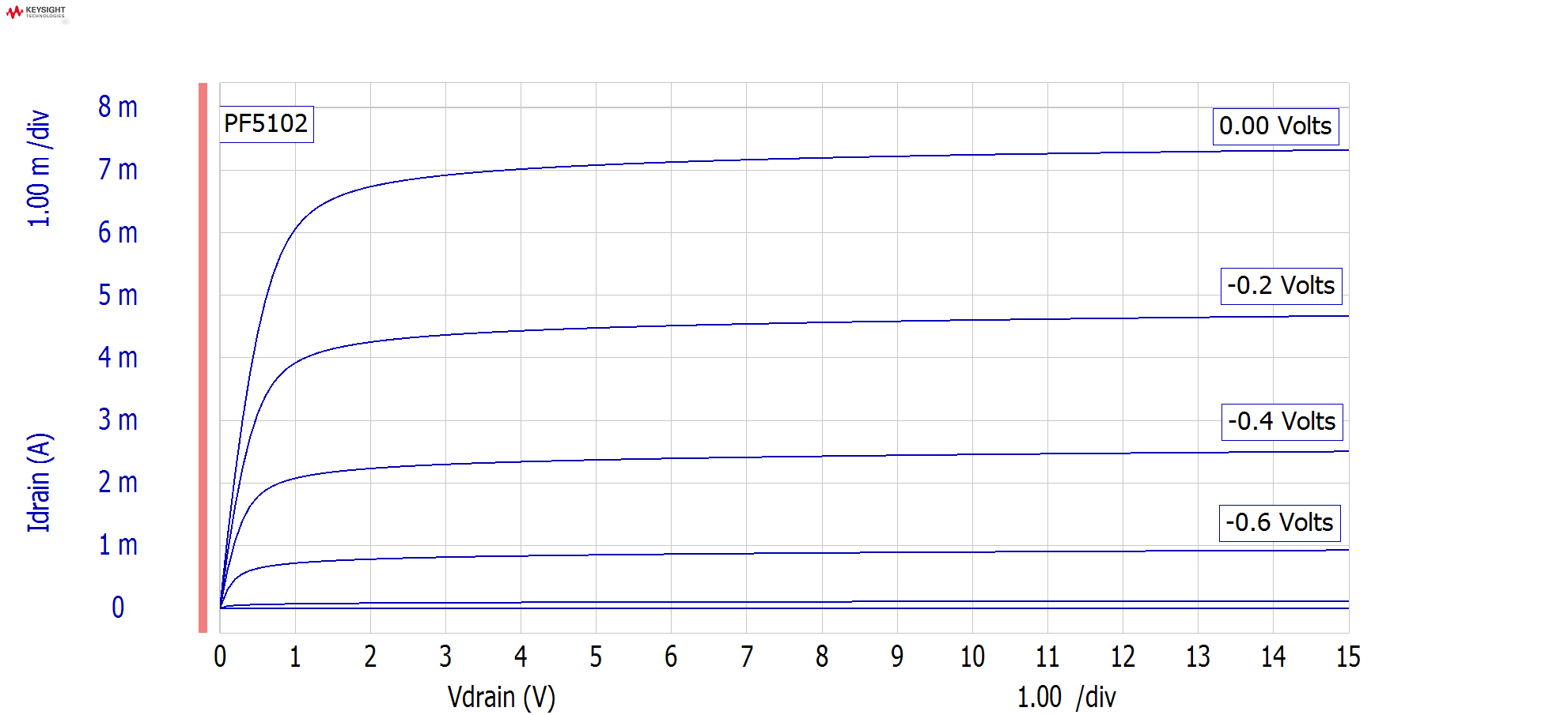

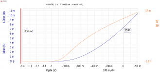

Hello All,
PF5102
I bought 2500 for a dime each. I tested a random sample; the first ten that fell out of the bag. It looks like the distribution of values does not spread all that wide. Finding matching pairs does not look too difficult.
Or as Papa does, using a source resistor will match lots of JFET’s
See the attached typical plots.
IDSS mA gm mS
10.145 15.75
7.6147 14.32
11.290 15.72
5.4625 12.99
7.2822 14.20
8.2458 14.79
10.352 15.25
10.010 15.23
6.9013 13.90
6.1535 13.55
J113
A similar stash of J113’s had an average IDSS only a couple mA higher.
Thanks DT
