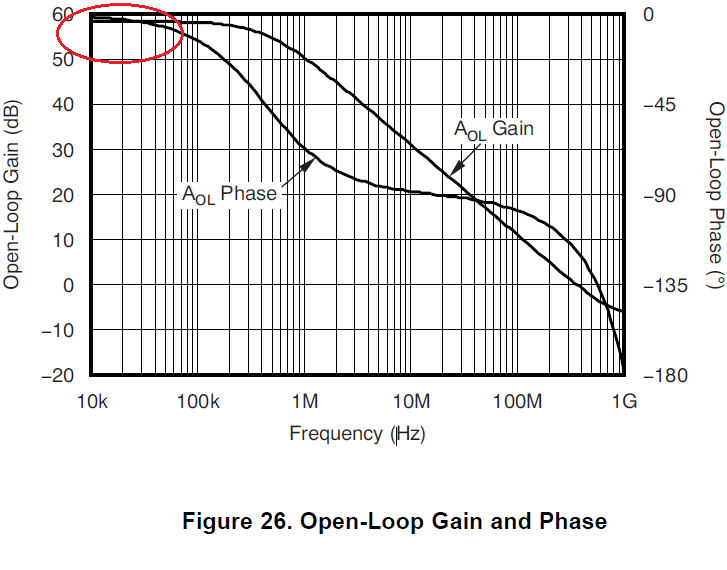

He said,
In the listening, Important thing is "audible or not audible" for us.
The noise masks very small signals, but other nonlinear factars also masks very small signals.
"the input signal are not correctly calculated due to the phase delay" means **dynamically generated noise like signal for us** may masks very small signals.
But it is difficult to measure by sine wave.
Then you have to evaluate your own ears.
For example, "My favareite" OPA659 (GBW 650MHz, SR 2550 V/μs, ±6V max) has excelent spatial ambience (depth feeling, hall ambience, breathing, etc).
In other words, it makes very small signals still audible.
They has flat open loop phase responses in audible frequency.

He said,
I think,NFB theoretically knows that if there is no time delay, there is no negative effect of NFB, but the problem is how much phase delay (time delay) is at which frequency. In Sansui, the frequency characteristics before applying NFB (open loop characteristics: or naked characteristics) are set to at least the audible band, and NFB is designed to be applied over a wide range without time delay.
At higher frequencies, NFB's adverse effects were minimized by the 2-pole phase compensation theory technique that reduces the amount of NFB by reducing the phase delay as much as possible.
The negative effects of NFB are the phenomenon that the feedback signal and the input signal are not correctly calculated due to the phase delay and cannot be detected by the continuous signal, but the so-called transient characteristic deteriorates. In the 1970s, Matti Otara predicted that I think that the thing called (transient intermodulation) also refers to this.
In this way, I think that the Sansui amplifier has mastered the NFB.
Therefore, even if the distortion rate is measured with a continuous signal and the same measurement result is shown, there is no doubt that this is the reason that there are amplifiers with different sound quality. How to hang NFB is important.
In the JFET, I like 2SK168.
It also has nice spatial ambience.

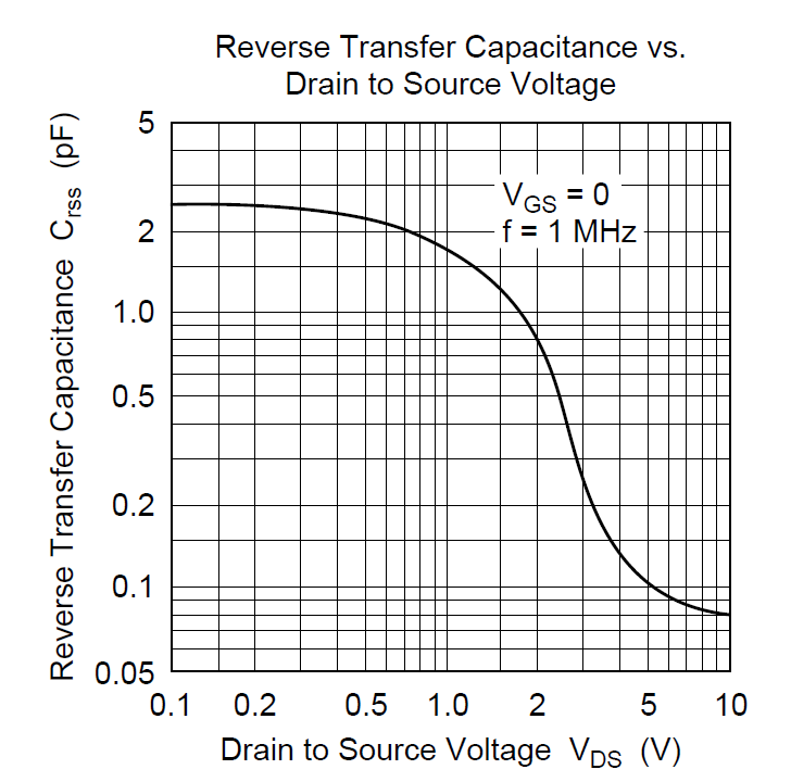

Hello,
I not have model of 2SK168.
2SK168 is lager gate leakage current (10nA max), but it can be competitive for bipolar audio op-amps.
2SK30ATM Ciss 8.2pF, Crss 2.6pF
2SK30 is one of best seller JFET, someone may wants SMD version.
Attached image is Crss vs Vds curve of 2SK168.Note that both Ciss and Crss change as a function of VDS, or VDG.
2SK208 Ciss 8.2pF, Crss 2.6pFI don`t trust the 2SK208. Ciss is not that relevant, Crss is.

Kaneda san popularized the 2SK30. I don`t trust the 2SK208. Ciss is not that relevant, Crss is.

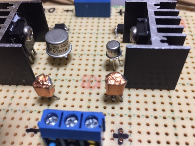

I replied to the discussion starting with
JFET’s J113, 2SK170, 2N5457 and others
where audible effects of various JFET choices were raised.
My testing involved building dozens of otherwise-identical test circuits where a single parameter such as semiconductor choice or VDS was altered, then scoping the circuit (for stability, noise and offset), then listening blind.
