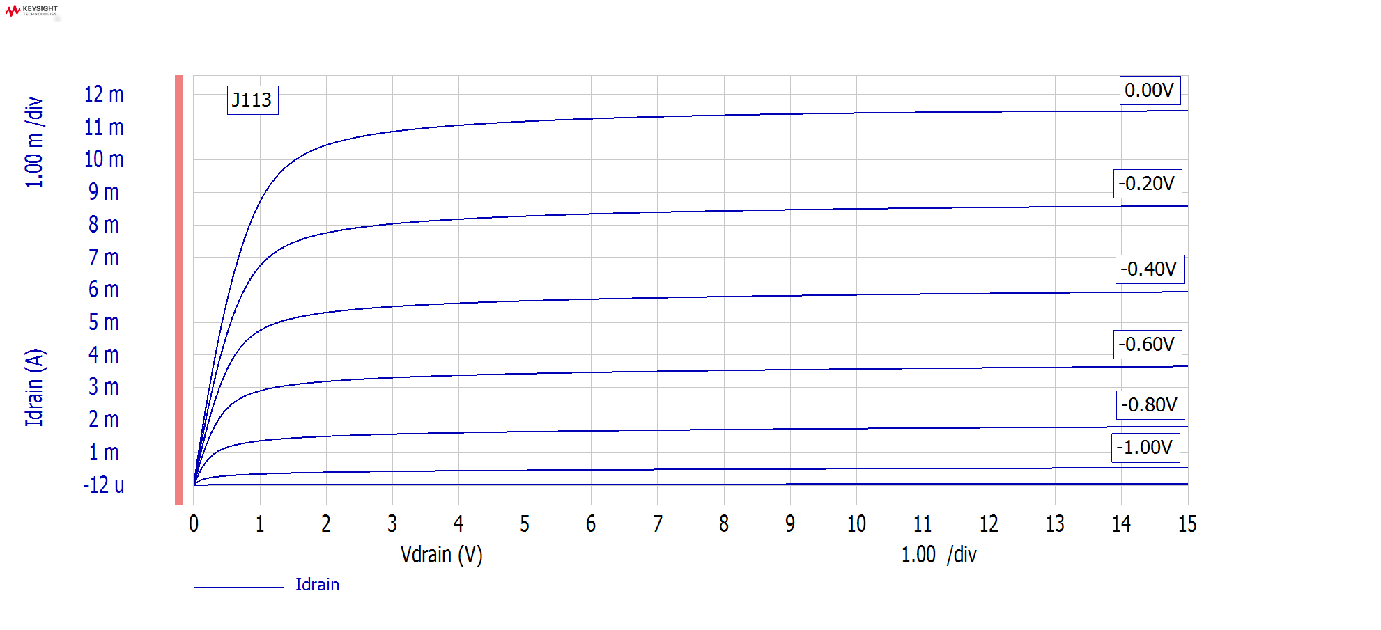

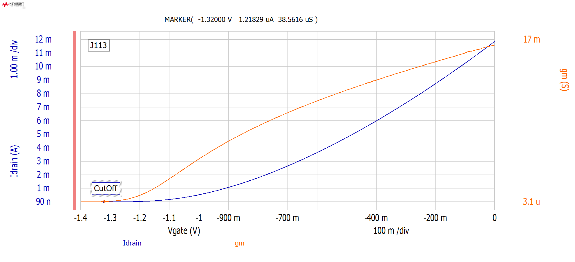

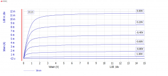

See the attached J113 plots

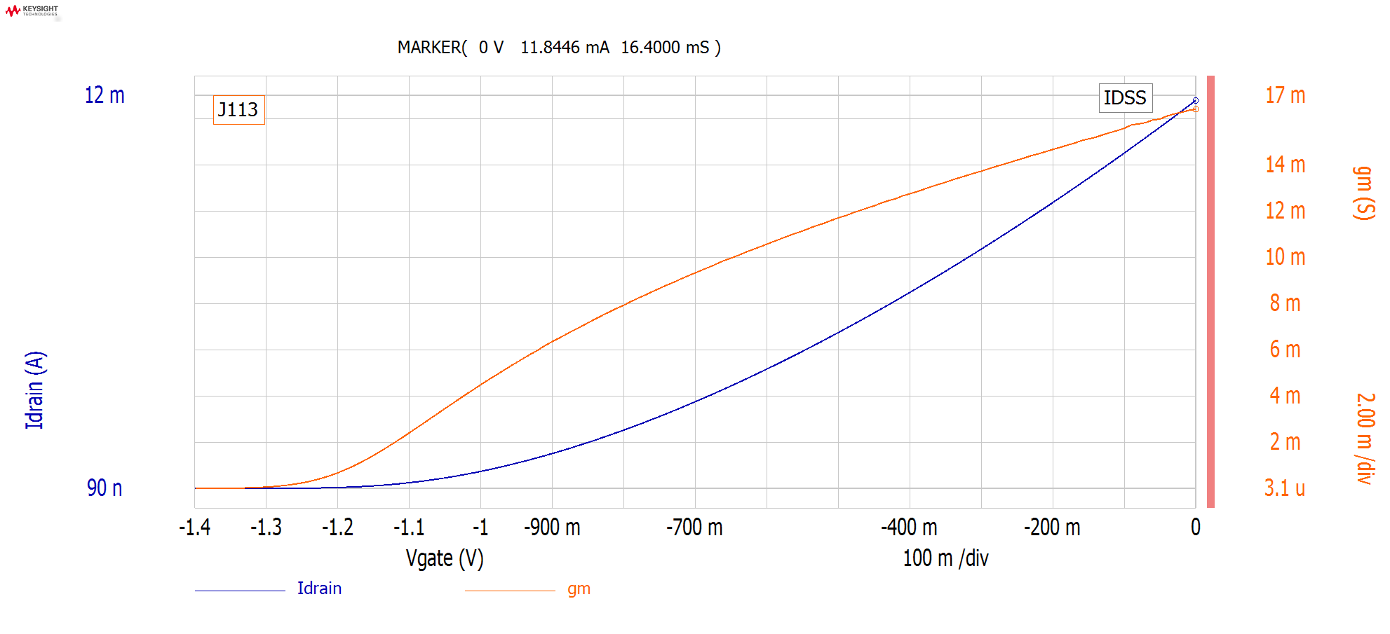

Hello,
Still playing with the software and hardware.
This time J113.
See the attached J113 plots;
The IDSS could be matched to be close to the K170.
The transconductance and CutOff are nowhere near.
Thinking Yup, the J113 is not a drop in replacement for the K170.
Thanks DT

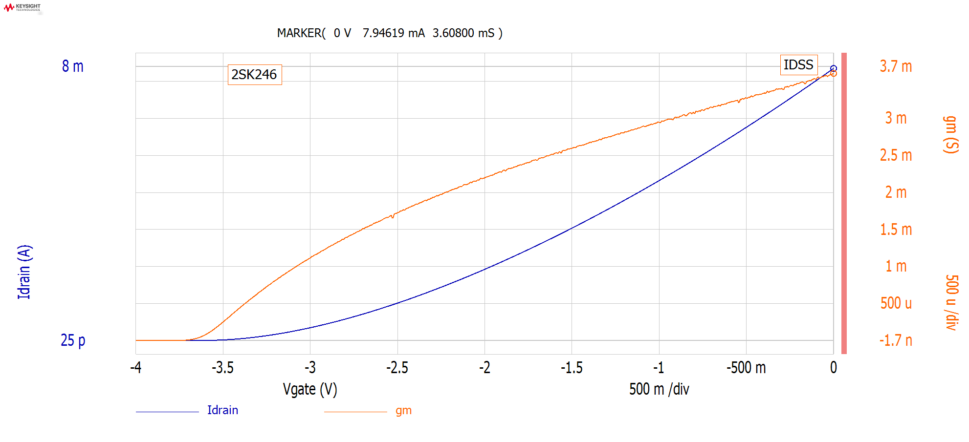

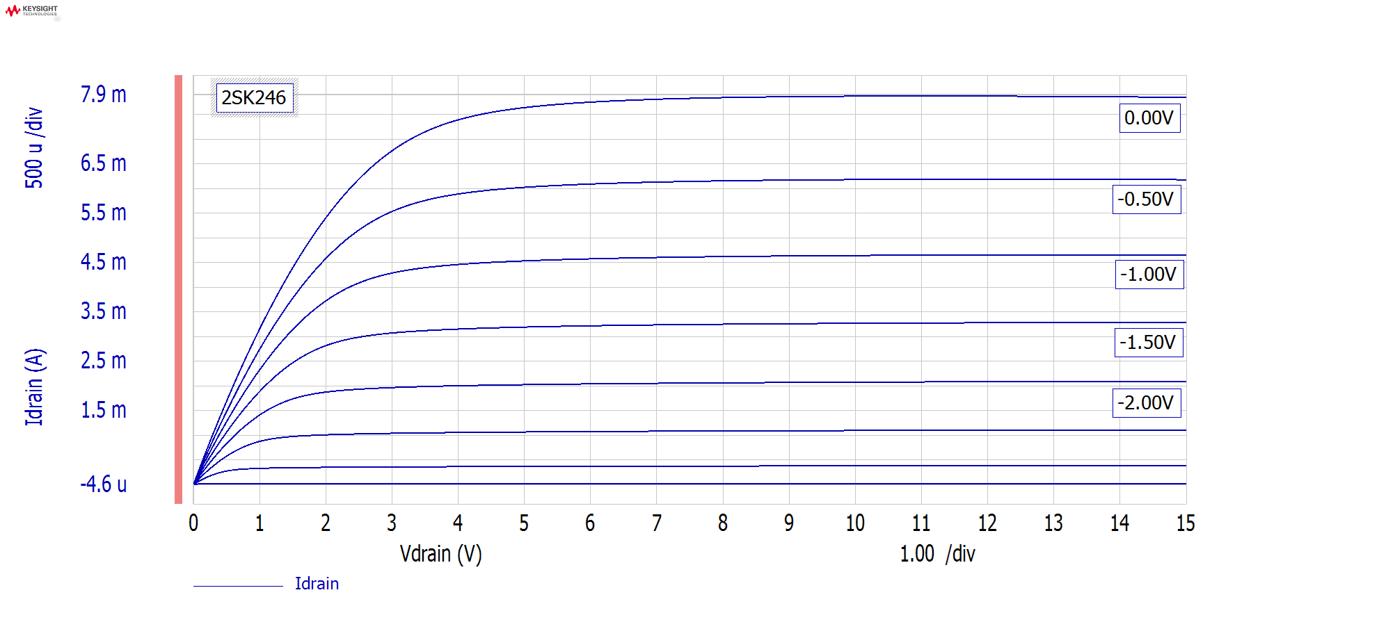

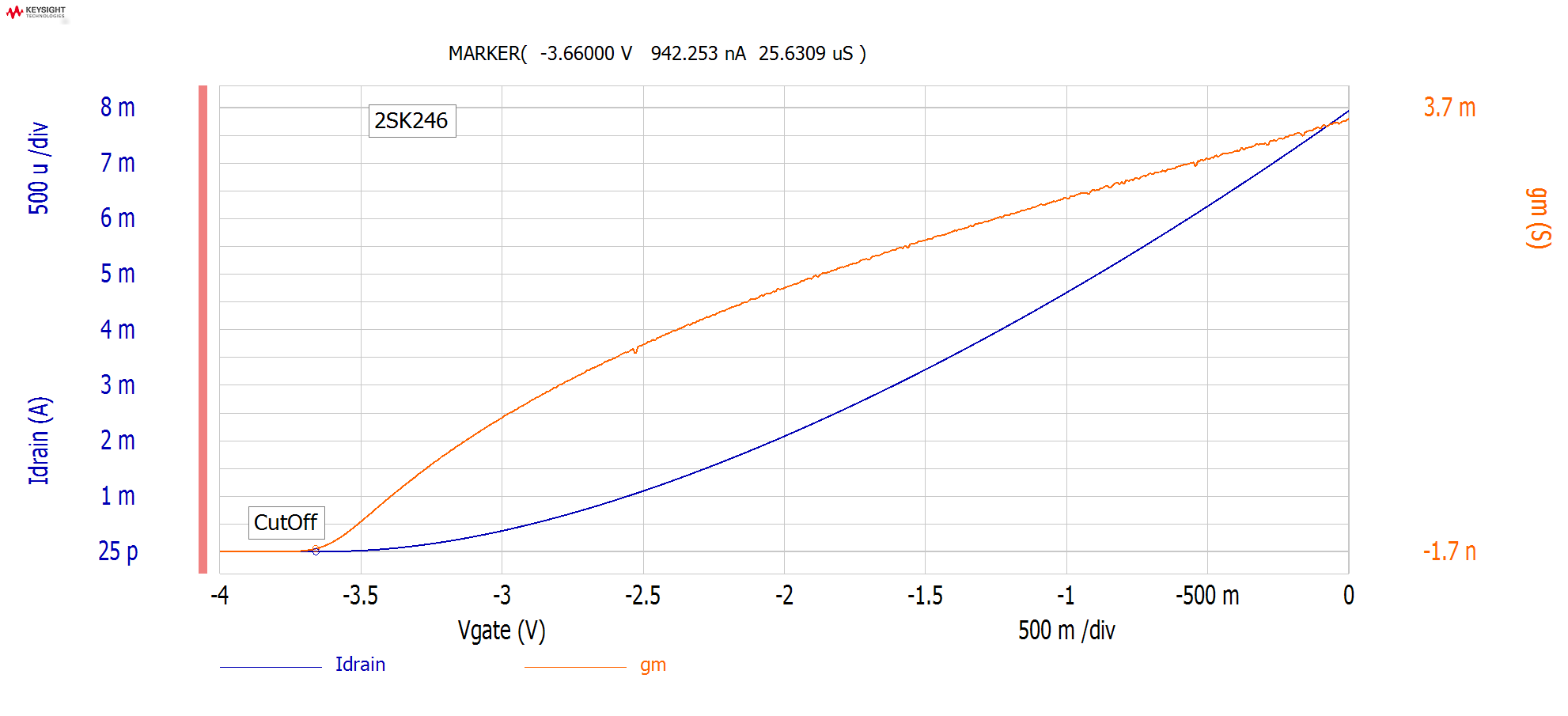

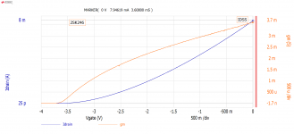

Okay.
I am sure that there is a NOS stash on the shelf at your house.
I want to look at the tools to optimize the JFET’s at hand and also stashed away.
In my bin there is a stash of Toshiba 2SK246’s.
Take a look at the attached Toshiba 2SK246 plots.
Thanks DT

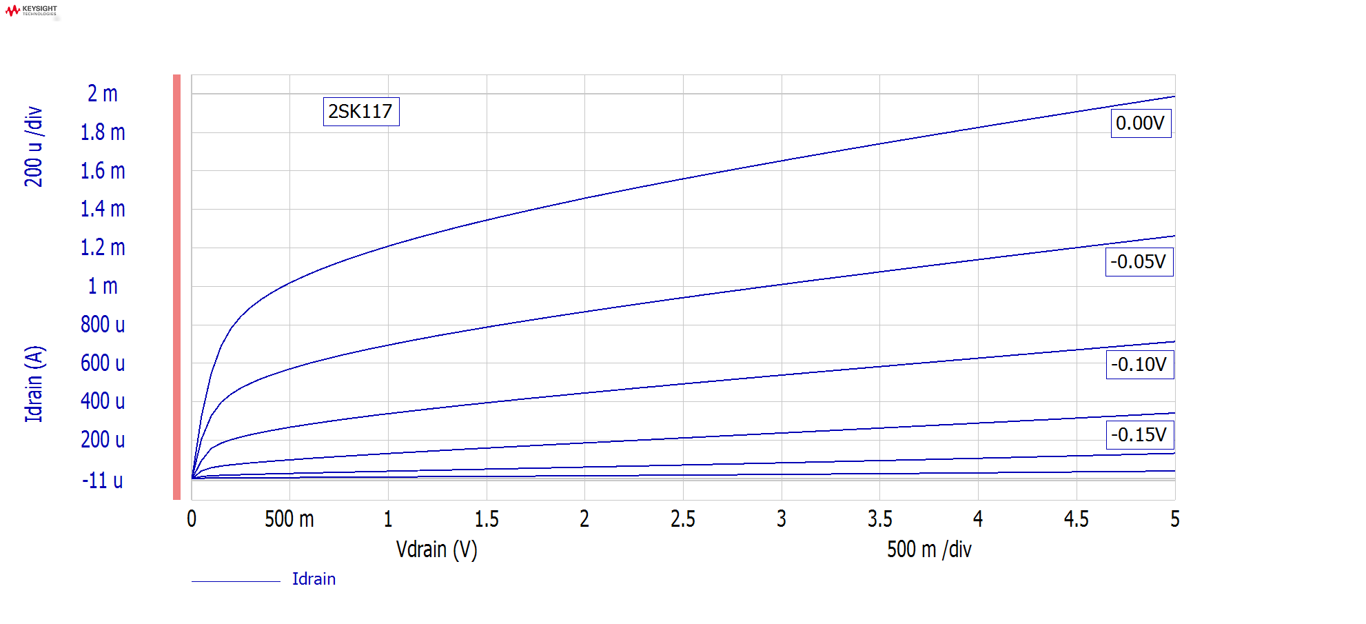

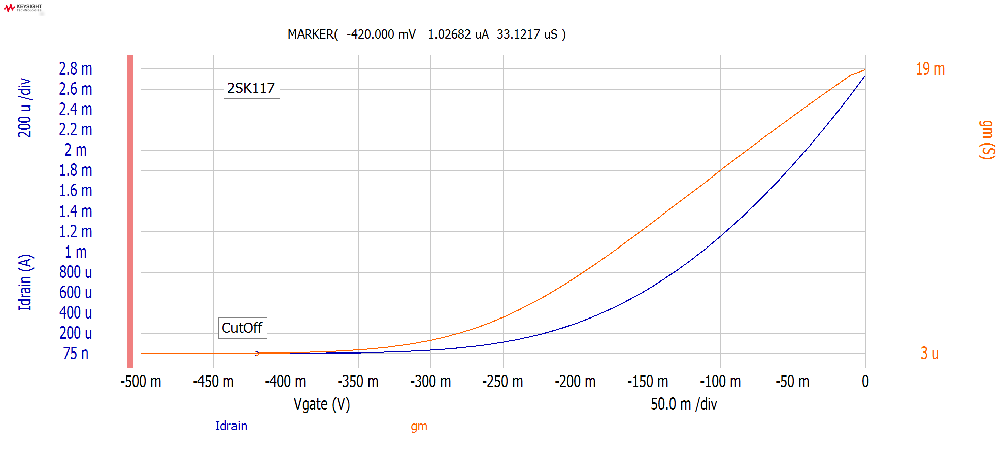

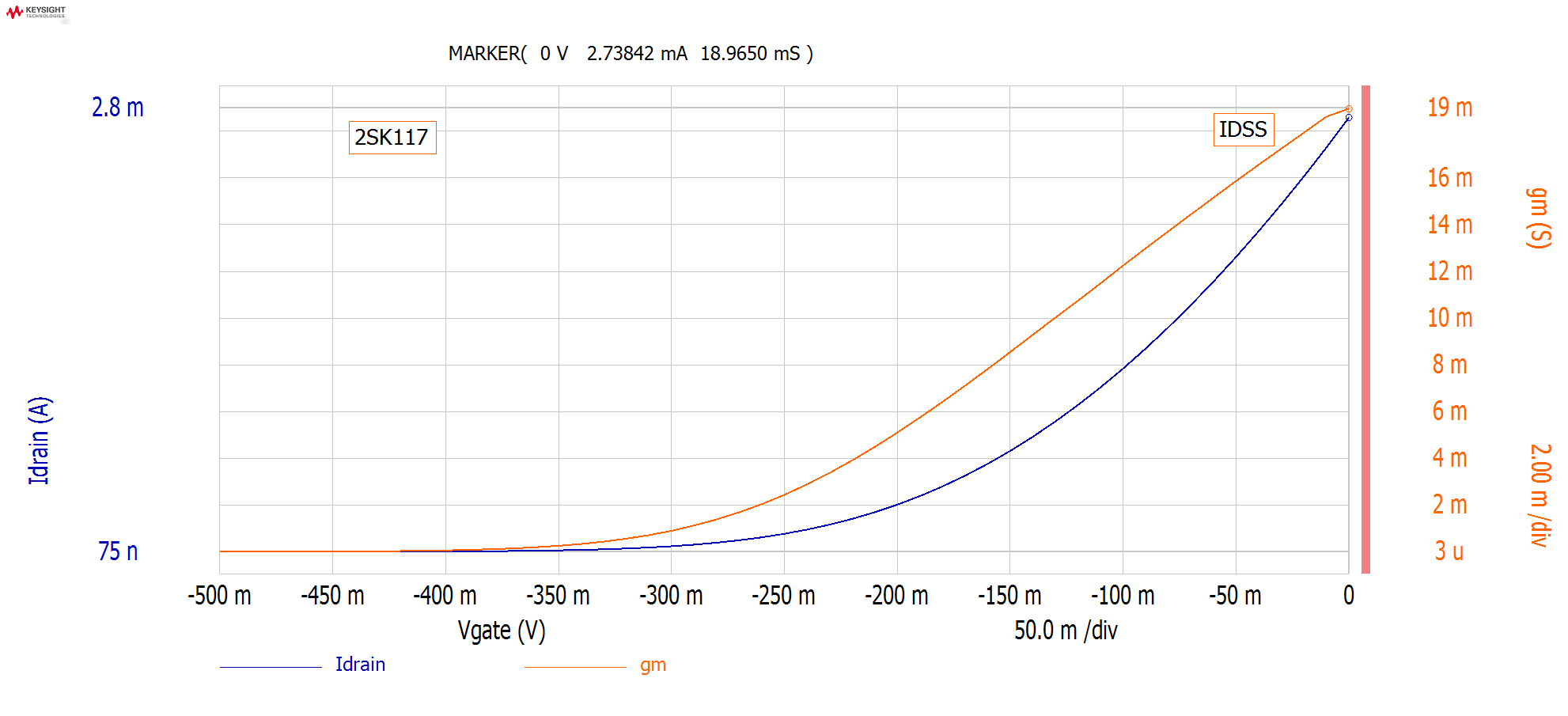

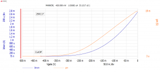

Hello,
Today I received a package of 2SK117GR's.
See the attached curves.
Note there are excel data files for each of the curves posted. I do not know how to attach them or DIYaudio does not like the data format?
Thanks DT

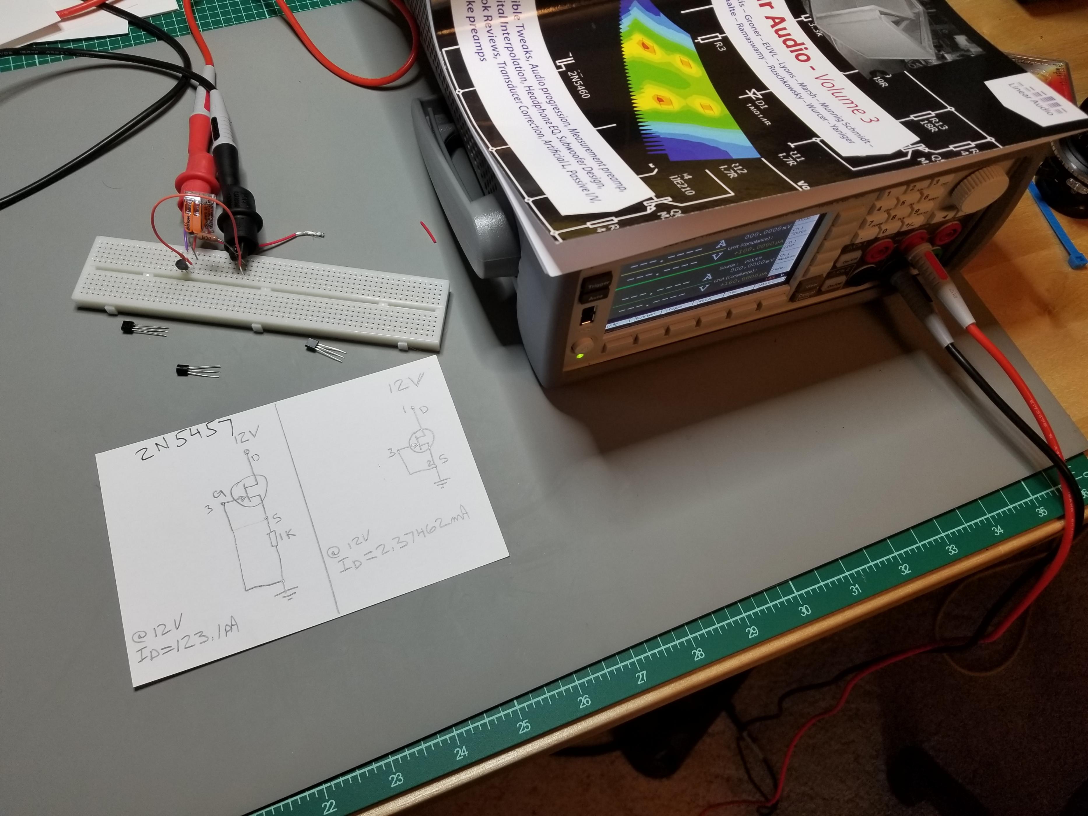

DT, what equipment did you use to collect this data?
Jan

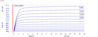

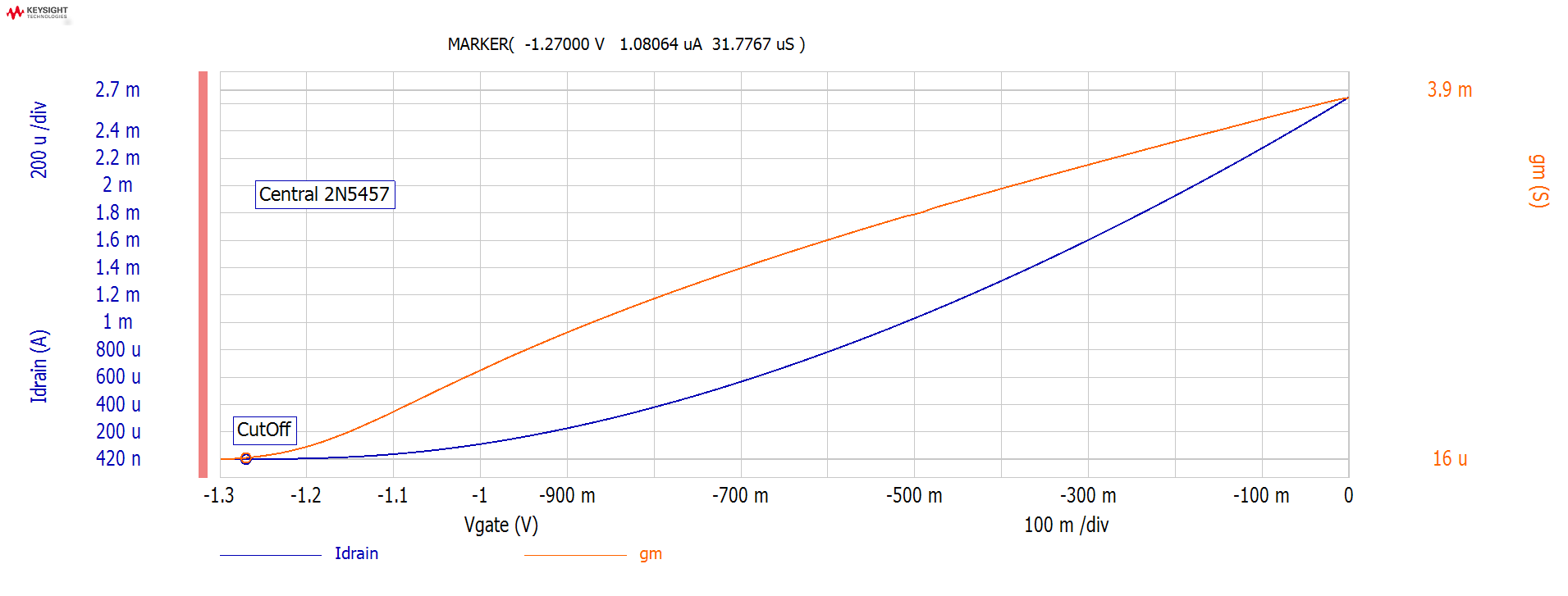

Jan,
The instrument is a Keysight B2912A, I purchased it used from Keysight on Ebay. The software is also Keysight, EasyEXPERT. The instrument arrived with a 30 day warrantee. When I received the instrument I took it to the Keysight service facility near me in northern California for calibration. So a new to me instrument, a fresh calibration certificate and the warrantee extended to 90 days.
https://literature.cdn.keysight.com/litweb/pdf/5990-7009EN.pdf?id=2035016
This instrument is also a precision dual power supply, up to +- 210VDC. Next step is to use it to test push/pull JFET amplifiers for distortion and noise on the audio analyzer.
The next little project is a JFET test bread board with clamp in sockets and DIP switching to select exact source, drain and load resistors. The parts were ordered yesterday.
I saw Nelson Pass post a photo of something similar he uses to match JFET’s and select precise resistor values to dial in resistors to minimize JFET distortion.
Thanks DT

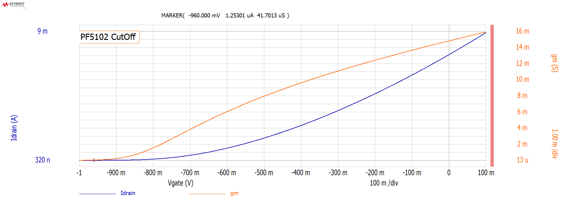

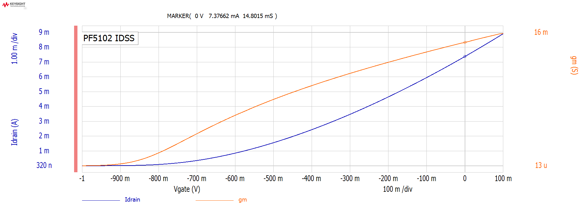

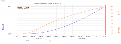

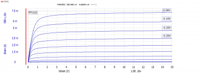

PF5102
Hello,
PF5102’s.
They are what looks like a different IDSS range of the J111 family of N JFET’s.
ON has notified End of Life for the PF5102 JFET.
See the plots.
PDF’s of the data this time.
Thanks DT
I received the switches and resistors to begin fabing the little decade PCB's.
Thanks DT
