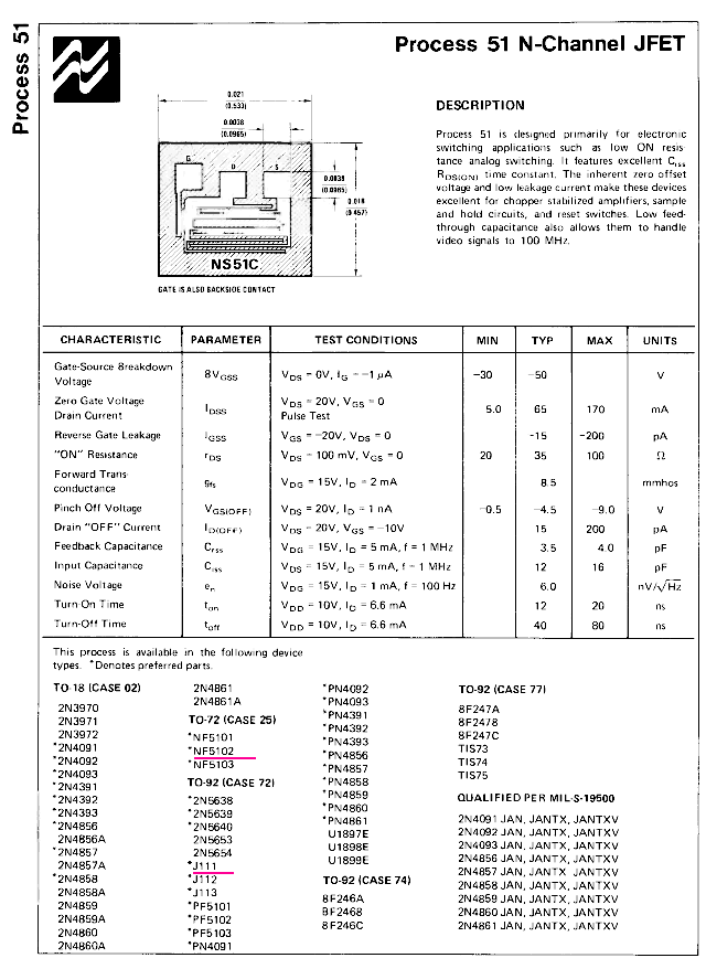

> PF5102’s. They are what looks like a different IDSS range of the J111 family of N JFET’s.
They both derive from "Process 51". Which is a mask (shown) and a general "cooking" schedule. The results vary from 0.5V to 9V, 5mA to 170mA, not tightly controllable. From that mixed-lot they sort-out to meet the several part numbers.
http://mirror.thelifeofkenneth.com/lib/electronics_archive/NatSemiFetDatabook1977_text.pdf PDF page 51
Hello,
I am thinking that Process 51 from the 1977 catalog is a lot like the raw chocolate chip cookie dough from Papa Murphy. They turn out much differently depending who is baking them. I prefer them a little chewy not crunchy like a cracker.
Forty-two years later I bet that they are better at the process and controlling the IDSS performance.
Looking at the Id-Vg (step) plots on the Process51 sheets and J111 Datasheets the Vg only is tested up to 5Volts. It looks like that the interest on the data sheets is more in switching than the higher voltage saturated range that would be used for DIYaudio.
The batch of ~200 PF5120 Jfet’s on my bench tests in the 7-9mA IDSS range.
The same specification J113 (except IDSS specification) measures mostly in the 10, 11, 12, to 13mA IDSS range.

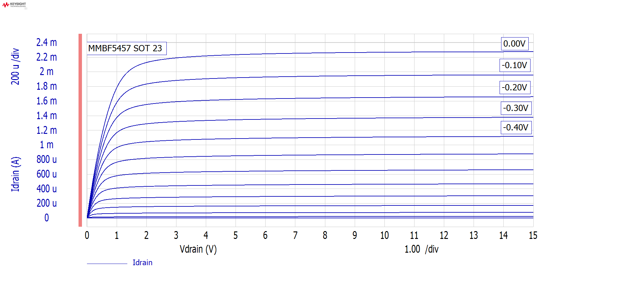

JFET Saturation?

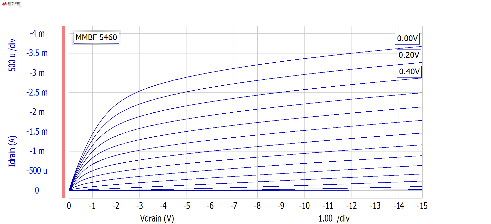

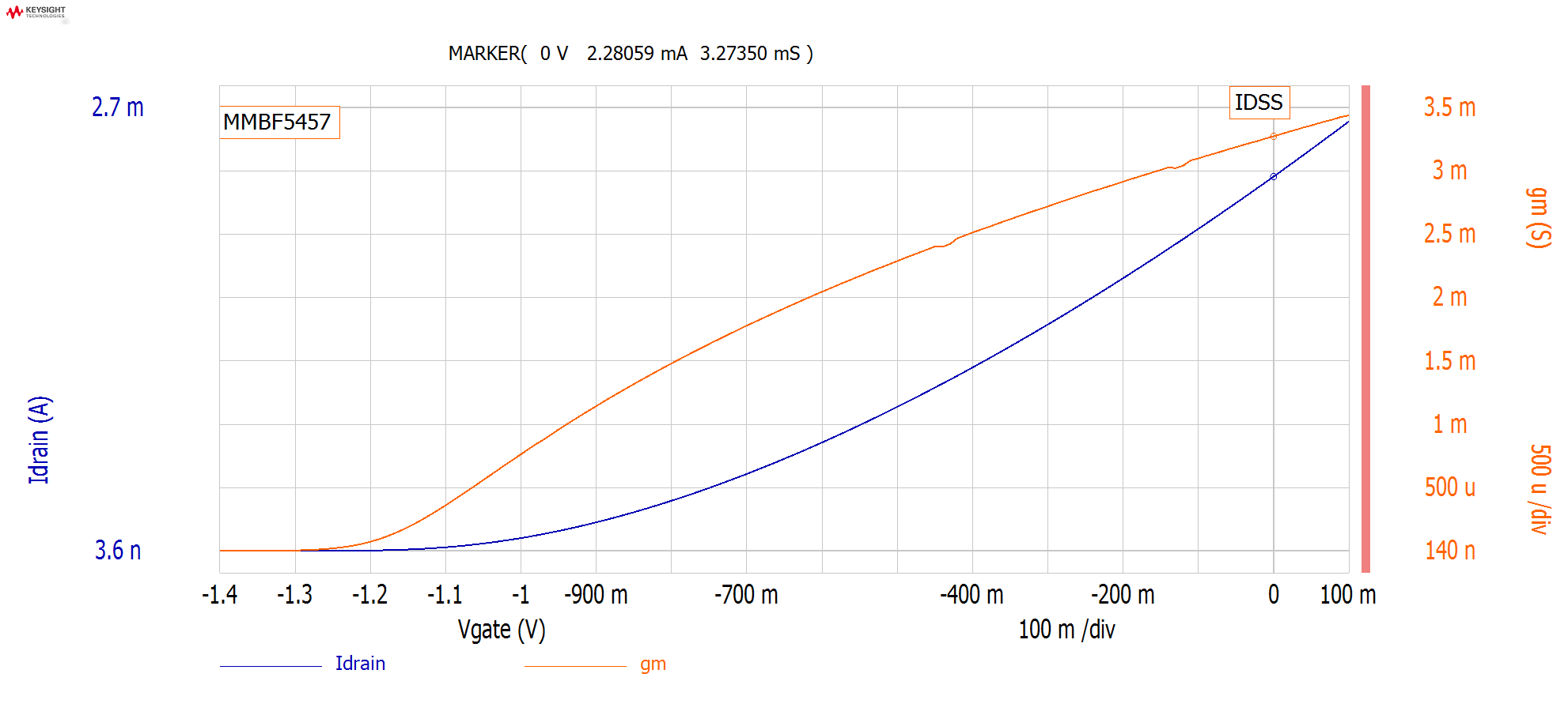

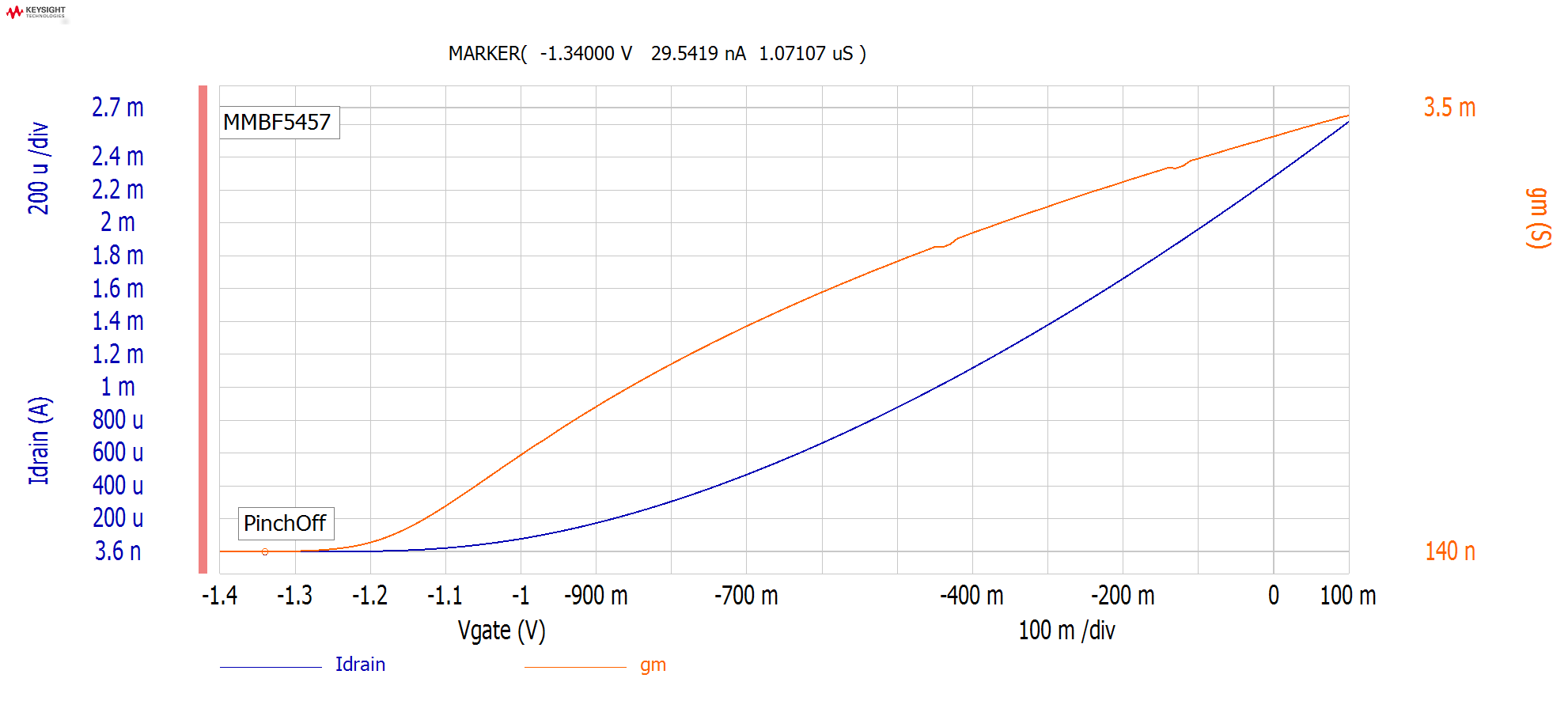

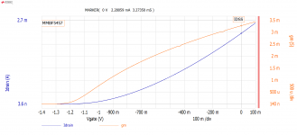

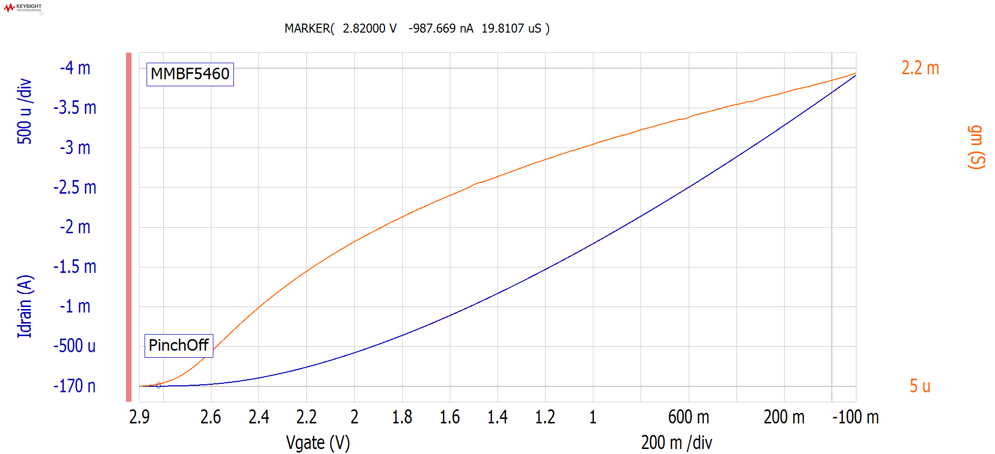

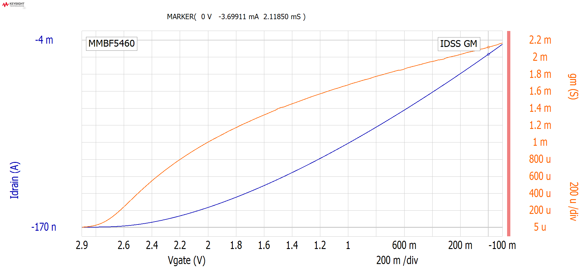

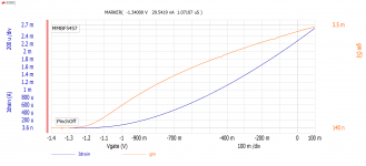

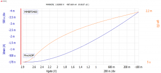

Hello All,
These tiny little SOT 23 JFETS are a pain. Yes you can pick them up with tweezers, put them into a socket and measure them. Even on a good day solder them by hand. You take them out of the strip, do the measurements, now what do you do with them. How do you label and store them. Did I say pain?
I received some MMBF2457’s and MMBF5460’s from Mouser. The N and P JFET’s do not test equal and opposite at all. Even if the IDSS tested sort of the close, the Pinch Off voltages and Transconductance do not look like they anything like N’s and P’s from the same family.
The MMBF5460’s never really making it into Saturation as a good JFET should.
See the attached plots.
Thanks DT

What's the problem ?
No surprise.
The only truely complementary N-P JFET pair is 2SK163 / 2SJ44, as I published at the F5X thread ages ago.
Not even 2SK170/2SJ74 are truely complementary (also published).
If I use them as followers or "penthodes", I want them to saturate soon.
So it depends on the circuit.

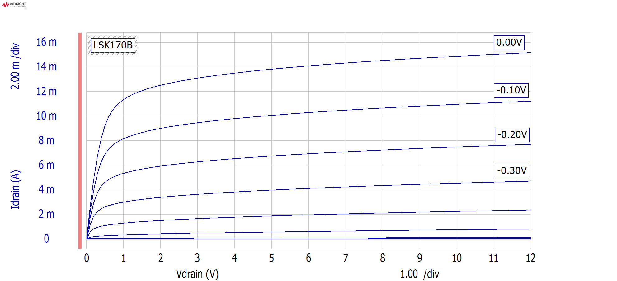

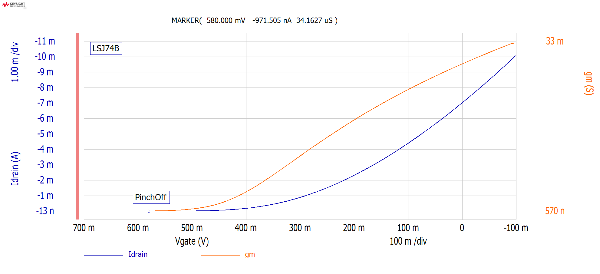

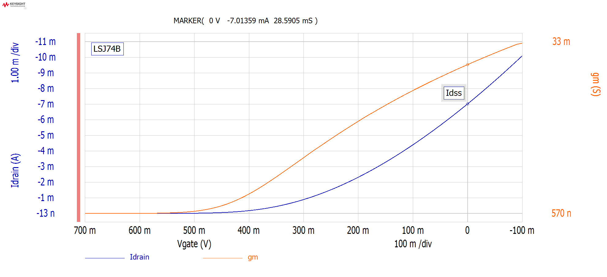

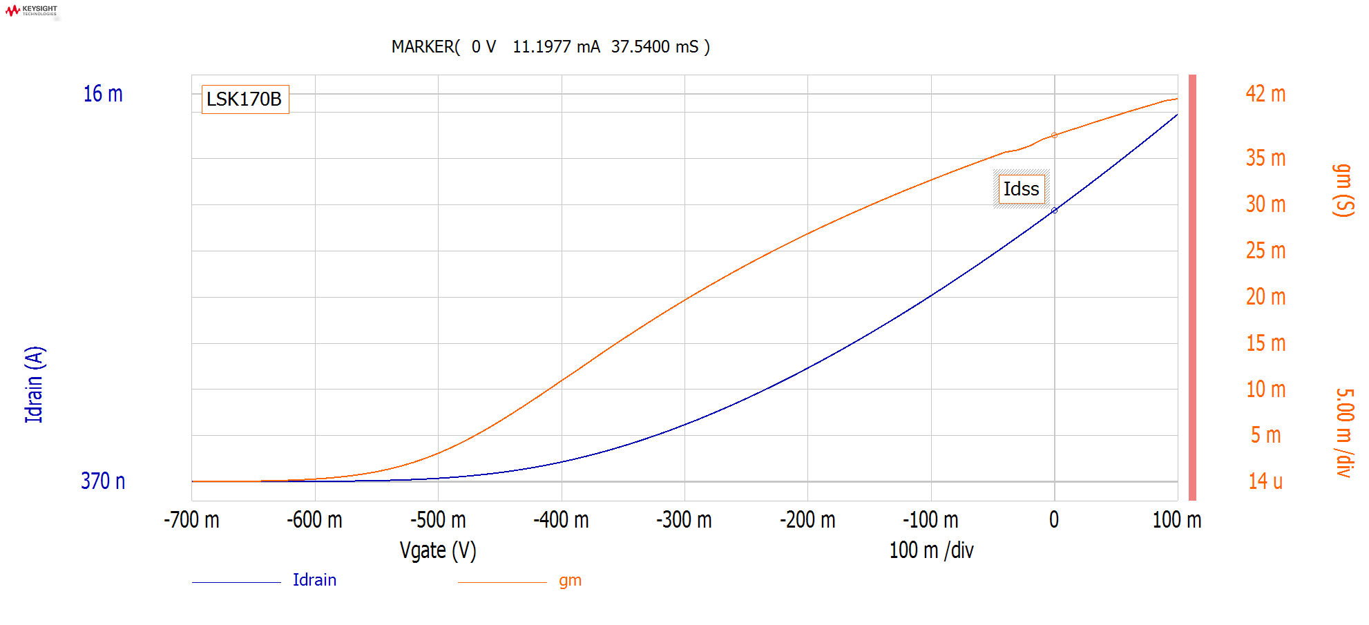

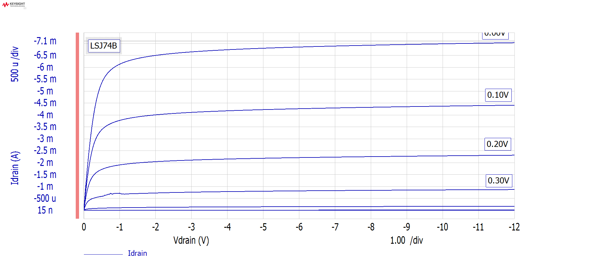

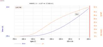

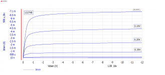

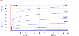

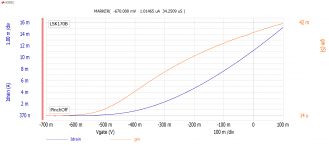

Found Free Sample Transistors LSK170B and LSJ74B JFETs
Today I was looking at my copy of Vol. 6 of Linear audio and found free sample LSK170B and LSJ74B JFETs inside the pages.
Thanks DT
Thanks DT
