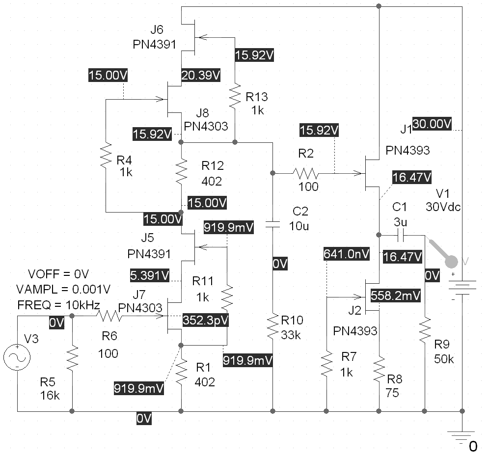

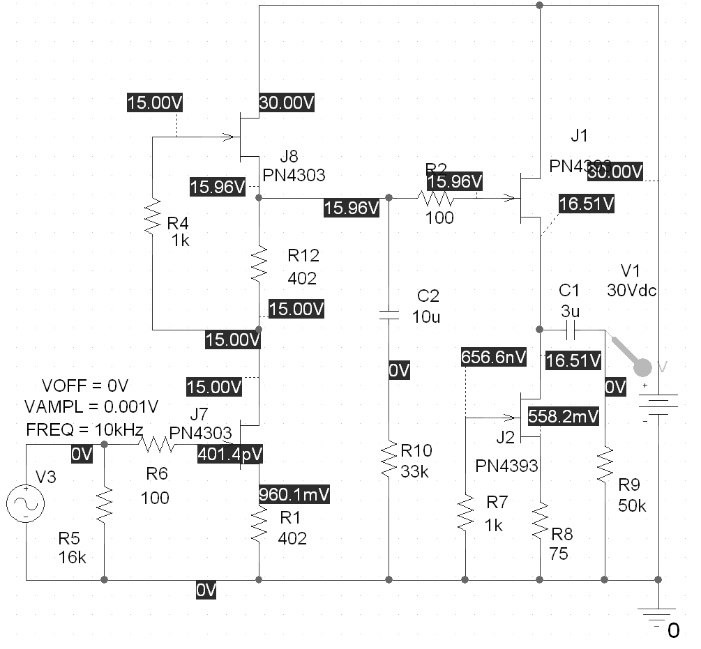

I think I didn´t correlate the findings in my sims correctly though. Attached are two circuits, one is a cascoded SE-stage feeding into a resistive load and the other is a cascoded SRPP-stage.
The noise problem is obviously not so much due to the active loading as I initially thought. I was tricked by the immense gain (and as such noise-gain) that the stage is capable of. The SRPP has app. 40dB more gain than the cascoded SE-stage, which correlates well with the roughly 40dB higher noise figure. What remains fascinating is that the THD-values nearly equal, consisting mainly of K2. K3 sims in fact much higher with the SRPP circuit, but is still on such a very low value, that its influence on the THD-figure remains negligible.
The gain of the SRPP is extremely high. While the stage may handle a preequalized phono signal up to the midrange it certainly will clip at the HF end. R10 is added to allow for a certain reduction of gain, but a parallel cap will be needed to lowpass-filter (2120Hz-LP) to avoid overdriving the stage.
One could of course reduce the gain a bit by using just one BF82 per cascode instead of a paralled pair, but this wouldn´t affect much on noise figure.

yes, the cascoding transistor should be of high gain types, whereas the ´driving´ transistor of the cascode may give too much gain if it features a high hfe or gm-value. But the cascode itself doesn´t add so much to the noise that it plays a major role in this application. In fact the cascode combination of BF862 and 4391 simmed extremely well with regard to noise and THD. The exploitation of its comparably low capacitance may be more sensitive, especially with MM-pick-Ups.

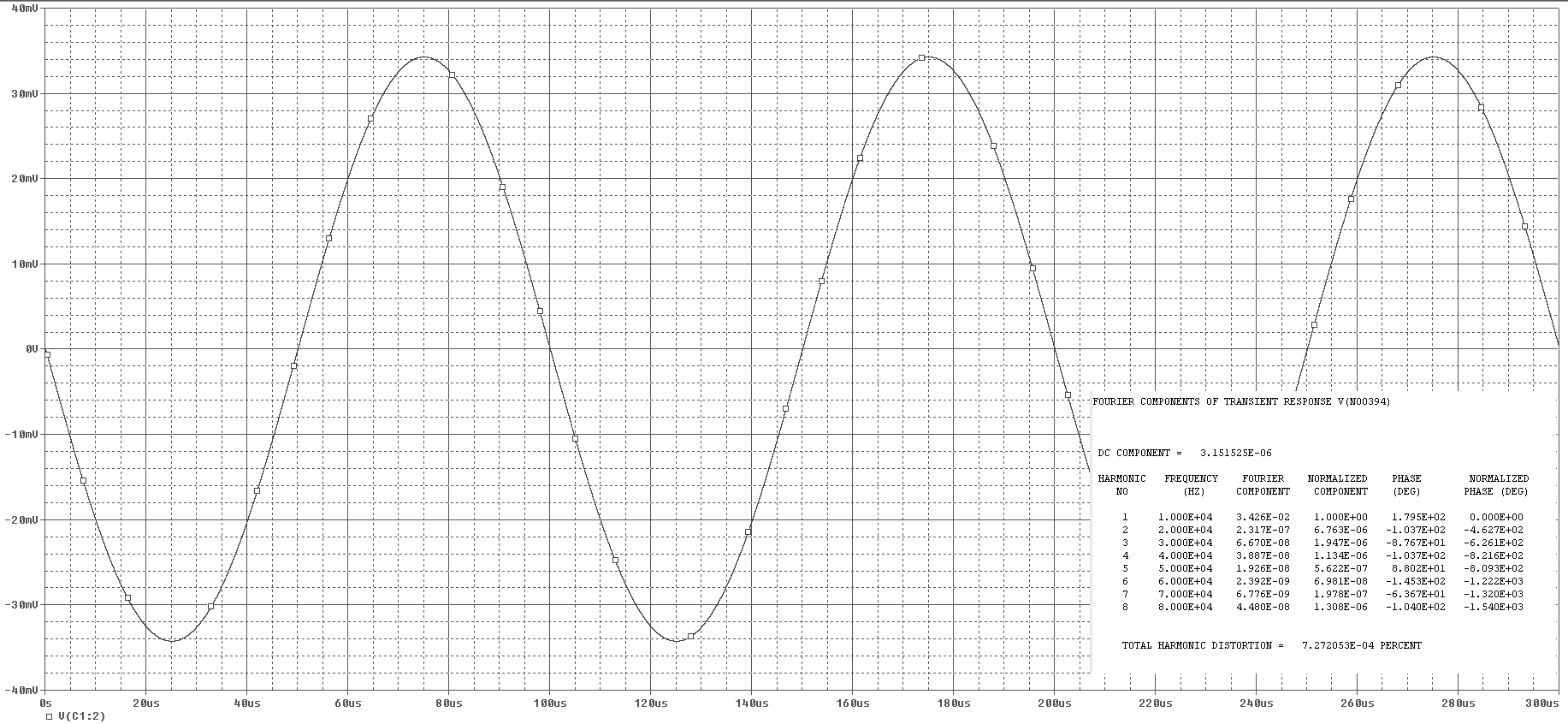

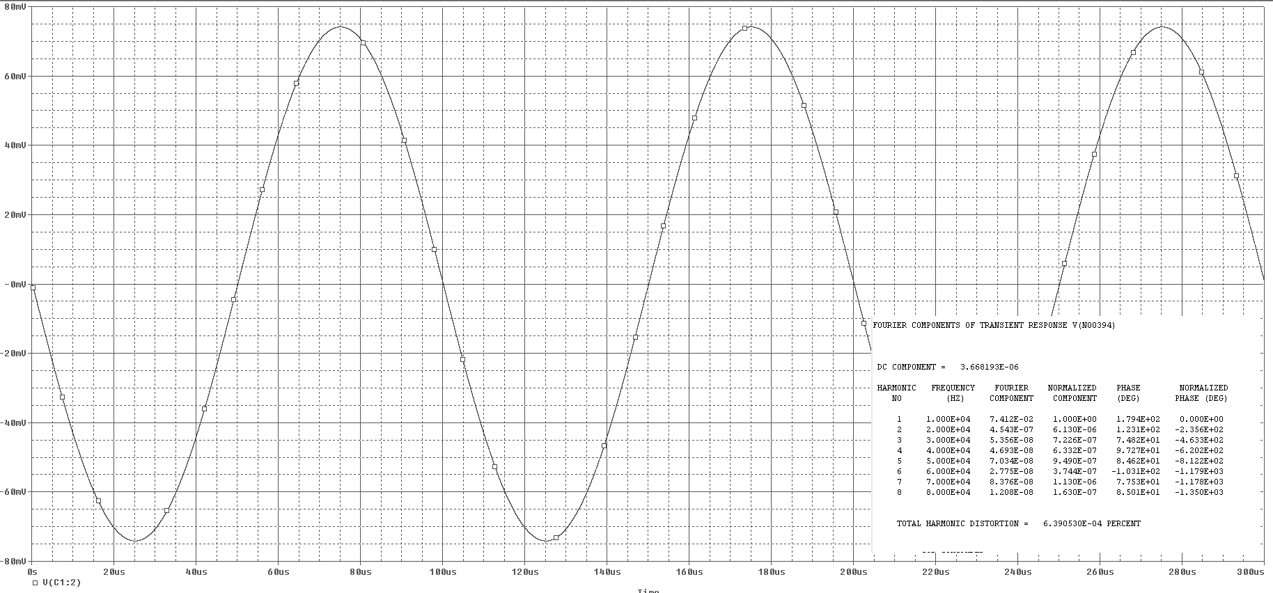

here´s the simulation for a single-BF862/4391 cascoded SRPP.
Gain is lower at 61dB, noise only marginal better at -68dB (Riaa-filtering and signal preequalizing will pimp up noise figures though).
Really extraordinary are the low THD values.

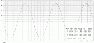

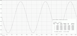

Dunno about that Calvin. Doing the sims with pretty modest devices without cascode yields good THD. Adding the cascodes seems to increase the THD. At least, this is what I encountered last night when I tried it with the PN4393. I'll try again later using something like the PN4303, which is a low-medium gm device that has good SRPP THD results without cascode.
It would be useful to cascode the first stage in my new preamp, as a lot more gain is lumped in the first stage. A cartridge like the Grado or a high-output MC might not care so much about that, but an honest-to-goodness MM cartridge might not like the amplified Miller capacitance.
Well, I had a chance to do a symmetric cascode of a mundane fet like the PN4303, and the results were surprisingly good. Attached is the schematic I used. The values are no good for MC duty, but will work just fine for MM cartridges, certainly less noisy that your average 12AX7 circuit.
