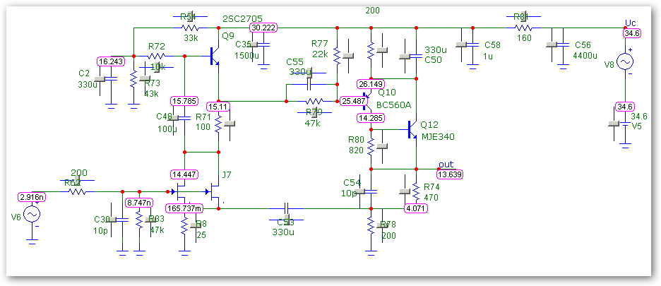

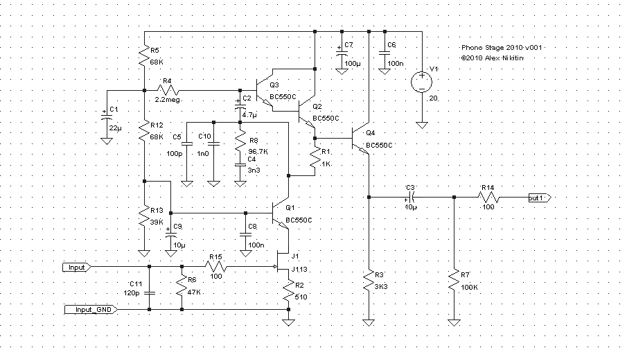

I am interested in your Post #56 where you mentioned about SRPP redesign and the simulation results.
But only input stage is shown there. Could you show whole circuit including output circuit?

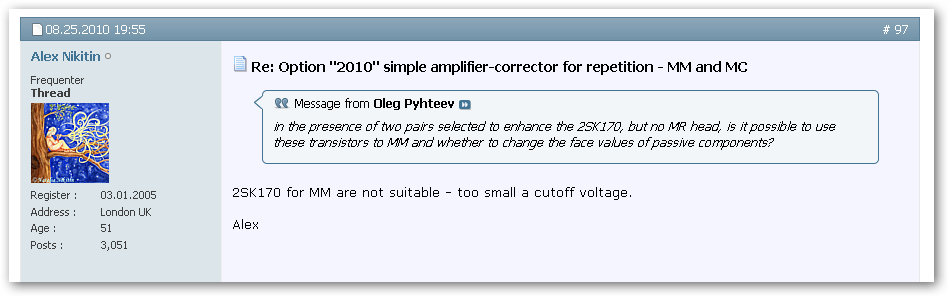

One more thing regarding the 2SK30 - the useful device ranks would be the Y (1.2-3 mA IDSS) and G (2.6-6.5 mA IDSS).

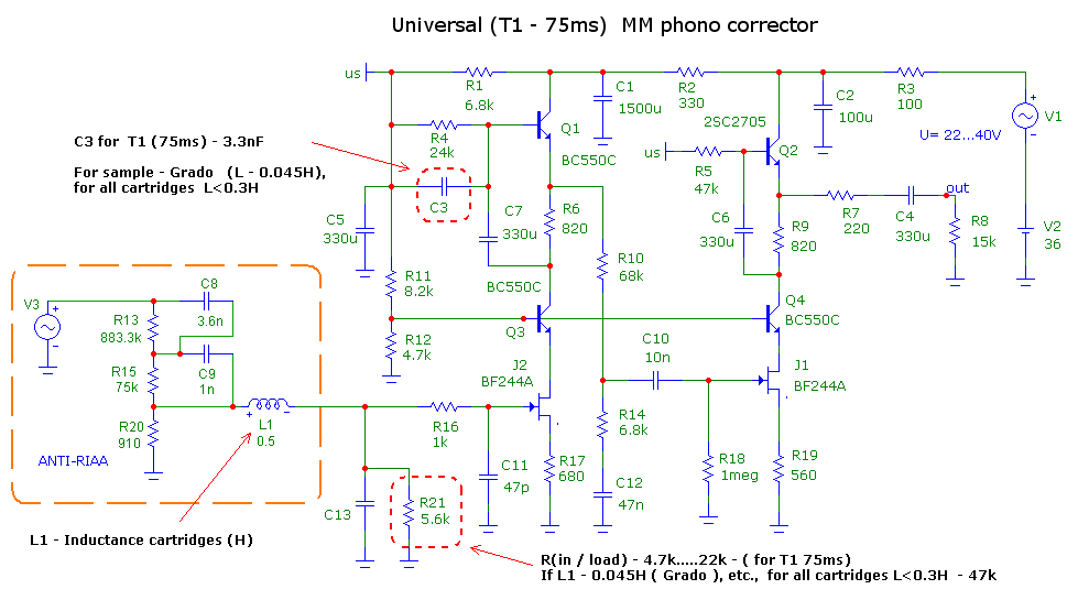

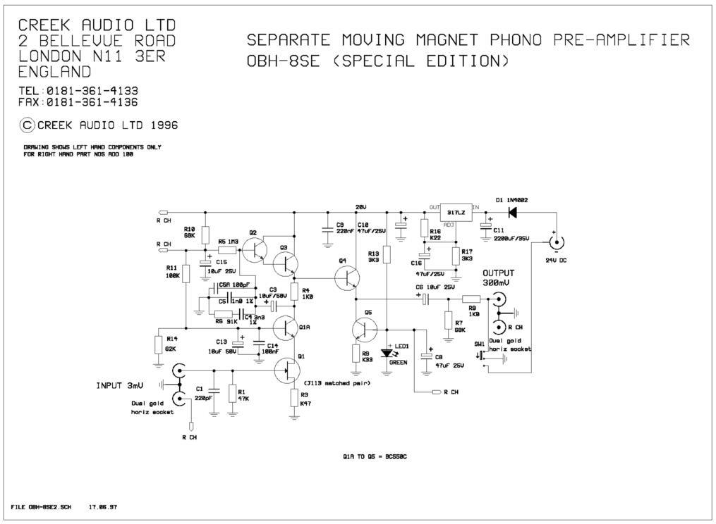

Hi, nice mod. I think he uses J113 cascoded in his OBH-8SE? Do you have any idea of the en with BF244A and the Rs value you use? Also, why you have chosen an SRPP output too, over his constant current sourced emitter follower? The 15K across output is to ensure some ideal load for that SRPP? Any particular reason you have broken the passive network he used to employ as a whole in the first stage into two places? Most importantly, did you build and test it? Any measurements for noise floor, THD, etc.?
Hello Salas!
1) Alex Nikitin wrote, that applied BF244A, BF245A, J113 ect.
Typeselection of transistor : J-FET must have U(gs) min. - 0,5V (falling on Rs) and I(d)=1-4mA in an operating point!
I think, capable of working in this chart 2N3819, 2N4220, 2N5248, 2N5458, MPF102...
A simulator it confirms.
2) the Second cascade has a structure of SRPP, because this circuit technology provides good linearness and as a result are small distortions without a general feed-back.
3) Loading of 15к is used for the test of chart (most not advantageous mode), real loading: 22-47к (entrance resistance)
4) On a chart 2 varians of correction are indicated 75ms, what from them to use - depends on inductance of MM of cartridge and Your taste.
This RIAA preamp - a simulation only, I did not build him.
Noise of cascade will depend on noise of J-FET and value R(s).
Best regards,
Alex.

Thanks for the reply. Is there any link for the original Radio Hobby article published in Kiev? Is Alex Nikitin Ukranian or Russian by the way?
P.S. I measured a BF245A for on resistance and its about 300 Ohm for 2-2.5mA IDSS. That and your source resistor gives me an estimation for about 5.4nVrtHz input noise equivalent. That is without R16 that will take it to 8 nVrtHz! I would lower the gate stopper or discard it if it does not oscillate in practice. I would not push it for MC in other words with such en, although it can give gain if you want. Would do better with higher impedance MM carts as for noise. 1K and over source resistance carts.

Thanx Alex, I was aware of his OBH style CCTs even presented as Cambridge plug in phono for A3i he did for them. I am also aware of is JLH inspired phase splitter and TTL Mosfet same sex output stages. He has presented also here in old threads. I was more interested if you got a copy or url of the phono article he presented in ''Radio Hobby'' magazine, I believe a Ukranian publication.

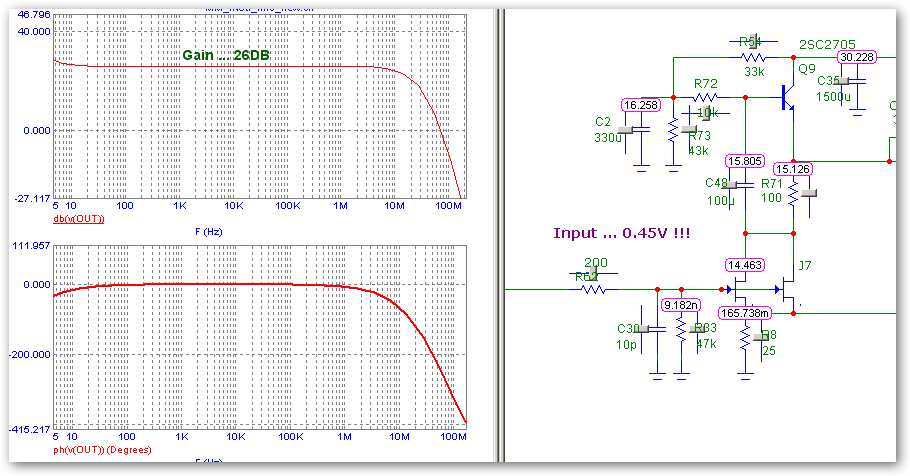

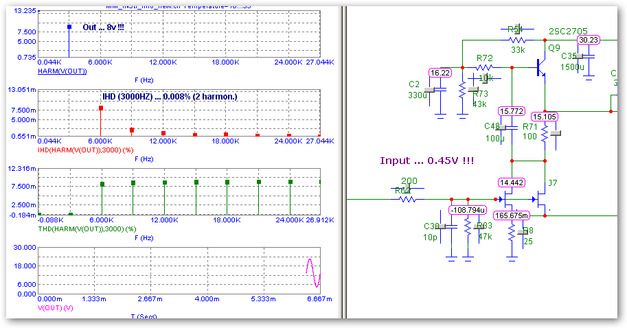

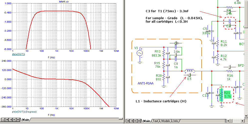

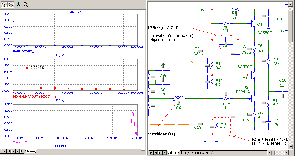

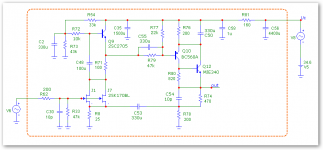

Hello friends!
I tried to do a new first cascade.
In a chart applied a feed-back, excuse..
I can not estimate noise, construction "on wires", it is a model.
Results measuring very near to MicroCap.
Look, what I have in the end :
What does this have to do with a JFET SRPP circuit? If you wish for people to discuss your design, start your own thread.

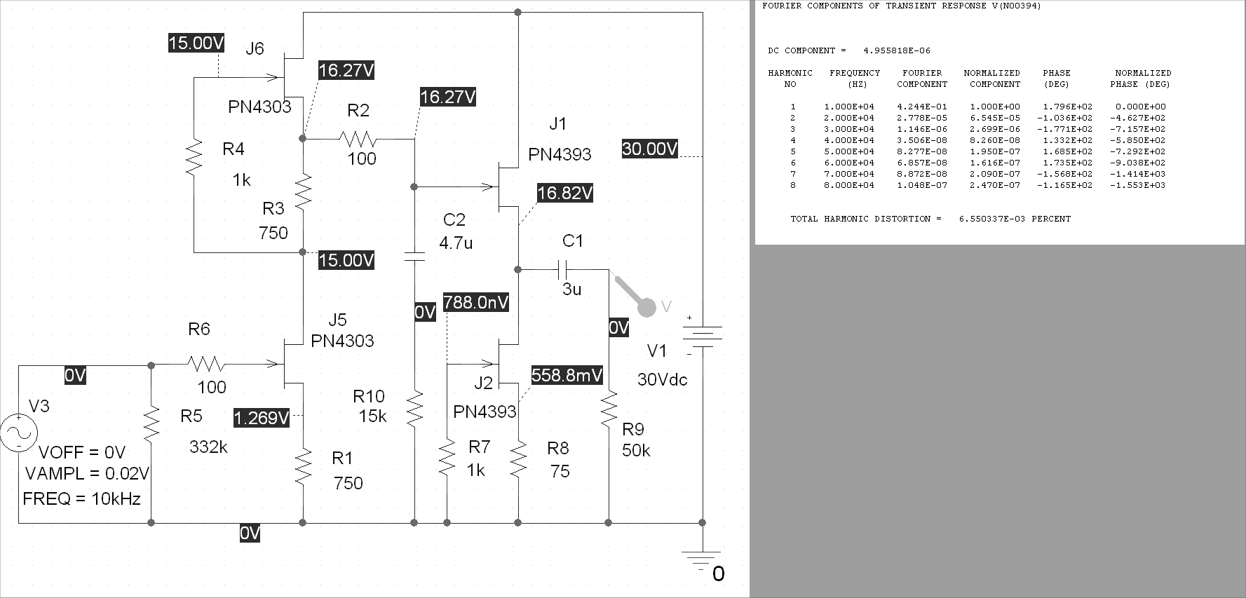

On topic - coming up soon is the next revision of this (SRPP) concept using PN4393 for first stage and (perhaps) 2SK30 for second stage, with PN4393 buffers all around. Those of you who are still whinging about PN4393 (readily available from Mouser & Digikey at ~30 cents apiece for the quantities needed to get the really matched pairs for this project) might want to look at the 2SK117. I just picked up 200 pieces of both the SK30 and the SK117 on Ebay from a Hong Kong seller. Time and usage (and some testing) will tell whether these are the real deal or relabeled junk.
At any rate, I just finished the layout, and schematic will follow when when I work out precisely what I want to do with the values in the second stage. The first stage using SRPP PN4393 and source follower yields vanishingly small distortion (simulated) for low level inputs (check back earlier in this thread for the basic simulation in PSpice). The gain is higher than I like to see for the first stage,(around 70X, if I remember correctly), so the gain on the second stage will need to be pared down accordingly. One way to do this is to use a lower gain fet in the second stage. I'll use my "2SK30s" for that purpose, but simulate with something like the 2N5459, which has similar characteristics (I also have the model). The PN4303 is also similar, and these are still available in Fairchild flavor from Mouser. Anyway, schematic will follow when I get things worked out to my satisfaction.
This is not a project for the kitbuilders, but the circuit has rewards for those with persistence who are not afraid of building their own breadboards and matching their own fets.

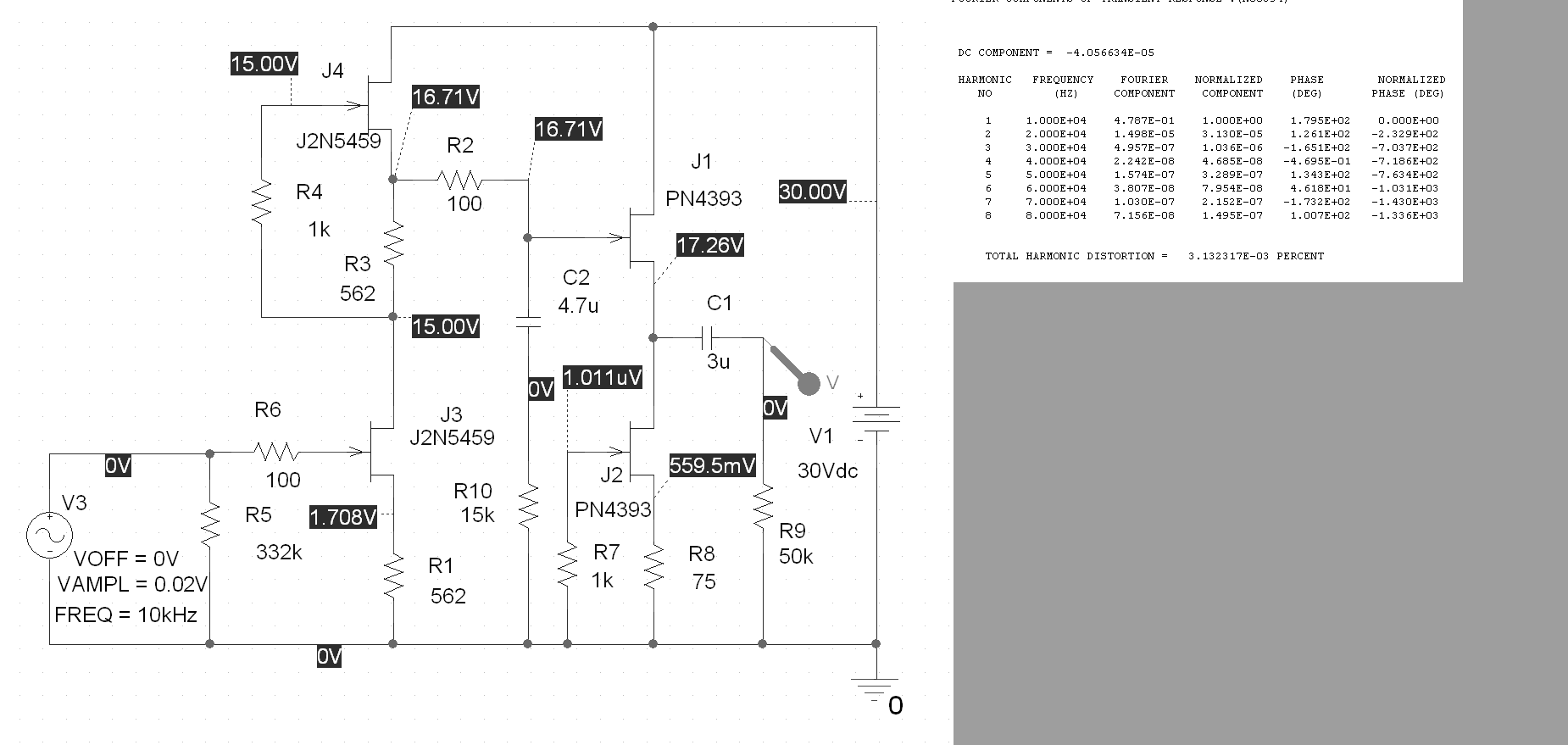

This is the piece I needed to finish the next revision of the SRPP RIAA amp. The simulation uses PN4303, as that's the model I have. 2SK30 could probably be subbed. This stage gives me a gain of ~20, which will match ok with the first stage, which will use a PN4393, one of my favorite workhorse fets, no matter how much everybody else whinges about it.
Anyway, attached is a simulation of a loaded SRPP stage using the PN4303. As you can see, high level distortion simulation is ok, and may respond to further tweaking. Things to tweak - quiescent current in the SRpp stage, and the capacitively coupled load at its output. This circuit might also work using 2N5459 in the SRPP input stage. Keep in mind, however, that the 2N5459 has a breakdown voltage of only 25V, so the supply voltage would have to be lowered to use it, sacrificing some dynamic range.
Some more messing around in PSpice using the 2N5459 model yielded better results. I think I will try populating this stage by selecting from the Ebay 2SK30A units I have on hand, whose characteristics are similar. The first stage will still be built using all selected PN4393.
