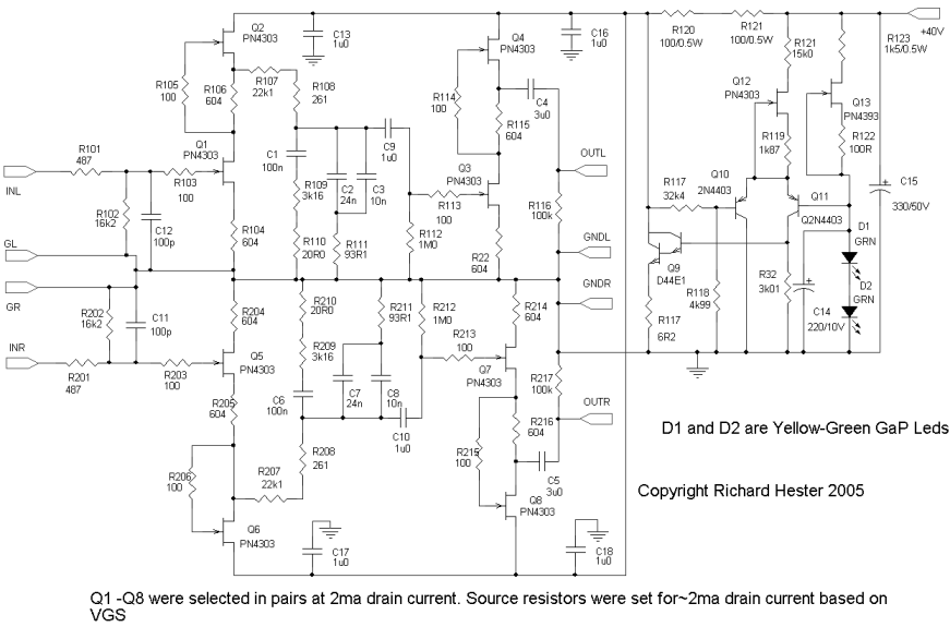

Hi Wrenchclone,
Why do you take the output from inside the GS resistor loop i.e. from above R115? Rather than from the bottom of R115?
At the input end you have shown R106 inside the loop and R205 outside the loop. Which is correct?

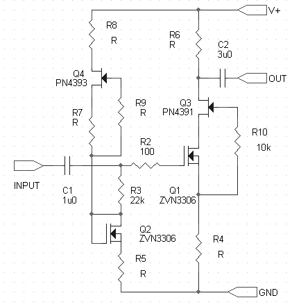

Attached is a schematic showing a MOSFET common source amplifier with cascode and a current source to bias up the MOSFET without all the bias current going through the load resistor. I simulated one of these using a Zetex ZVN3306 (Orcad had the device model) for active device, and high level distortion (~2V out into a 20k load) was around 0.05%, overwhelmingly 2nd harmonic. This was without the benefit of an output buffer. Needless to say, I'm trying this circuit out for the second stage of my RIAA preamp. Once I have the boards up and running, I'll start a new thread. I'm using the Supertex VN0106N3 instead of the Zetex devices, as I have loads of them in my parts bin.

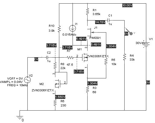

Funny you shoud ask - I screwed up, and there's an important piece missing out of the schematic I posted. There needs to be a second current source. The attached schemaitic is the one I used to do my simulation, and it has all the pieces...
M1 is the gain FET. M2 is used to set the overall bias current in M1. The ratios of R3 and R6 set the ratio of bias currents between M1 and M2. Ideally, one would use a current source in place of R10, and M1 and M2 would be matched and thermally coupled.
J1 is used to pin the drain voltage of M1. This provides the benefits of cascode operation, and also reduces the drain voltage of M1, reducing power dissipation and allowing use of a TO-92 device with relatively high bias current. The small device will need a lower bias current to get it into a "sweet" operating region. The small devices also have lower input capacitance.
Current source I1 is used to maintain the bias current in M1 without having it all flow through gain resistor R1. This allows one to have a greater range of choices for gain resistor R1 and still be able to center the output voltage near 1/2 the supply voltage for maximum symmetric output swing.
Since most of the bias current for M1 flows through current source I1, the power dissipation in J1 is relatively small. Also, since the voltage across I1 is pretty much constant, one can place a resistor in series with it to limit the power dissipation in whatever real-world device is actually used.
I suspect that most of the benefits of this topology are derived from operating M1 at a relatively high value of bias current, so that the signal current is a relatively small fraction of the bias current. The high bas current in M1 also places it in a more linear operating region.

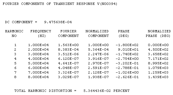

Attached are the simulation results for the circuit in the previous post. Output level was 3V p-p into 33k at 10kHz excitation This output level was with 40mV excitation, so overall gain was 37.5 (31.5 dB).

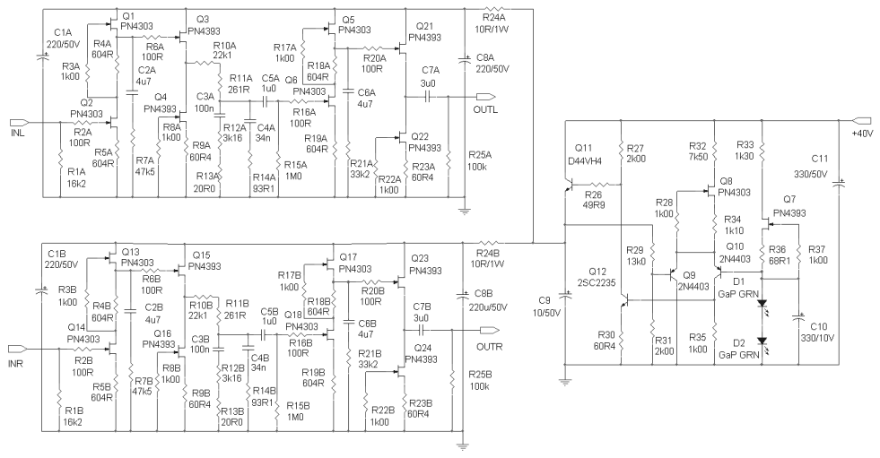

I've done a little more looking at the JFET SRPP preamp circuit, which caused me to revive this thread. A possible solution to the variable gain caused by the variable load presented to the first stage SRPP by the passive equalization network is to use a capacitively coupled fixed load, followed by a buffer.
For some reason, I didn't try that approach when this thread was more alive. Some recent simulations showed that the approach had promise, so I hacked an older board into shape using the circuit shown below. Simulations seemed to indicate that one could get by with a DC coupled fixed load on the SRPP stages to define a fixed gain. In practice, a cacacitively coupled load is needed so as not to disturb the DC balance of the SRPP stages. The SRPP stages used PN4303 JFETs (National) matched for VGS at 2 mA drain current. The output buffers are PN4393 loosely selected for drain current of ~ 10 mA.
This circuit will go into my living room preamp test bed for listening tests. If I like it, it may go to Burning Amp with me this year.
The circuit I just showed was the old circuit - let me see if I can select the new one instead. All the comments in the last post apply - this one is the real deal. What is ahown is two channels of RIAA with a common regulated supply. I'd like to point out that the gain is optimized for MM or high output MC cartridges.

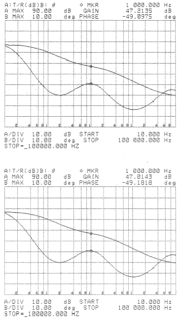

Attached is the Gain-Phase plot for both channels. They match to within 0.2 dB at 1 kHz. It would be possible to tweak them to exactitude by trimming the load on one of the SRPP stages a bit.

Very nice solutions. Now the SRPP loses its Achilles heel. Should perform at its best. More fets are more fets though, and the sonic tests will let you know what weighs more in this circuit. Please let us know more when practically ready and testing. Best of luck with this sophisticated and most original phono!
The 16k input resistor is optimized to damp out the ultrasonic peak in the response of my Grado gold cartridge. I didn't add any input capacitor for the reason you suggest - that there is already some from the input cables. The Grado cartridges are relatively insensitive in that regard - the data sheet does not even bother to specify an optimum load capacitance. There will also be Miller capacitance from the input JFET. The PN4303 is a reall lightweight in that regard, having an input capacitance of 6 pF, and a reverse transfer capacitance of 3 pF.
The PN4303 is only in current production from Fairchild, as far as I can tell. I've been using NOS devices from National, who divested their small signal lineup a long time ago. I wish I could get some of the Vishay/Siliconix parts, but they discontinued the 4303 a couple of years ago, and have recently killed just about all their JFET line. The problem with the Fairchild version of the part is that the data sheet rather grudgingly admits that the part is a JFET and has three legs, and that's about all. Noise is not mentioned. They may work just fine, but they may also hiss like vipers. Having said that, I have some of the recent Fairchild parts, and will try them when I get a chance. I also scored some 2N4303s from Amelco (the orignal version of this part) - real museum pieces in a TO-106 package. I'm really interested to see how they work out.
A reasonable substitute for the 4303 may be the J202 - the specs are similar, and the noise is ok, though not as low as the PN4303.

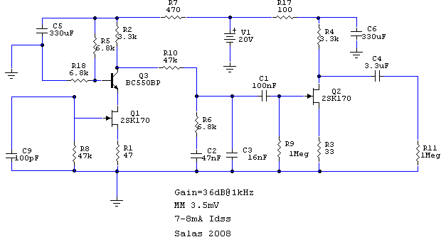

If you insist on using something like a 2SK170, pass on this circuit and try something based on a simple common emitter amp, like the Pacific. One useful frill ifor the Pacific is adding a cascode to reduce the capacitive load on the cartrige from Mr. Miller. Another frill is adding a source follower to the front end so that you have a low (and more or less invariant) impedance driving the passive RIAA network a source follower after the output stage adds peace of mind for driving output cables. . Check my thread "Open Loop Follies" for more on this, as well as the "All American" thread for another approach.
What about this one? Good to drive down to 40k line in preamp loads, or it can take another stage, a simple source follower in its tail for more demanding loads. Can tap off from added source follower's input and have 2 outputs. One buffered, one non.
P.S.
The above circuit I posted ties with your quoted paragraph, that I assume was answering to Radioman62 wanting to use 2SKs. I did not post it as having anything to do with your SRPP concept. Its an example of what you say in that paragraph I hope.
That looks like something to try before going for the more complex amplifiers.
Hmm.. If I only had some more sparetime 🙂
