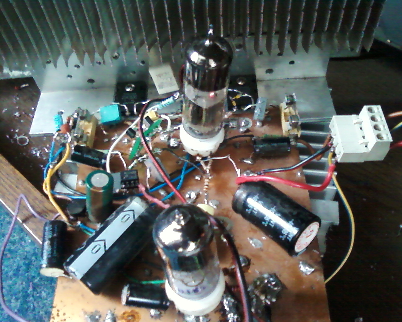

I am very pleased with the sound of this amp, I am gradually step by step applying measures to make the sound as good as I can get it. Without exception so far all these measures involve reducing noise in one way or another.
My outlook about this process is extremely simple - I think about three elements that combine to produce the "sound" of an amp.
1) Harmonic distortion ( 2nd, 3rd and perhaps 4th & 5th )
2) Dynamics
3) Noise ( HD from 6th upwards and everything else that isn't signal )
In this design HD distortion can easily be low enough and have a signature for a good sound.
Also dynamics can easily be excellent because so little compensation is needed and perhaps also because the o/p mosfets can switch current so effortlessly.
This means all I have to work on is noise and there are plenty of opportunities to reduce this.
Mostly reducing power supply noise but also heavy o/p biasing so the first few watts operate in class A and using quality components ( also avoiding caps in the signal path & o/p chokes 😉 )
I'm currently building a full choke regulated PSU - The circuit just like in Hughs PSU except the resistors are replaced my 3mH chokes and the second cap more like 32,000uF - not tested yet but should sound excellent
Warning: choke regulation can cause ringing & go considerably over voltage during turn on if not designed properly so beware ! Choke regulation needs very careful design.
One last tip - I have found that EI transformers sound much better that torroids.
Haven't addressed DC drift yet - unlike almost everyone else it does not really bother me that much but I will have a look at it soon.

Today has been a big day of testing your rail filter between the vas and output. As you know I left space for it on my PCBs and I implemented it as you suggested, 20R and 470uF. I was able to solder a jumper in place to allow fairly rapid switches in and out. I really had high hopes for this mod and actually have been listening with it in place for the last two days. It seemed like better performance was a given and made good sense, even if all it did was remove ps ripple.
Today is the first time I have tried it without the filter and now I am ready draw some conclusions.
First, the reduction in hiss with no input is noticeable. I'm going to be bold and say this is a noise reduction.
However, I significantly prefer the sound without the filter, which is surprising and disappointing! I know I say this with numerous mods I have tried, but it seems to remove some of the foot tapping factor, as does phase lead comp (for me).
Currently I prefer the amp with no compensation of any kind, and no rail filter! This is despite some pretty funky square wave performance into capacitive loads (though no oscillation).
It is possible that I have implemented this differently to you or perhaps my layout is poor, but overall I'm tending to shy away from this mod completely. Maybe now we're just getting into the nitty gritty of our personal tastes?

Hey guys, good news. I realized after this thread that ultrasonic noise was probably much more of a problem than I think. As an experiment, I mounted a 1uF MEF (I'm assuming mylar) between the terminals of my rectifier. Switching noise from the diodes was reduced only slightly, but (d'oh!) it had a nice secondary effect of eliminating spurious oscillation in the amplifier. I saw this odd behavior on the scope but did not know what to make of it, though I suspected it was oscillation. Dunno why I keep forgetting film rail bypass as a possible cure for oscillation.
I've seen this spurious type of oscillation with more than one circuit, and sometimes it coincides with ripple (though not this time), so I figure it is sometimes triggered by rectifier glitches.
The midrange grunge seems to be gone, with a darker background, and slightly more subtlety.
I also realized something: noise can also be caused by the amplifier oscillating, especially in the case of spurious oscillation.
