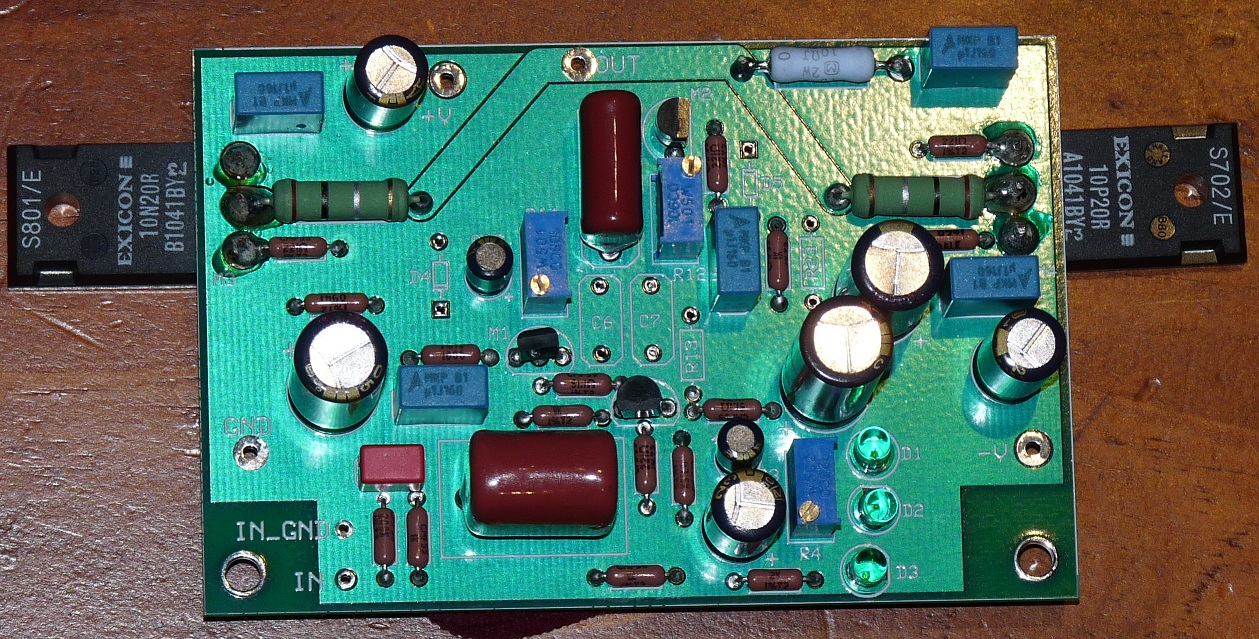

This week's progress
The unused spaces are for phase lead/lag etc and zeners to protect circuit if trimmers should go open circuit. Going to fiddle to see what I prefer on the PCB version. Looks much better in real life - the flash just makes it look plain weird! Included Mike's rail filter too...
Well the pcb is a complete success, the only mistake was a reversed polarity on an electro....boy they go off with a bang!

Nice work Greg,
I look forward to hearing your impressions after some more listening.
All of my audio equipment & components have now arrived from the US so I can take a look at some square waves and make some meaningful comparisons to my other amp and with my DAC.
I'll begin populating my boards next week.
cheers
mike

Great board, Greg, very compact and neat!

Thanks for the kind words. The photo really does not do it justice unfortunately. I think I may make it even smaller as I am leaning towards no compensation whatsoever, so those empty spaces are wasted. As it is the board is only 2.5" x 3.8".
