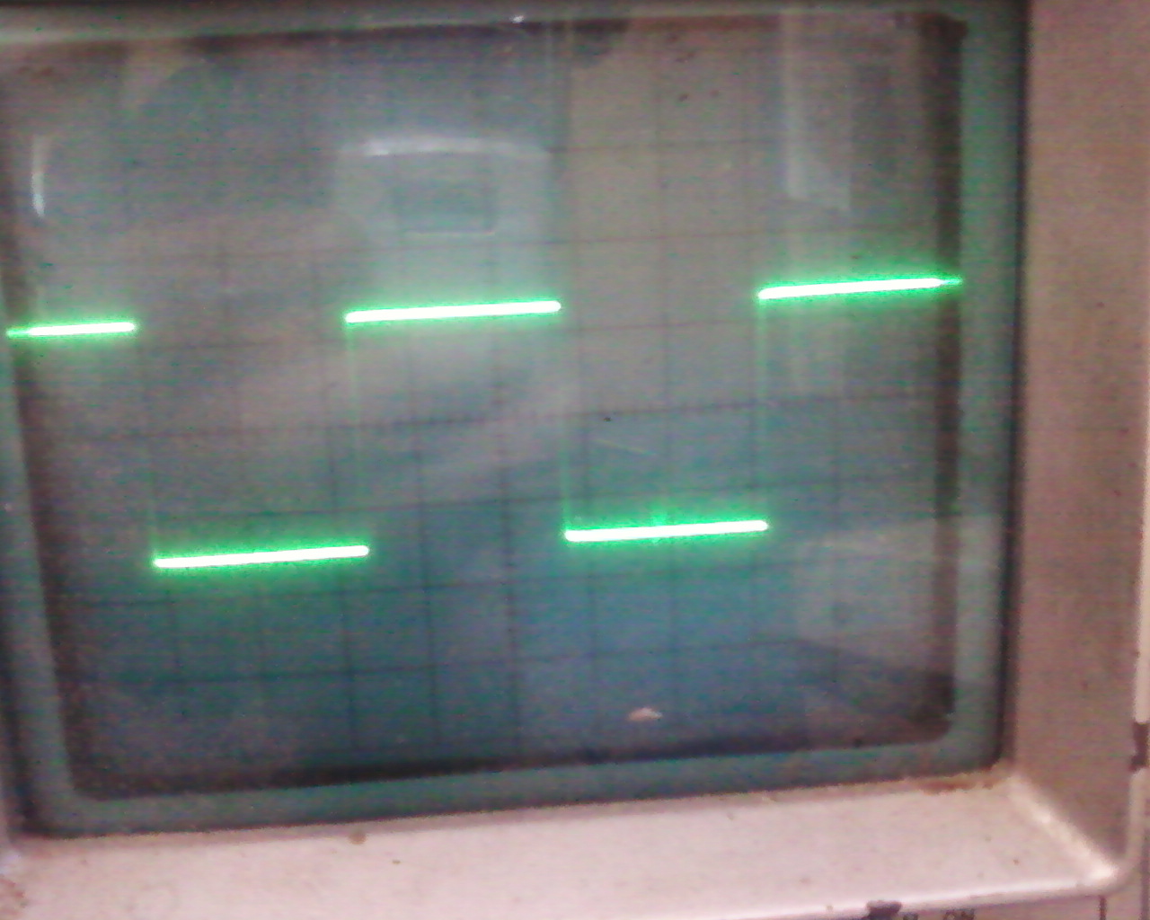

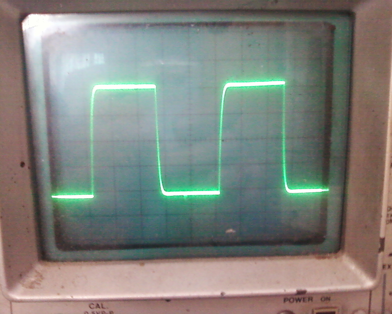

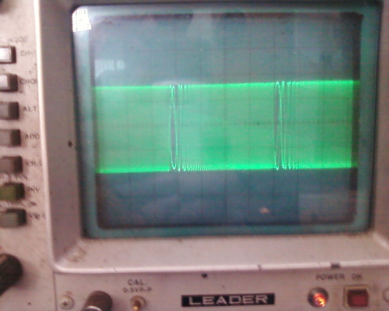

here the pictures of a 20 Khz square wave without a input filter and one with input filter and a sweep from 10 to 22 Khz, there is no overshoot whatsoever, and it sounds very clean with a deep black deepness.
Nice results, but what's the relevance to an amp developed in this thread (since you show no schematic and some tubes are to be seen)?
It is a little offtopic I now, I am busy with a design taken from this thread, I have posted the schematic already, who is nice performing with verticals, there is already a update here but not posted yet,.. but I do hybrides as mean task so why not post it, I hope that more depletion mosfets are coming, she are promissing speacial if made for audio...

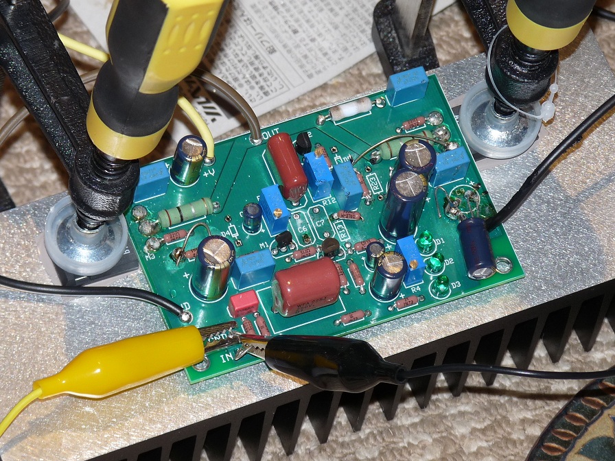

As you are aware, fetzilla is capable of some pretty amazing overshoot, not like the beautiful square waves just posted. However, it does not seem to oscillate and is quite stable. I am a scientist by trade and love symmetry, numbers and order by definition. The overshoot eats away at me every day and i have been trying to get rid of it since the outset.
The truth of the matter is, to me at least, fetzilla sounds absolutely fantastic even with the overshoot. Every modification I do to try and make the square wave performance nicer has an adverse affect on the sound, except perhaps a little miller capacitance.
I'm going to let my ears triumph over my scientific brain, which just hates to see a non-square square wave, and just accept it for what it is. It sounds wonderful with no compensation or other retardant. I'm going to leave it that way, put it in an enclosure and enjoy it.
With no compensation, in its raw form, fetzilla is capable of rattling the windows with bass and provides amazing punch. With a good recording it will produce crystal clear treble with beautiful cymbal clashes. All of this is provided with an energy I've never experienced in an amplifier, and a sense of life that is just wonderful.
So, I'm gonna leave it.
Now, one exception to my findings would be if all you listen to is vocals or pure acoustic recordings. If this is the case, a little phase lead compensation will add some refinement. however, I would only suggest this if you really don't listen to anything else 🙂
Now, let the flames begin! Oh btw, this is all in my opinion, with my speakers in my room. Don't take my word for it, try it yourself!

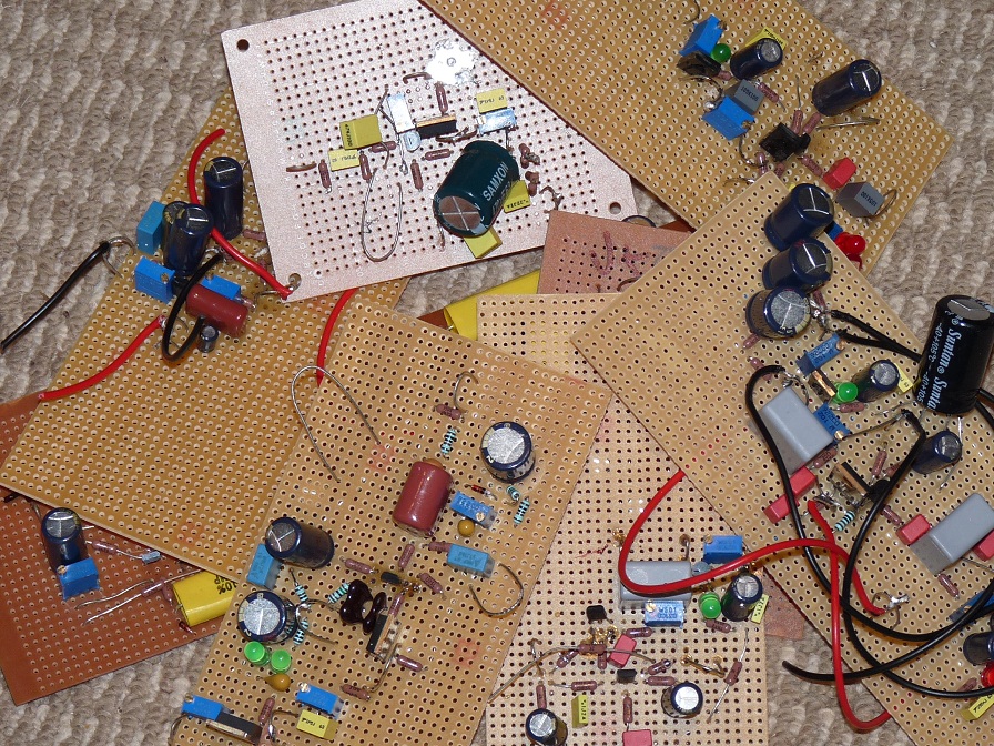

SWF, for groundplane prototyping why not just use veroboard and rest it on top of a blank PCB covered in masking tape?
- keantoken
- keantoken
Kean,
The PCB was never meant to be a prototype! It was meant to be my final version.
I left facilities for all sorts of compensation and filters, but now that I have decided I don't want them I think I'll make something more compact. Nice idea with the masking tape though.
For my prototypes I want to use a PCB covered in masking tape, and then cut out parts of the tape to use as ground connections. This way I can solder the components and wiring very close to the plane. I can even build the same prototype on both sides of the board, for a stereo prototype. However I suspect that having two ground planes right next to each other could cancel the ground plane specific effect of currents "following the path of least inductance". No one has bothered to try and confirm or deny this to me however.
