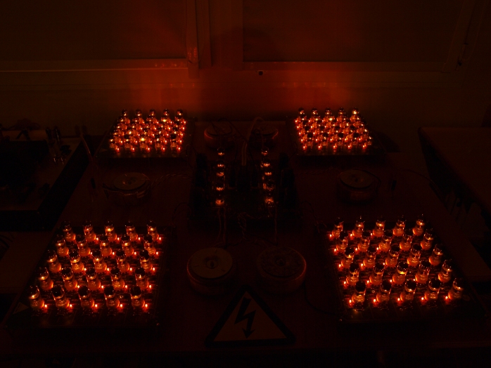

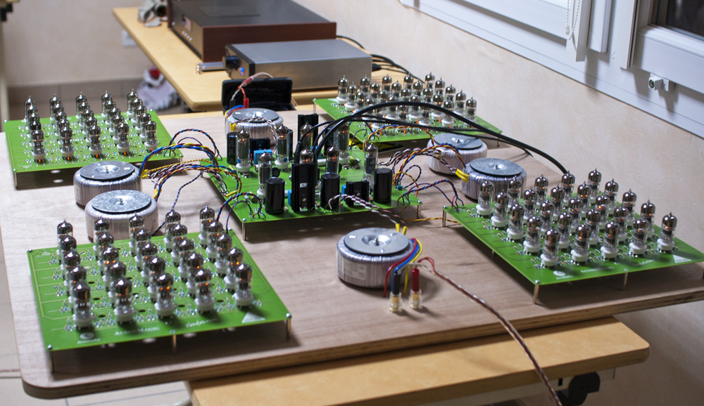

Some seem to disagree with you (for a lot longer than 20)
Standard issue toroidals as OT's=>
p.s. The classic dynamics + refinement combination is 100db speakers with a well designed single ended triode, zero feedback, valve amp.
hi jacco,
Yes, standard toroids will work as o/p transformers, they can have a reasonably flat response up to around 20khz, but they do not perform as well a specially designed o/p transformer and they can only be used in push pull designs because they cannot tolerate DC.
But it is precisely because they have a reasonably good frequency response that they are not so ideal as power supply transformers.
I was using torroids and decided to just try very similar spec EI's before I added full choke regulation.
I was expecting a small difference but I got a big surprise. It was like night & day - much more musical sound and less background grunge.
So my conclusion is that standard torroids aren't ideally suited for either PSU or O/P uses.

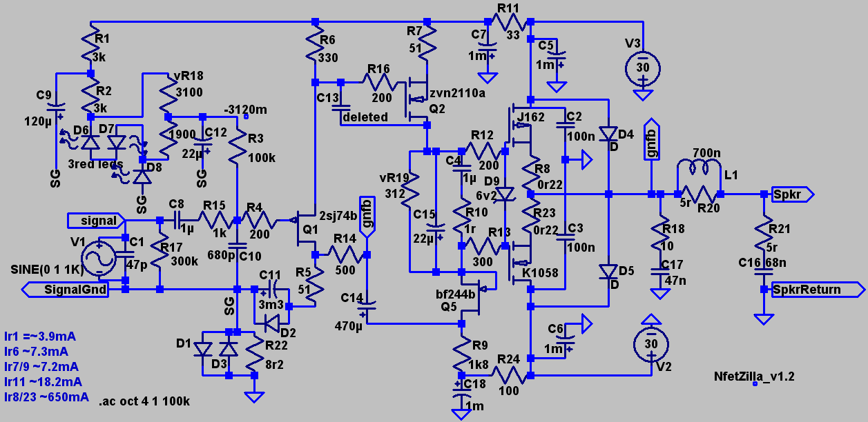

Hi all,
I have the second channel up and running. Still to listen in stereo.
The new version has Re=0r22 and a few other changes/additions. Ver1.2 sch applies.
Q1 50mVgs
Q2 1.72Vgs
Q3 & Q4 1.91Vgs (640mA Ib)
Q5 0mVgs (ccs)
This version starts up from cold to 770mA bias and settles to 640mA bias when hot. No offset runaway, unlike the first version.
The Vdiff between SG & PG is reduced from ~60mVdc to ~30mVdc due to lower LED current.
