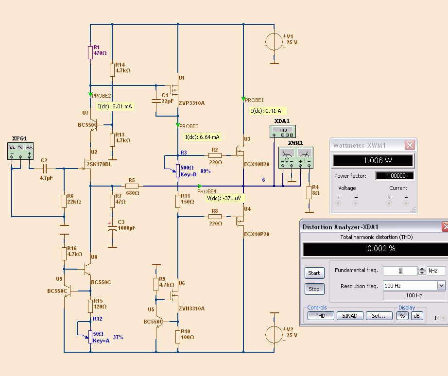

I have been thinking. There are two potential small problems with the single ended input stage:
1) Changing either the load (DC offset) resistor or source resistor will change the current through the JFET meaning the other resistor will need to be changed again - setting the DC offset and current through the input stage will be an iterative process.
2) The JFET might run a little hot.
I thought a way to solve this might be to cascode the input stage with a BC550 BJT (see attached). This means that:
1) The source resistor can be selected out of circuit to give the desired current.
2) Changing the load (DC offset) resistor will not alter the current significantly.
3) Dissipation in JFET is reduced.
4) Because of point 3, more current can be run in input stage.
5) If desired, because of point 4, a larger VAS fet can be used and run at higher current for better performance at high frequencies or paralled ouput stages.
Does this seem like a worthwhile addition?

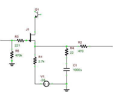

Exactly, swordfish
You setup outside of amplifier a JFET circuit to select source resistor Rsource.
Select current. I recommend 4 or 5 mA depending on your supply voltage.
2SK170 is rated 400mW.
So for a supply of 35V we get 5mA x 32V = 160mW
if the voltage across Rdrain is 3V
JFET works better at somewhat higher current. This is why 5 mA.
In your JFET circuit you adjust Rsource until you get wanted current.
After this you pick Rfeedback for example 20xRsource, for gain x20.
Then try to calculate Rdrain. The resistor from VAS MOSFET gate.
If ZVP3310A maybe VGS is 3 Volt. For IRF9610 maybe 3.8V
3V / 5mA = 600 Ohm
Set Rdrain initially to 600 Ohm.
You adjust Rdrain until zero offset at output.
Can of course be done with a potentiometer.
Hi Lineup,
I like this circuit a lot, but I'm concerned that the jfet might need very careful selection, since with a gate biased to ground, a resistor to ground in the source circuit, and another in the drain circuit straddling gate/source on the VAS, there will be fine adjustment required which will drift with temperature and likely create large offset at the output since the fb network will amplify this drift.
The better option might be to restore DC gain to one by placing a 1000uF cap beneath the 27R resistor. This will then permit you to set R1/R12 to a fixed jfet current (which incidentally fixes the loop gain, all other things being equal) and reduce DC gain to unity, giving tight control over offset.
There will now be a return current from the jfet source passing to the series feedback resistor, R5, and this means you will need to bias the gate of the jfet with a positive voltage around 2V. This does involve a bit of circuitry - suggest a LED and diode with a 2K pot, wiper arm to bottom of R6 - but it will give rock solid offset control and there will be no current flow conflicts caused by thermal drift.
Hugh

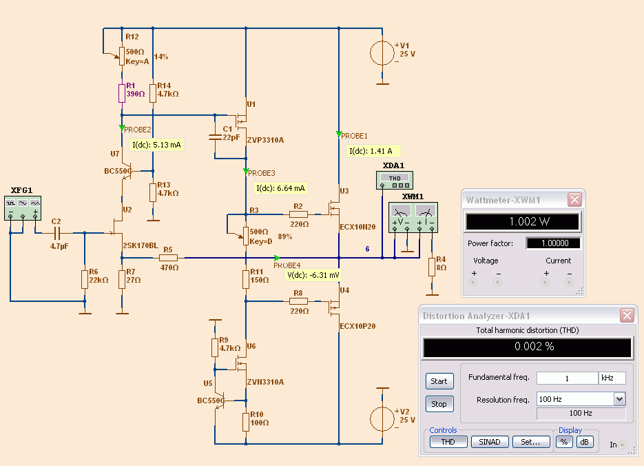

Hi Lineup,
I think you'd get better performance if you stabalized the bias current of the JFET cascode circuit. I think this circuit also adresses Hugh's concern, though I'm not positive.
attachment.php
You could also replace R1 with a current source if you like. Opps, R4 is supposed to be 27 ohms, of course.

HI Lineup,
Thanks for the thoughtful post.
When you vary the gate/source resistor on the VAS to achieve zero output offset, you are altering the current through the jfet. As you change the stage current of the input stage, you in fact change the loop gain, which in turn requires a retune of the lag compensation cap between drain and gate of the VAS. This cap is pivotal to stability, and in fact, to sound quality.
The gate of a jfet is a fragile rose, and easily punched through. Any slow moving DC spike at the input could damage it. Solution: Use a zener to ground, and use a blocking cap to block any DC voltage.
It really is no problem to bias the input gate to a small positive voltage. I do it all the time on my Soraya, Maya and NAKSA amps. And it does not change the gm of the input stage!
Hugh
I added a current source to fix like AKSA and Johnloudb suggested.
A potentiometer modulates to set zero offset.
One 1000uF cap blocks gain resistor from DC.
Also changed feedback resistor values
to set a gain ~15
