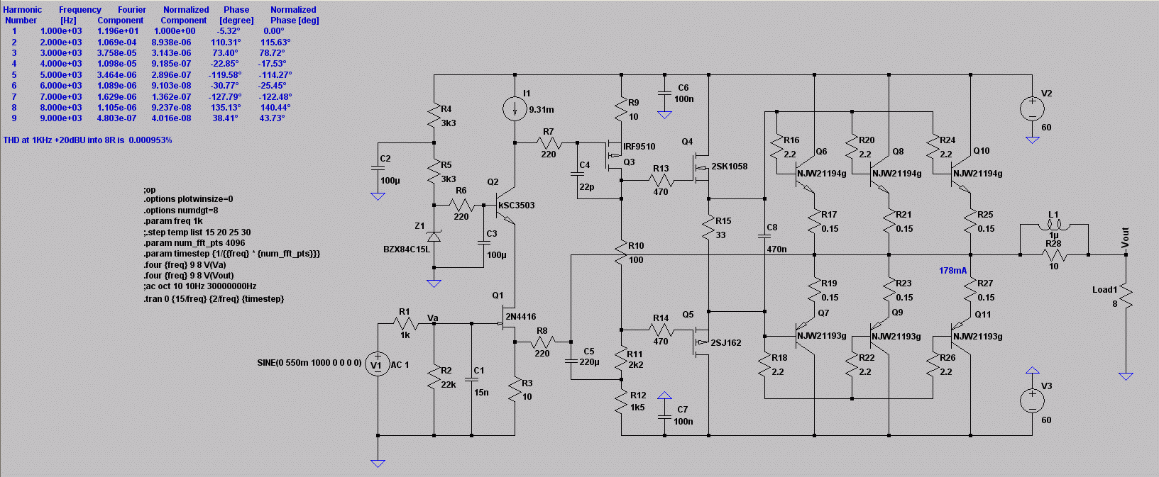

Greg,
I think I would use the 2SK170, and run it at reduced current. I will do a bit more simming and get back to you.
I have found there is about 6dB rolloff at 20KHz because of the high 15nF input filter cap; this should be changed to 1nF.

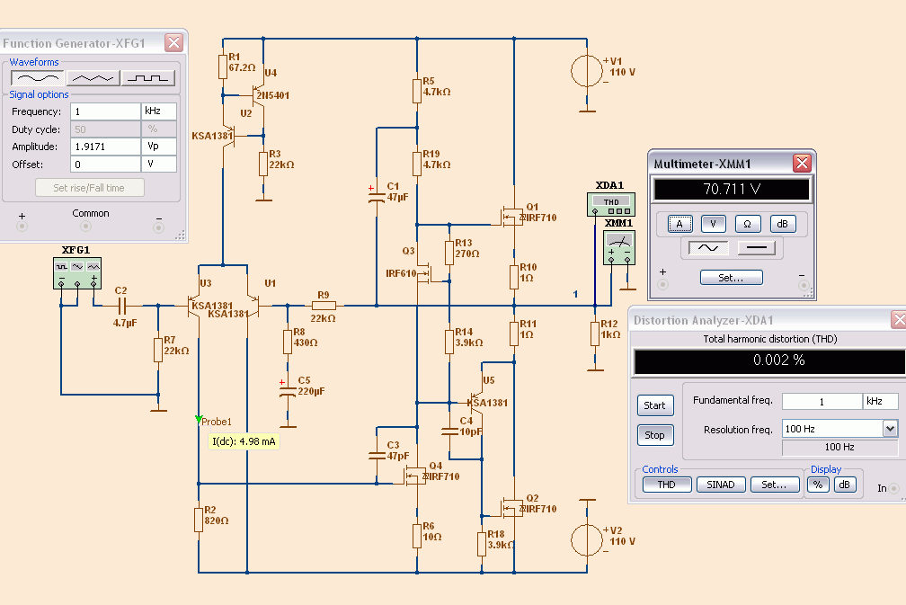

Performance is essentially unchanged, around 0.00095% at +20dBU (13W into 8R @ 1KHz) which is close enough for government work.
The weak point is the extreme tetchiness of output offset control. It depends hugely on the pinpoint accuracy of the current source which supplies Q1, the JFET. This would be best solved with a servo, I suspect.
Thanks to Michael for an excellent design.
Hugh
That fet amp must have another weak point, it may not better than BJT version of Quad 303. And I don't know what C4 doing there? I feel that they (half CFA plus bootstrap) has similar minor result with another old low DF approach.

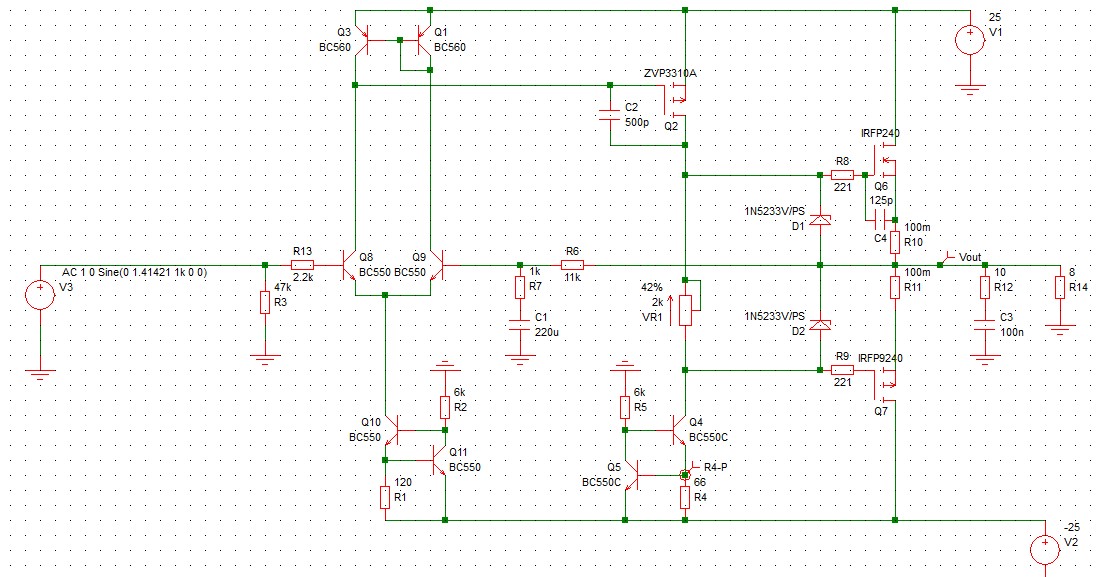

All,
I know this is getting away from lineup's original plan, but this is where I am heading with this design should a decent jfet not present itself. BC transistors are super cheap and plentiful unlike 2SK170.
I don't have models for the laterals so I had to use IRFP240/9240. The actual amp will use the laterals I mentioned above, and run about 1A of bias. I had to use a fairly large miller cap to prevent HF oscillations.
What do you think?

The circuit will work just as well.All,
I am happy you soon will have a very own amplifier.
The laterals you have are real great devices.
BC550C and BC560C are fine transistors. Low noise and high gain.
The MOSFET vas. I would have liked you had one ZVN3310A at bottom.
But the BC550 will work.
The nice thing is is only one potentiometer to set the bias of the laterals.
I think you get away with only 5mA current for the VAS.
Dont forget to add a RC filter at input.I had to use a fairly large miller cap to prevent HF oscillations.
I use one 1k resistor in series with input
and after that resistor a 220p capacitor to ground.
Code:
--1k--
220p
- JFET input, MOSFET VAS, LATERAL output = Perfect!!
