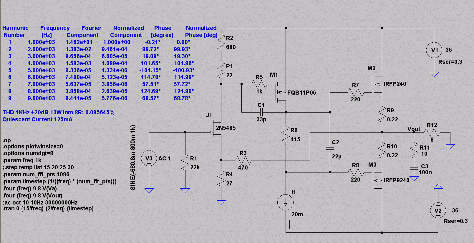

Here's my attempt at a schematic. The input device and VAS are the only suitable models I have; not too sure about voltage ratings.
However, I have adjusted input offset to achieve zero output offset, and set the quiescent to 125mA. You could go higher, of course. I have used a simple resistor to achieve this, rather than a Vbe multiplier.
I've added base stoppers, and used the 33pF lag comp you suggested.
Performance is not wonderful because loop gain is not high, will examine this later. Most of the distortion, however, is H2 and H3, starting around -60dB using +20dB as a reference.
Hugh
On the JLH SCA amp replacing the equivalent of R2 & P1 in your cct, with a current source worked wonders for performance - both in spice and in reality - I used that arrangement for a few years.
not sure if it would work here . . . but might be worth a try
mike
I believe that the performance is vastly determined by the capacitance of the second stage fet.. hence my suggestion of keeping the Zetex fets with very low capacitance..and here with the limited voltage rails.. 10 mA for driving the output should be possible...Else resort to laterals...
The current could also be distributed through a current mirror..

Yes, makes a lot of sense, since it raises the loop gain almost an order of magnitude. This could be done easily but lag compensation would need to increase to preserve stability.
However, more feedback, while it reduces THD, smoothes FR and lowers output Z does create a longer spread of artefacts.
This circuit looks to have a loop gain of around 67dB, computed by examining the ratio of output to differential voltage across input and source of the input device.
I'm fairly sure small degeneration on the VAS would work well, but I'm limited in my models. You might note I've increased rail voltage for a bit more swing.

If you use laterals you can use one adjusted resistor for bias.
You also, which MiiB mention, use Zetex ZVN3310/ZVP3310 TO92 for VAS. Lower capacitance.
As laterals only need 5mA bias at the Gates, in VAS stage. Now is quite high for IRF240/9240 = 20mA

1) What are the pros/cons of lineup's VBE/VGS multiplier versus the resistor you have used to set the bias? Also, what purpose does the parallel capacitor serve? Does using a fet based VGS multiplier provide better temperature stability?
2) What current are you running through your input jfet? I see you have used the same source resistor as lineup...does that value provide enough current for your chosen device?
3) Is the output zobel really required, especially if run in class A?
Your advice is appreciated!
Greg.

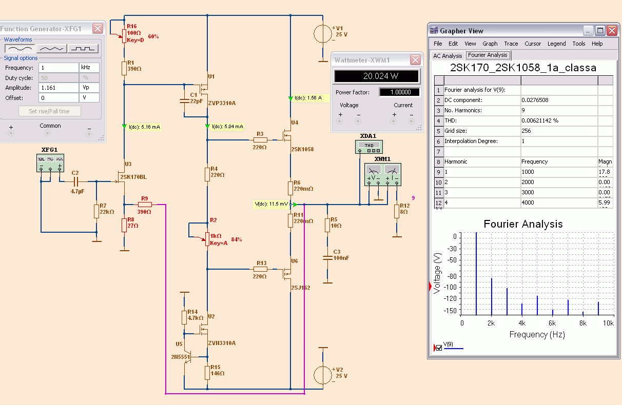

My models in SPICE shows some better behavior.
One thing I found, too, is the harmonics are mostly H2 followed by some H3.
My models for latest schematic below:

THis latest schematic below is for Class A and laterals 2SK1058/2SJ162.
Shows THD 0.006% at 20 Watt. (Max is about 25 Watt with +/-25V supplyy)
Note especially H2 harmonics dominant. At rather high level.
I recommend you use those transistors for lateral amplifier.
Zetex ZVN3310A TO-92
Zetex ZVP3310A TO-92
And run second VAS stage with those at 5mA
with only resistors to set bias.
The latest schematic

This looks very nice. I like especially the feedback insertion (I'm a tube lover and it's mostly done like this way in tube amps). Although it is a pure voltage feedback in my opinion. The output voltage is divided and lies in series with input voltage (cause it is applied at the source of the jfet). Is there the possibility to apply the feedback at the gate of the jfet ? This would be parallel applied feedback (and this is the one I would call current feedback)
And another questiona bout the circuit in Post 29. If I want less Power cause of lower supply voltage, what do I have to change ? Only drain, source and feedback resistor of the jfet ? And if I use better mosfets (the zetex vor the driver and SEMELAB Laterals for the Power Amp) do I have to change anything in the bias topology ?
Lineup. What version of multisim are you using?
How did you import those models into multisim? Could you please discribe the process or give a link to the information you used to get the models to work in multisim?
I have had no problem with all the other spice programs I have used but importing models to multisim has got me beat... so far.

1. Very little sonically, except that Vbe multipliers tend to overcompensate bias creep with temperature on mosfet designs.
2. I'm using about 5.5mA, same as Lineup. The current through this device should be set however by R2/P1, rather than R4, so the jfet should be running well below Idss.
3. The output zobel ensures that the stage is loaded at very high frequencies, and it certainly provides additional stability for AB. In Class A, maybe no need, but frankly I'd want to build it and test it.
