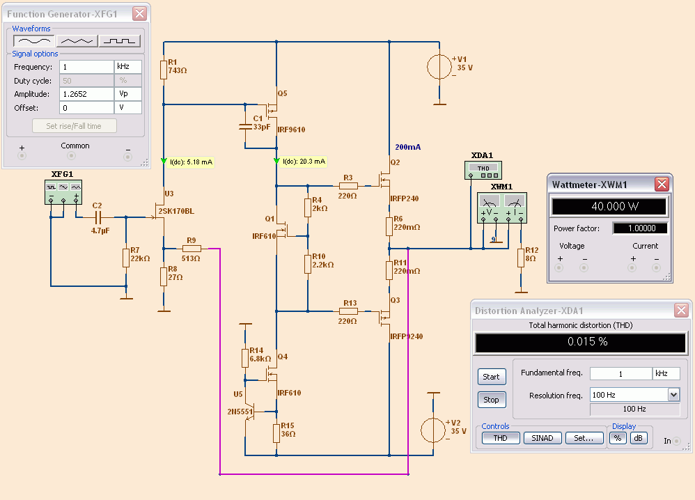

JFET HEXFET HEXFET
This is slightly different version to previous.
Can it be more simple than this to get hifi?
1. One JFET 2SK170 with current feedback
2. Two IRF610 and IRF9610 for volt amp
3. Two IRFP240 and IRFP9240 for current out
Sum 5 transistors!!!!
The amplifier makes like 50 Watt with THD ~0.050%
Image shows 40 Watt out at THD 0.015%
At 1 Watt THD is so low as 0.00068%

Lineup,
Can I ask why you need Q1? You could use two LEDs and a couple of diodes and a pot, because you don't have a critical bias issue with temperature using hexfets since the tempco is negative above about 200mA.
Otherwise, I think it's a terrific design, hats off!
Hugh
Hugh
Hugh
Your word is always something to respect.
Do really IRFP240/9240 have negative tempco above 200mA.
I thought it was only laterals.
If it is possible to simplify the bias circuit, I am open for this.
On the other hand, using this VBE-multiplier does not hurt.

I would say we keep Q1.
Because it is, I think, more simply.
Otherwise, if we do not use zener, there will be plenty of diodes and LED and trimpot to replace it.
I will post a Class A version with +/-25 Volt for you
