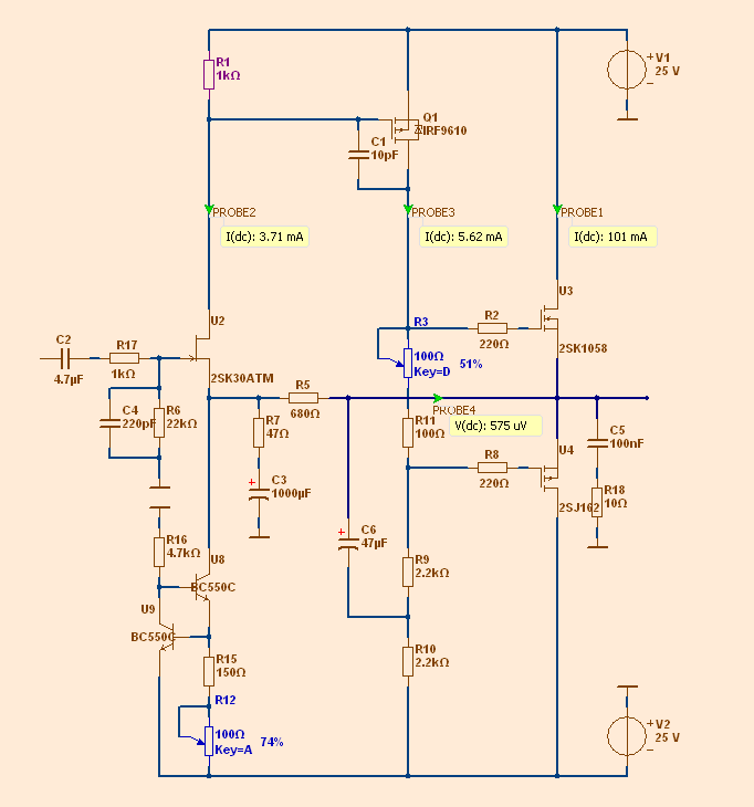

It's looking good. Anything which has H2 at -83dB and H5 at -123dB gets my vote; that would sound marvellous, very clear.
However, I wouldn't use a zener to set the cascode voltage. I'd be inclined to go back to the resistor divider, and add a 47uF cap between cascode base and ground.
The design is excellent, but will require careful selection of jfet since the gm of this device contributes hugely to loop gain, which should be prescribed to fix the lag compensation at 22pF, assuming that is your optimum dimension.
The most important aspect is that both jfets are the same and therefore you finish with very similar CCS calibrations for zero output offset.
Aside from that, you could add a bootstrap in place of the VAS CCS, which will increase H2 and H3, both musical, but nothing more to add. Very nice circuit, build and listen!

As a matter of fact I have already gone back from zener to a divider 4.7k/4.7k with an electrolyt 47uF.
Me too, do not want to add zener noise into the circuit.
Or have to counteract such noise.
Bootstrap is an option. It is in line with keeping the amplifier simple.
I will try and see. swordfishy has already tried it in sim.
Okay, Fetzilla, like metal suggested will be the name.
Hugh has mentioned the possible use of a bootstrap circuit for the VAS - similar to the one attached. He has been doing this a long time and I respect his thoughts and design ideologies.
It simulates at twice the distortion (but still very very low) but it offers a few benefits:
1) The extra distortion is of the nice low order variety so it would sound nice.
2) Two less active devices to worry about.
3) Reduced chance of oscillation problems.
Having built a JLH with a bootstrapped VAS, I can confirm these claims about simpler circuits sounding good.
Anyway, I'm not saying we have to choose one or the other at this point but it's an interesting and elegant option for the circuit.
I like the idea of bootstrap.
And Hugh says it could have influence on the harmonics in a good way.
I see you have already tested it in sim.

Here is a danspy 2SK30ATM version of FetZilla
2SK30ATM gives a little more distortion than 2SK170.
But still rather low dist at 1 Watt: THD 0.015%
It will work good.
I have added bootstrap with capacitor 47uF
I use output 2SK1058/2SJ162 as in original circuit.
It will work good.

I like the look of that circuit with the bootstrap VAS!
If this circuit makes less than 1% distortion at 20kHz and 10W in real life I'll be very happy.
Have you noticed with these circuits when simming them that the distortion does not seem to change much between 1W and 20W? This is what I am finding and it is the first amplifier I have simulated and had such a result.
Something I like to do is sim the THD at 20kHz too, as this is when we really start to see the effect of the fet gate capacitance come in to play, and in fact sometime more current in the input and VAS stages may create more distortion at 1kHz but cause significant improvement at 20kHz. I wonder what will prove to be the best compromise?
How did you arrive at 47uF for the bootstrap capacitor? Did you try any other values?
Thanks again, I am enjoying seeing this progress.
