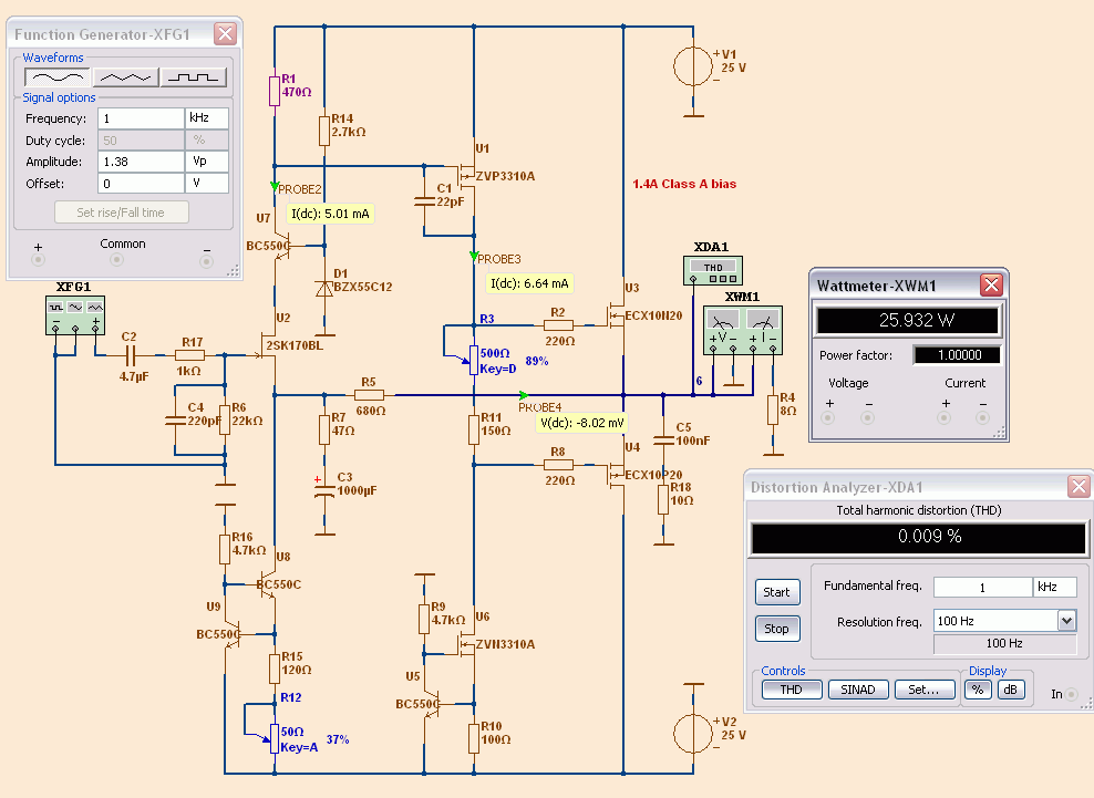

What do you think of my latest circuit?
You really think I should put a zener from gate of 2SK170?
I have seen many circuits without it.
DC blocking cap is my standard at the input.

It turned out that +20dBU is like 13 Watt RMS into 8Ohm.
I have a Wattmeter in my circuit.
Note: The circuit runs in Class A, biased 1.40A.
Because swordfishy wants a Class A amplifier.
The circuit can absolutely run in Class AB with no bigger difference, I think.

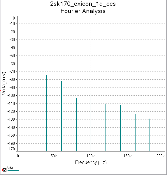

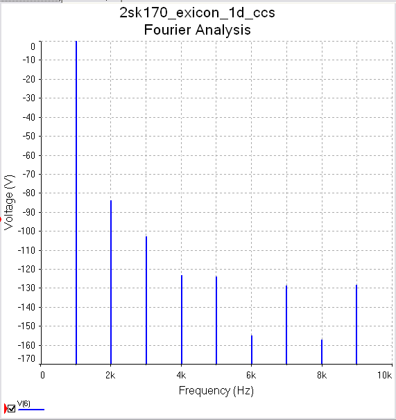

Harmonics shows 2nd order and 3rd order are dominant
At +20dBU 1kHz is THD 0.006%
At +20dBU 20kHz is THD 0.022%
See diagram 1 for 1 kHz
See diagram 2 for 20 kHz

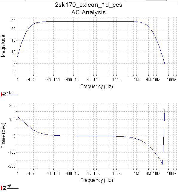

AC Analysis.
-3dB at above 4MHz.
Think we need an input filter ....

The latest circuit with input filter 1k+220p.
And output Zobel 100n+10R. And Zener 12V.
Highest output in 8 Ohm before distortion rise is 25.9 Watt
See schematic.

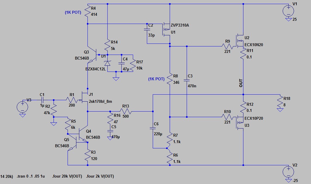

Lineup,
Looks good. Thank you. The only addition I would make is to put a 10k resistor and 47u cap across the Zener to reduce noise and maybe a cap across the bias resistor. No need to change the schematic though - you must be sick of simulating! I will try to get microsim so we can share models more easily.
I think the ccs version is the one to build as it will be a little bit more controllable and predictable.
The 3310 is very good but the 9610 in recent years has changed and now has a significant non linearity. Nelson Pass has mentioned it somewhere - I will try to find the post for you. So if we ever want more current we may need to find a nicer device.
I think you are right though, the laterals don't need much current, which is good. Do you think we should add a gate capacitor to the n channel fet to balance the gate capacitance? - like here:

Lineup, SW,
It's looking good. Anything which has H2 at -83dB and H5 at -123dB gets my vote; that would sound marvellous, very clear.
However, I wouldn't use a zener to set the cascode voltage. I'd be inclined to go back to the resistor divider, and add a 47uF cap between cascode base and ground.
The design is excellent, but will require careful selection of jfet since the gm of this device contributes hugely to loop gain, which should be prescribed to fix the lag compensation at 22pF, assuming that is your optimum dimension.
The most important aspect is that both jfets are the same and therefore you finish with very similar CCS calibrations for zero output offset.
Aside from that, you could add a bootstrap in place of the VAS CCS, which will increase H2 and H3, both musical, but nothing more to add. Very nice circuit, build and listen!

It's nice to hear someone say that, but I am actually quite new to all of this. I think you have been doing this a lot longer and know a lot more than me. But I'm learning fast and have built quite a few amplifiers for the time I have been interested in them Some of my theory is still quite weak but I'm just throwing in my 2c wherever I can apply some practical experience.
As for the gate capacitor on the n channel lateral, yes I think your idea of using the difference between the capacitances on the datasheet would be a good start. I tried simming with 200pf and it made no difference, but Rod Elliot's amp is apparently unstable without it.
This is one benefit to using class A - no switch on or off, so reduced chance of gate oscillation. So maybe no need to worry about this unless you want to run AB.
The other option is to use assymetrical gate resistors which may be a more elegant and less troublesome solution (use a larger resistor for the N channel device).
Regarding gate resistors - Nelson uses 221R, and I am sure he has fiddled with this value for many years so that seems like a good start. In any case I can't see 100R either side of 220R making a substantial difference to the performance at typical audio frequencies. I might fiddle with this a bit in the actual circuit - pcb layout, etc will be what determines the minimum value.
Hugh has mentioned the possible use of a bootstrap circuit for the VAS - similar to the one attached. He has been doing this a long time and I respect his thoughts and design ideologies.
It simulates at twice the distortion (but still very very low) but it offers a few benefits:

Does a regular cascode sound as good as a well implemented "hawksford" cascode ( where the voltage across the i/p device is held constant even when the signal is applied ).
To me, logically the hawksford cascode is purer and I have used it but I never did a listening comparison.
Thanks Hugh,
But as I understand it the effects of the target of this idea i.e. constant power across a device, even during in the presence of a signal, are not really possible to evaluate in spice.
I have checked that constant power is achieved in spice in other designs but I think this one would have to be assessed aurally.
But I look forward to hear what you find to make sure that this idea does not mess things up in other respects.
cheers
mike
cheers
mike
Hawksford Cascode, with 1mA CCS feeding 1K resistor between base of cascoding 2N5210 and source of jfet:

And standard, as in Post #154:

Conclusions?
It's clear to me that you are right; a listening test, switchable, would be preferred here. On the face of it, MOH (Malcolm Omar Hawksford) cascode would have lower distortion, but only for H2, which is not that important and arguably might even improve musicality by 'warming' up the sound.
Hugh
