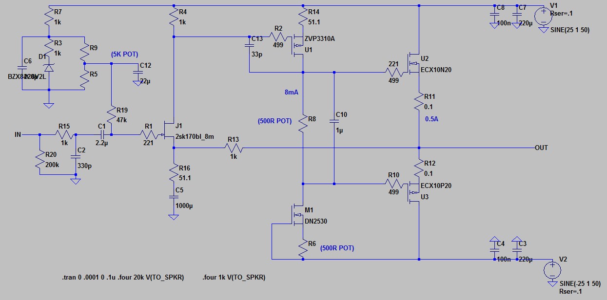

JFET input, MOSFET VAS, LATERAL output = Perfect!!
The layout follows exactly Greg's final, the stable version - with one exception:
I have changed the Zener used for the input biasing to two LEDs in series.
It can compete with Hugh's design, when it comes to size and price.
It measures only 95 x 75mm in size and costs about 11€ per PCB (Quantity = 10 PCBs).
swordfishy Greg's final stable circuit which is the model for your PCB.
But we replace zener with 2 red LED-diodes
I show the circuit here. Regards Rudi :)

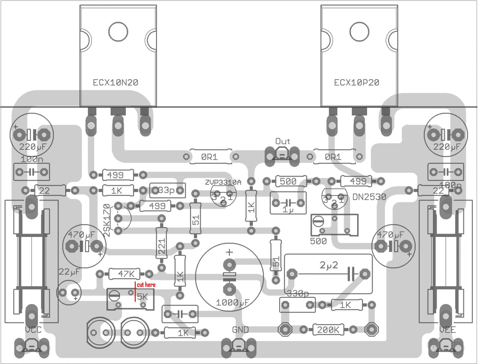

... and this is yet another layout of the Fetzilla - in its pre-final layout status.
I call it: "Poor People's Fetzilla". :p
http://www.abload.de/img/topviewxcbr.png
It can in no technical way compete with Hugh's high-sophisticated design - for sure.
My German DIY-friends would like and have a group-buy for this PCB (they would even have it "as a kit: PCB + 5 transistors").
If there is some interest in this forum as well, I will ask a DIY-friend to organize this group-buy.
Please tell me: are you interested in the "PP Fetzilla"?
Best regards - Rudi_Ratlos
P.S. The quality of the PCB will be the very best, that you can imagine: 2mm thick PCBs, 70µm copper traces, gold-immersion, silkscreen ...
well using ohms law if we have 7mA i/p bias current and it all flows through a 1K FB resistor and if the o/p is at zero then we have 7V across the cap - that sounds ok to me.
Interestingly when I tried to check this in simulation, my first AC coupled simulation effort, it oscillated violently and nothing I could do would make it stop - I never once had this with the DC linked one - I wonder why this would be

Hi Rudi,
Well done, nice layout.

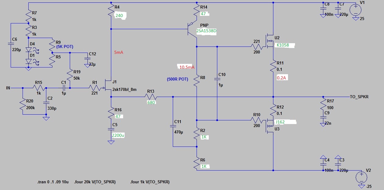

I have build one of the Swordfishy's versions which uses two LEDs to bias the JFET. I noticed a potential error with your PCB: the connection of the wiper of the 5K trimpot. In other word, R9+R5 together make up the 5K trimpot.
C6 is a 220uF, so it should be a electrolytic capacitor, it shows a film cap in your layout.
One more suggestion:
Make space for a three-LED string. I tried to run a higher bias current thru the K170 but I ran out of bias voltage because I use two LEDs.
Cheers, Stanley

Yes 3 LEDs for the input bias is better.
Feedback cap always has a positive voltage across it. Non polarized is fine. I use good quality panasonic fc caps. Work quite well.
Depletion mode MOSFET ccs is better for many reasons. I posted many of these a page or two back in the thread. The only negative is that it is not as perfect as a current source when compared to a bjt ccs. However it is more than adequate for the intended purpose and has many advantages such as very low noise and low latch up.
It is far closer to being a perfect current source than a real life bootstrap, and just as simple. Very good sonically too.
Actually in Greg's final Fetzilla the current is ~2.75mA
which makes 2.75Volt across the cap.
This way 2 red LED can be used to create 2.75V.
(The drop across 2 LED is like 3.3 or 3.4 Volt)
Yes, it depends on the actual value of VGS in the MOSFET.
For IRF9610 we can count on ~3.8 Volt VGS
In that case we better use 3 LEDs.
My simulation with your final schematic (Drain resistor 1k) shows 2.76mA
Drain resistor 560 Ohm gives 4.92mA
Drain resistor 680 Ohm gives 4.05mA
Drain resistor 820 Ohm gives 3.36mA
Drain resistor 1k Ohm gives 2.76mA
This is with the ZVP3310 model in spice
