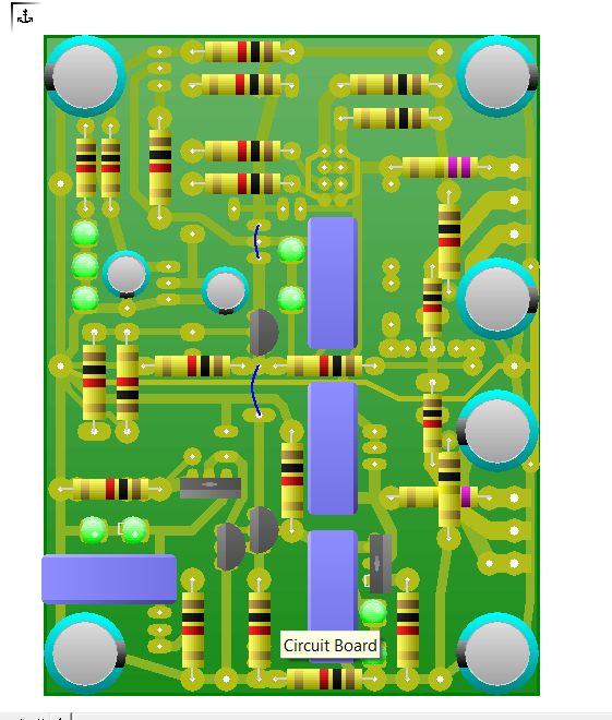

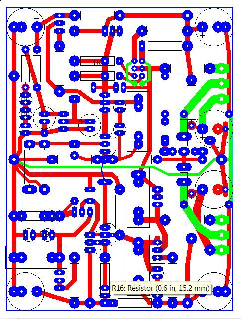

I also have been tweaking my board design and now I think I have all the elements I need to try all the versions of this amp that I am interested in.
I tried to ensure that the large o/p current paths were in equal & opposite directions so that the electromagnet fields would not interact with other stages of the amp - so I am quite happy with this part.
I'm not so sure about how I did the earthing - but I've made a a lot of amps like this and I didn't experience any problem.
On my board i/p cap, rectifier diodes & main PSU filter caps are off board and some components are on the solder side.
This is an ideal board for anyone curious to experiement with many different versions but particularly DC linking.
This is the feature set for this board:
AC Coupling with caps biased.
DC Coupling with non servo offset control.
Lead and / or lag compensation.
Pads for either irf9610 or BD140 or ZVP3310 etc VAS .
Possibility for 2 x zvp3310 or 4424 as VAS.
Bootstrapped or CCS VAS.
Pads for hawksford cascode.
o/p snubber.
R C filters both legs.
Extra RC filters for AC coupled biasing or DC offset control.
multiple pads for different sized caps.
Features not included:
DC servo
Cascoded VAS
I can get these boards for about £10 each and less if I'm patient about delivery
I have the feeling DC linking isn't a hot topic for many here but if anyone is interested - let me know.
