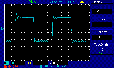

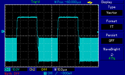

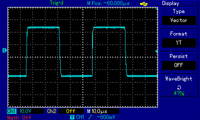

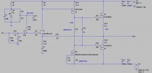

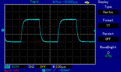

Edit: I'm sorry there is an error in the schematic below. I have a 221R gate stopper on the ZVP3310A
Doco, Kean, thanks for your comments. I will try decreasing OLG even further tomorrow, though it's already degenerated quite a lot!
In the mean time I have a new circuit with amazing potential I think, though I have not yet listened to it. It uses some pretty neat devices that Hugh came across - DN2530 depletion mode mosfets. The beauty of these is they can self bias and hence make a very simple and fairly latch proof VAS current source.
It looks very promising. Stability with a load is fair. Bandwith is excellent. So far no compensation.
Problem is, I get the exact same oscillation as before on the negative half cycle when the amp is unloaded. Anyway, here are some pictures.
From left:
1) Schematic.
2) 20kHz square wave into 7.5R
3) 20kHz square wave into 7.5R + 100nF.
4) 100kHz square wave into 7.5R
5) 20kHz square wave unloaded.
Now, a question for you. Given that it seems reasonably stable into a normal load, do I need to worry about the oscillation at all? It does not occur until about half power or so, and I imagine would not occur with a speaker attached.
100pF of phase lead did not help.
100pF of miller capacitance did not help.
47pf and 100pF of capacitance in parallel with the feedback resistor did not help.
Will try other values and listen tomorrow. Will also play around with gate resistors too, just in case, though I don't think that's the cause.
Thoughts?

One annoying thing about the schematic I posted above is that a simple 1nH + 10R zobel on the output would clear that square wave right up and make it behave perfectly well with speakers attached...problem is it's oscillating with no load attached!
Hmm, what on earth is going on?
Is it really an issue anyway given that it won't oscillate with a reasonable load attached?
It's tempting to leave it as is and add a zobel to clean up that ringing and not worry about it!

Leave the zobel in place.
Yes, it's marginally stable. You don't want that.
Increase your Gate Resistor to 330 ohms or 410 ohms. Should help to stablise the amp.
Does it oscilate with something like 100 ohm to gnd....?? If not then that could be what the doctor would order....(they seem to treat symptoms, not curing the disease)...🙂
would it be possible for you to post the depletionmode mosfet model..?
One thing that comes to mind.. is how robust is this circuit for LSP generated back emf...??
I have seen amplifier with two local feedback blocks that totally separate the voltage amplification from the current output stage....
