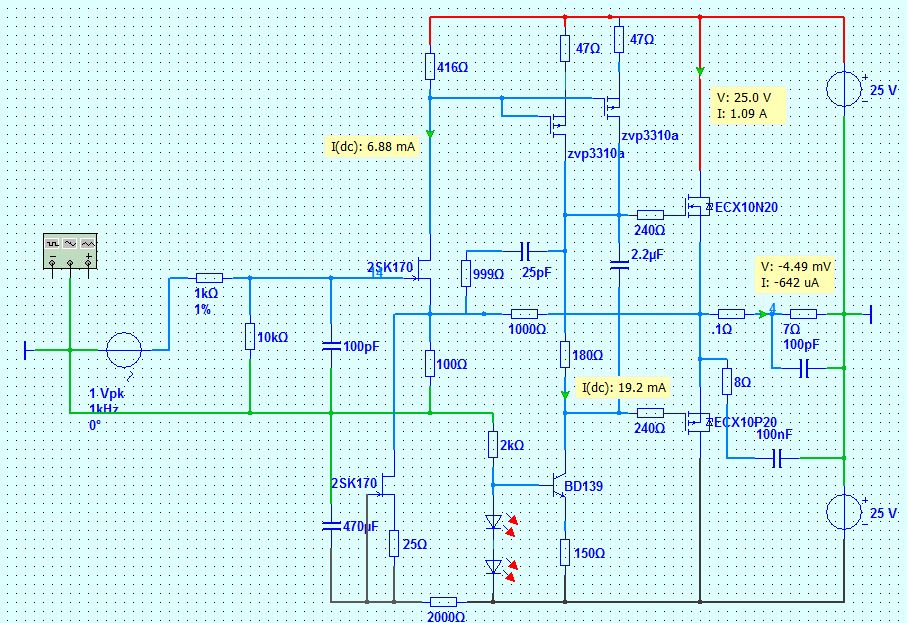

Greg & all,
I took a look at the zvp3310a in my DC version and tried to engineer it for maximum stability with least compensation so after checking I added all the features that make the amp fast & stable.
For me there where some compromises - higher value FB resistors are good for stability but bad for DC drift and I am still hoping to manage without a servo.
Also higher value FB resistors - in my design - reduce 1st stage current and I found that higher current helped with stability so I had to add a CC Sink to a filtered neg sub-rail.
High current in the VAS also helps so I went with 2 x 3310 - sorry Greg I can feel you cringing but I think it will be OK - I will build my prototyping board so both options are available.
I decided to allow some ringing with 100nF with no i/p filter but could but could not do away with compensation completely as Nelson has in the F5 - which for me is a work of elegant genius - but I managed to reduce lead compensation to a minimum and with do away with lag compensation.
With a modest i/p filter 100n hardly changes the square wave.
I hope as before that spice & reality are not too far apart.

Keantoken,
I have tried up to 330pf in this position with no luck! Crazy huh?

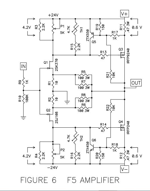

Yes, I remember you were advocating a CCS earlier in the thread but I still am not sure why. Can you explain why you prefer this.
Mr Pass seems OK to drive i/p Jfets straight into the FB network only ( see attached F5 diagram ) so I wonder what your reasoning is.
For me it was simply to combine higher i/p stage current, with higher impedance feedback on this particular design, but apart from this I see no objection to it.

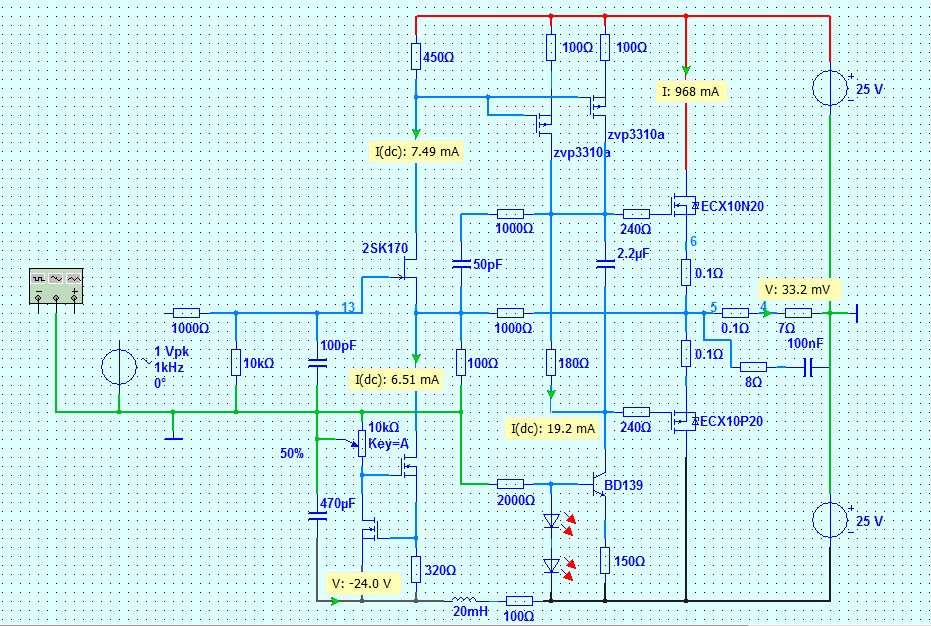

MiiB,
mmm - but the only way to truly control the current through the i/p jfet is to have a mosfet VAS and a CCS as the i/p Jfet drain resistor - this way everything is controlled except HF modulation via the VAS mosfet capacitance or miller cap.
Otherwise with the CCS below the Jfet, the FB network in parallel to the CCS is still modulating the current through the Jfet.
mike
mike

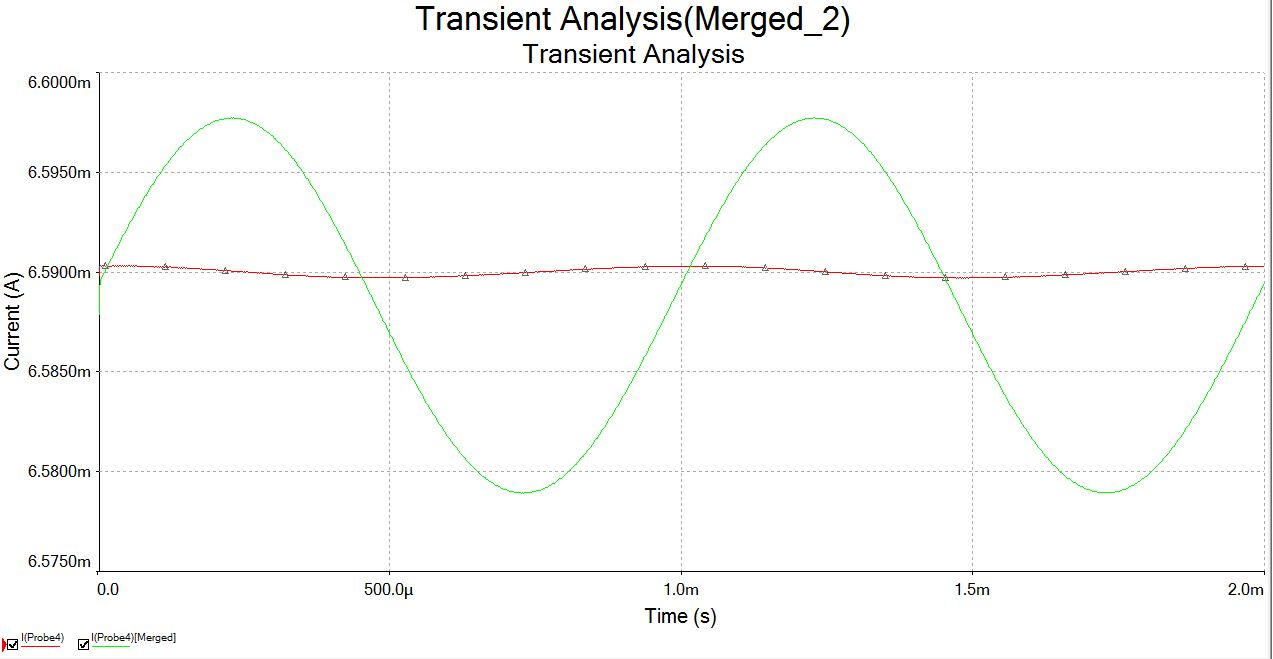

See below currents:
1) with CCS below Jfet from my most recent dual 3310 cct ( green )
and . . .
2) with CCS added as drain resistor ( red )
0.5 Volt i/p @ 1Khz
So, if controlling current is important to you then the i/p Jfet drain CCS is the way to go - however this is not conducive to my goal for this recent project of enhancing stabilty.
( p.s. even more interesting is the phase shift between the current plots )

but I changed the circuit between tests - the node remained the same - so this was the only way in this instance
Correction
The above statement is incorrect
I should have said that the current in the Jfet is entirely dependant upon the slight changes in voltage across the Jfet drain resistor + a tiny amount AC leakage through the FET VAS device.
With a CCS in place as drain load only this AC leakage current remains which is the difference shown in the graph.
Adding a CCS below the Jfet makes absolutely no difference to the current changes through the Jfet but it may favourably increase the ratio between the total current and the variations
Otherwise with the CCS below the Jfet, the FB network in parallel to the CCS is still modulating the current through the Jfet.mike
Subject to any further revelations from Greg and the fact that works in real life and sounds as good as Greg says etc, this is the final circuit that I will aim for.
This includes measures for natural cancellation of DC offset based on the same technique that TimA used and Hugh's explanation of the chief mechanism for drift in this design - thx 🙂
I'm still awaiting some bits so for now I'll build with 9610's and a few other differences.
