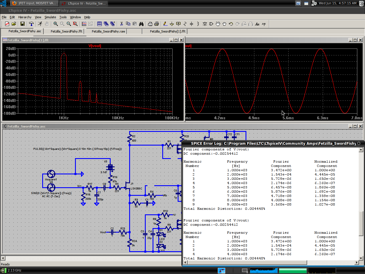

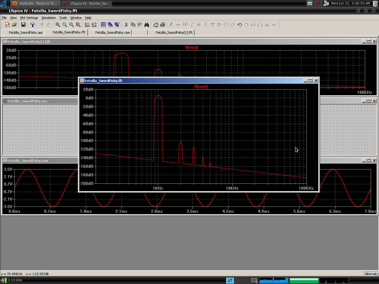

The first image is the THD and FFT from a version with the bootstrap Jfet CCS. The second image is with the bootstrap removed and offset re-corrected.
Instead of odd harmonics being dominant, it's even ones! That's not something you see every day...
- keantoken

More info:
1: Even order harmonics remain dominant regardless of power.
2: Odd order harmonics increase with frequency. (it is likely that even order ones do too as in a monotonic relationship, but this increase is swamped by the already large numbers of even harmonics)
3: High order harmonics also increase with frequency. (#3 and #2 are normal for any amp)
I think that the monotonic profile which rises with frequency, and combines with the even harmonic profile, is the distortion of the VAS, which is capacitively loaded by the MOSFETs and therefore shows increasing distortion with frequency.
