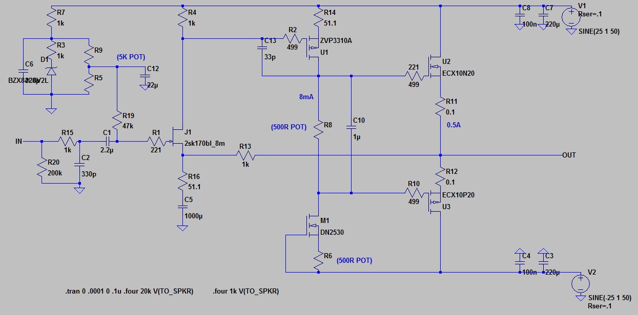

Keep the Zobel and if needed use 1k/100 Ohm solder across terminals as a light load.One annoying thing about the schematic I posted above is that a simple 1nH + 10R zobel on the output would clear that square wave right up and make it behave perfectly well with speakers attached...problem is it's oscillating with no load attached!
Hmm, what on earth is going on?
Is it really an issue anyway given that it won't oscillate with a reasonable load attached?
It's tempting to leave it as is and add a zobel to clean up that ringing and not worry about it!
Low loaded output and oscillation is normal.
Heavy load like 2 or 4 Ohm is more stable than 8 Ohm.

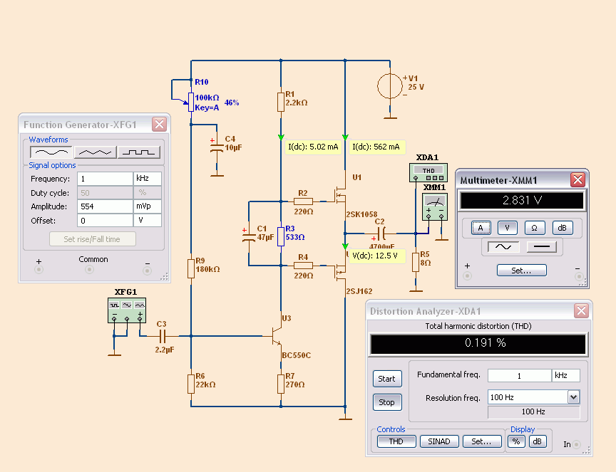

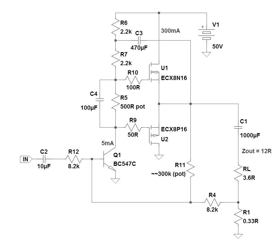

While still waiting for a bunch of P-ch mosfets to arrive to build my own Fetzilla (with BF862 i/p), I had an hour off at work to quickly solder up the probably simplest power amplifier I ever did... as this thread made me think of purposly "sounded" amplifiers more than ever...

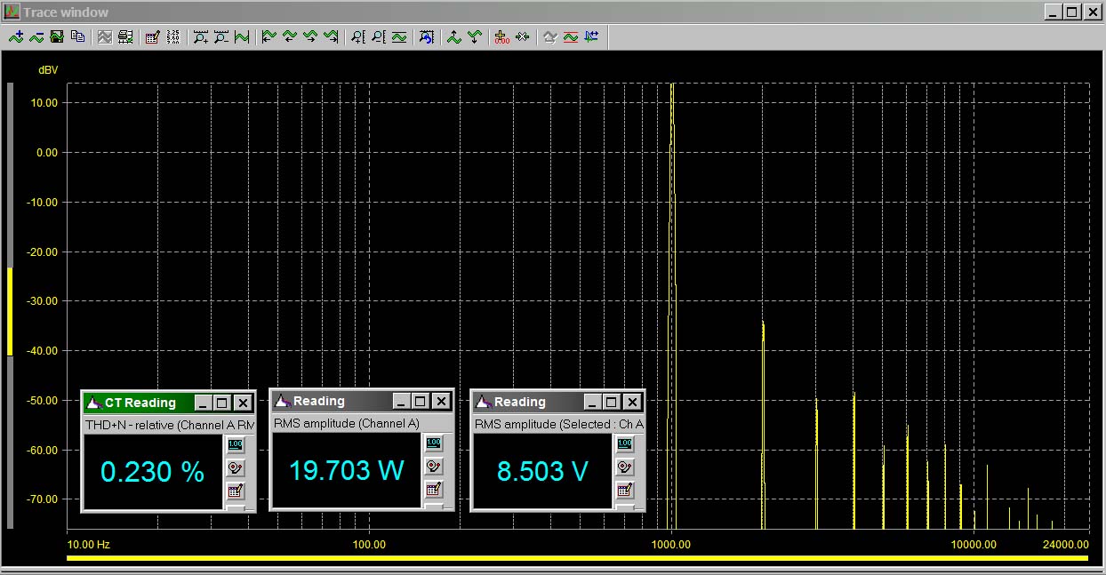

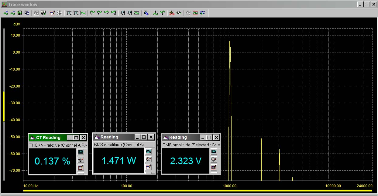

Measured not as horrible as I expected, and for the purpose of a tweeter amp (for high efficiency air motion transformer) with high output impedance a first listening test, comparing it to voltage drive from a high feedback elaborated bipolar amp, also had a quite unexpected result, it seemed to sound only slightly different if not better, not the expected grunge of a hell of IMD... I'm sort of confused...
The circuit is inspired by M.J. Renardson's excellent MJR7 amp which I have built a while ago (check out this amp design if not already known), just stripped down to the core and not tweaked in any respect... I'll try find time to try out things the next days...

Stable at last
All,
Here it is, stable as the titanic on a lake.
Turned out it was the VAS gate stopper....thanks mikelm!
Miller cap not completely necessary but it does tidy it up a bit. Driving 100nF causes just the tinest bit of overshoot, not enough to concern me.

Well that particular fix wasn't really my idea but it's great that you finally did it.
I look forward to hearing you subjective assessment etc.
I do hope it works with lead compensation instead of miller.

Mike,
With 33p of Miller cap and no phase lead, phase shift at 100KHz is 5.8 degrees and margin at 0dB loop gain (1MHz) is around 94 degrees.
With no Miller cap and 47p of phase lead, phase shift at 100KHz is 64 degrees and margin at 0dB loop gain (1.36MHz) is around 78 degrees.
These are both taken with identical 8R resistive load, no cap.
I think maybe the Miller (lag) compensation is the go......
