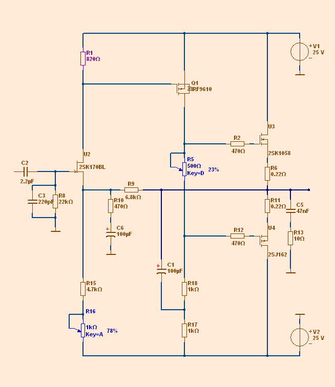

The Most SIMPLE Fetzilla
swordfishy
talked about a bootstrapped version
with only 4 active devices, transistors.
This version is the most simple I can think of.
Thanks to bootstrap distortion is a bit higher
THD=0.030% at 1kHz 1Watt
One current source is replaced by bootstrap.
The other current souce is replaced by potentiometer.
Transistors:
- input 2SK170BL
- vas IRF9610
- output 2SK1058 2SJ162
This will work.
It may evenso sound good.
But this I do not know. Yet.
Enjoy 🙂

Now we're cooking with gas.... I love the ol' bootstrap, it's a fail safe building block and it introduces H2 and H3, no bad thing. It can be tweaked slightly by using dissimilar resistor values.
Servos are fine if well designed, MiiB. And caps are pretty good if they have a DC polarising voltage across them! We all have our preferences, however, and I defend to the death your right to hold them.....
Amplifiers should practise safe sex, particularly with fragile jfet gates at the input. There should be a blocking cap. And if there is a blocking cap, it should have some volts across it.
As for power supply, since this design takes both its first stage current return and its feedback at source , it will have quite high PSRR. You will find it's very, very quiet, probably rather better than -100dB S/N ratio.

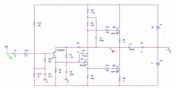

BTW, JLH did a Class A mosfet design many, many years ago. You might cast an eye over it; it's very, very similar to this design although it is quasi complementary (but notice the compensation, lots of it!).

I had the pleasure of nipping home at lunch time today to listen to the bootstrap version. Its sound is as good as the CCS version in my opinion. The only possible slight difference was maybe a little less bass, but if this is the case it is very slight.
However, I now understand and believe that the bass ability of this amplifier is largely dependent on OLG. Adding the bootstrap slightly decreases the OLG as it is not a perfect current source. I think a smaller VAS degeneration resistor will increase OLG and restore the bass. I will try this tonight. I might shoot for 20R or something. Hopefully stability will not suffer.
If this works OK the bootstrap version officially becomes my favourite circuit.
220uF rolls off your OLG from about 70hz
1000uF or 2200uF should help with your bass but you have a lot less OLG in the bass region with the bootstrap. Reducing the degeneration resistor to 20 will give you about 6dB extra gain in the bass region but this is still about 22dB less than you have with CCS @ 100hz and more than 30db less @ 20hz.

Yes, SWF's circuit. I actually don't like the 1st stage CCS Lineup is using, I prefer Linsley Hood's original, elegant circuit where the entire output from the jfet is routed through the feedback resistor. Simpler, and improves PSRR.
For me, it seems like a big advantage to have the feedback point not connected to the neg rail ( only if it is connected to the neg rail then it would be better to use a CCS - and a very good one at that ! )
Is that what you meant by "since this design takes both its first stage current return and its feedback at source" I hope so otherwise I'm confused. I think we might be agreeing again - but I'm not sure
Yes, precisely. I should have said,
'I like the fact that the entire first stage current is passed to the output rail via the feedback resistor, NOT to the rail, where injection of half wave rectified artefacts of the lower output device would be inevitable.'
