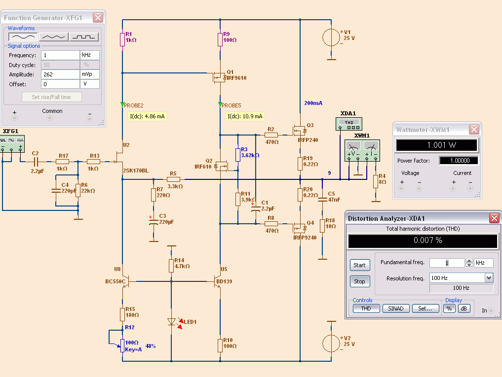

Another version using IRFP240/9240 is very useful to builders to experiment with these relatively cheap MOSFETs. To use IRFP240 and IRFP9240 in the output, is that ok to replace this output stage with the one mentioned in post #29 including Vbe multiplier?

Yes it can be used with IRFP240/9240.
In fact some month ago I did such a schematic of this amplifier.
One thing though.
VAS stage for IRFP240 should have at least 10 mA that runs through the VBE-multiplier.
It is good if it is 10, 15 or 20 mA.
THe other outputs ECX Exicon and 2SK1058 can have a VAS
with only 5 mA (or more)
My last schematic uses 10 mA for VAS stage.
It should be okay for IRFP240/9240.
Just add one IRF610 for VBE multiplier and replace the output devices.
I will post one such circuit.
Fetzilla with IRFP240/9240 version
Here you are.
One think you notice, I use blue for adjustable components.
What you need to adjust for zero output and idle bias in output.
For example I have adjusted R3 for idle bias 200mA through IRFP240/9240.
Actually IRFP240 simulates a little lower THD (0.007%) than 2SK1058.
But difference is very small.

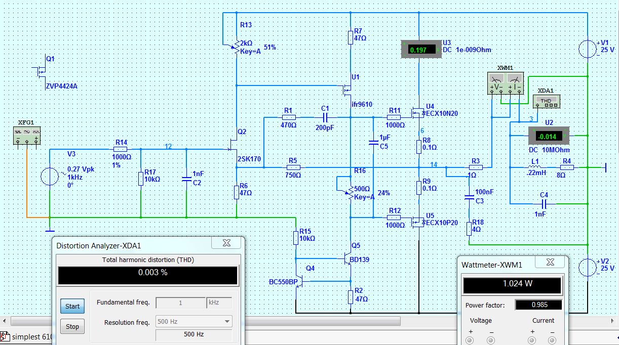

Hi Lineup,
I notice on this one compared with the earlier one you have less distortion @ 0.007%
But on my cct I get less than 1/2 this at 0.003%
I wonder why this is. I set my o/p to 200mA VAS to 14mA and I/P to 4.5mA
here it is . . .
With 1 amp in o/p stage it drops to 0.001% @ 1 watt
I set often 100mA for 2SK1058. 200mA for IRFP240
And there are small differences in circuit.
I use 100 Ohm for IRF9610 emitter. You 47 Ohm.
ECX10N20 may have lower THD than 2SK1058.
you have 750/47 feedback
I have 3300/220 feedback
THe lower values in feedback, the lower THD.
We might have two different models for 2SK170BL
All these small differences can make the difference from 0.003% to 0.010%
I can get 0.002% if I want from this topology.
But then I have to add capacitance (220pF) to get it stable.
The official version need no compensation cap,
and have a little more THD because of this.

I just noticed that as o/p stage current increases HD drops up till 292mA giving -98dB
After that HD gets steadily worse as current rises to 1A giving -96.6dB
Hardly any difference I know but interesting to find that sweet spot
Swordfishy - how high did you take the current when you said the sound got sweeter with more current ?
Maybe ideal current for ECX10N20 is like 250mA.

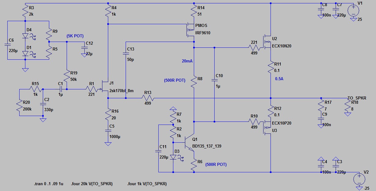

swordfishy runs 0.500A here:

Lineup,
You are testing the miller cap concept, but have you tested the concept I posted in post 531 as suggested by Hugh? I think it is even better than a miller cap, and was far more effective for correcting overshoot than a 150pF miller cap.

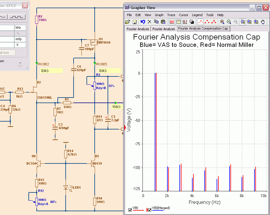

Lineup,
There is a difference between Miller Cap and VAS-Source compensation.
However at 1 kHz 1 Watt the difference is very small, in favour of VAS-Source.
I setup a Fetzilla which need compensation.
180pF Miller was right.
820pF VAS-Source gave correct compensation.
Then I ran Fourier at them both and put at same graph.
VAS-Source gave THD 0.0024%
Miller gave THD 0.0028%
You can see the Fourier in my diagram below.
Conclusion.
The difference is there.
But is, at least at 1kHz-1Watt, so small it does not matter what we use.
If we have bigger value cap, we use 820p
Otherwise we use 180pF Miller normal.
