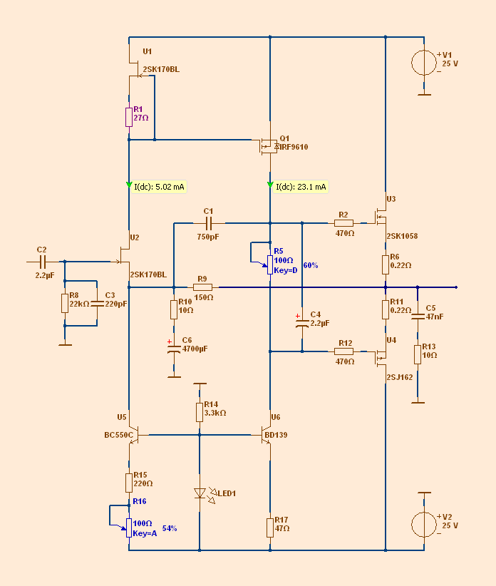

Thanks for your schematic of a simple 4 devices amp.
It will not be Fetzilla. But close it is.
Fetzilla uses JFET input.
IT is close to JLH idea.
I will try to investigate your circuit in SPICE.
Hey Lineup,
This IS a JLH design, not sure when, but somewhere in the seventies I believe.
There is nothing new under the sun...... live long enough, you see it all.
But then, you've seen it all too, haven't you?
Hugh

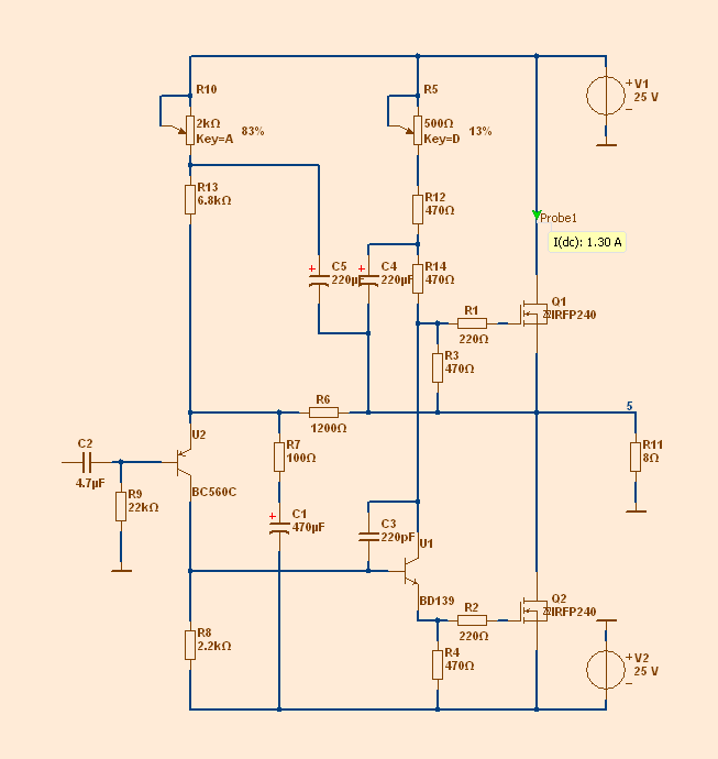

Fetzilla Ultimate - low distortion
This version is the ultimate Fetzilla.
It has very low distortion THD 0.001% at 1 Watt
It is when you want really good HIFI.
This version will probably not colour the sound so much.
It will be a clean and faithful reproduction.
Your speakers will have a chance to dominate the sound.
Enjoy 🙂

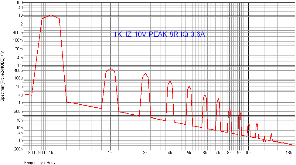

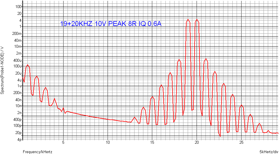

How much is the quiescent current of this schematic ?...
Making some sims at Iq 0.6A, i.e class A , it appears that THD is not exceptionnal
at high frequencies while being good enough at 1KHZ.
Global linearity is very dependant of the output stage linearity , that s
why a relatively high Iq is better.

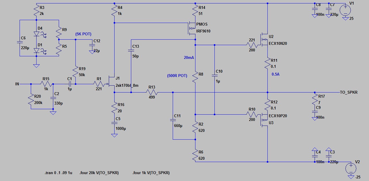

This sounds good...bass is better
Currently my favourite version.
Differences are:
1) Increased Bootstrap capacitance to 660u.
2) Decreased bootstrap resistance to allow a full 20mA of VAS current.
3) Decreased output fet gate stoppers to 200R.
Overall sound at all frequencies is vastly better. Bass is quite good, bigger bootstrap cap might do even better.
I also tried halving the VAS degeneration, but I don't think it really helped much, in fact it possibly made things worse so I will stick with the 51R for now.

SWF,
Most of this change would come from the gate stopper change. This has profound influence on bass for mosfets, even with verticals. Hint: try 220R on one, and 150R on the other.
You could reduce your bootstrap cap to 470uF with no ill effects.
I suspect that 12mA at the VAS would be fine, too.
ONE THING AT A TIME!!
You really do have too much energy!! But that's terrific, at the end of the day we all wish we had your energy.....
Hugh

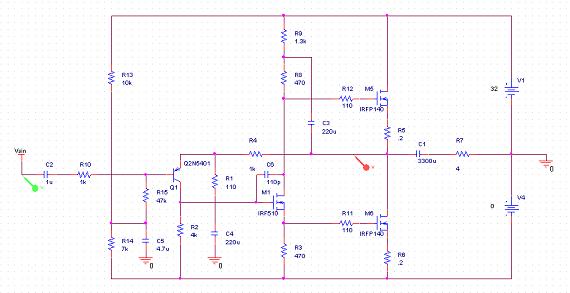

DC offset stability of this amp seems awfull , while distorsion
is three times higher than with Lineup s fetzilla.
Such CFB amps are somewhat out of date in their ancient form
and will provide no great perfs according to current standards.

Hugh, all modifications were done one at a time with a brief listening session in between. The bass improvement does not require much listening time to identify.
I simply posted the cumulative changes. Both the bootstrap and the gate stopper mod made an improvement.
As I said, I also tried halving the vas degeneration for more OLG. Didn't help so I left it as it was.
I have upped the current in the vas because I like the sound more, not for any technical reason. Don't you agree that fets sound better at high currents?
If I had to pick whether to use a bootstrap or ccs for the final version it would be tough. Bass performance of the ccs is better, but there's something very pure about the mids with the bootstrap. For pure vocal music I would pick the bootstrap without hesitation. For rock the CCS. If only I didn't listen to both.
