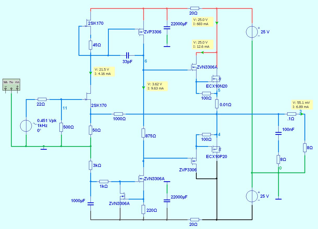

Please see below the circuit I've been listening to for the last few days.
I have made 4 significant changes over what I regard as the "Vanilla" version of the DC linked design.
1) Reduced drive impedance to 22 ohms
2) Added i/p stage CCS
3) Increased filter caps to 22,000uF
4) Put 3310a's in front of O/P devices to create MF "darlingtons"
( the diagram show 3306's but that actual amp has 3310's throughout. )
Each of these design changes brought a significant sonic improvement and together they have brought an already good design to a level of reproduction that I am very happy with.
As you can see I have been able to dispense with all gate stopper resistors and the bias spreader cap - I measured and heard no worsening of the sound with any of these omissions.
The amp appears to have an identical level of stability to the vanilla version and also appears to be unconditionally stable - Although I did not do exhaustive testing on this yet.
The i/p stage CCS has helped quite a lot with DC stability but I did not do a formal test on this yet either - need to buy a logger.
I cannot imagine there is anything more that I can now do with the design of this amp but would be interested if there are any further suggestions. It does not need less distortion but more speed would always be welcome.

If the .01R resistor is for Rds balancing, then you will need to wrap the 100R driver resistor around it as well to balance the current in the driver FET. Or you could use a single resistor across output MOSFET gates to bias both drivers, but I assume you haven't done this for a reason or it isn't significant to the sound.
Just for kicks you could also connect the VAS gate to the Jfet CCS source, so it gets some extra drive from the CCS...

Hi KT,
At present the 0.01R is simply to accurately measure the o/p stage bias current. I may play around later with a 0.1R to try and shape the HD signature but I wonder if I will hear it - the HD is pretty low now.
The composite output devices gave best stability in SPICE with the arrangement shown and I also liked it because it meant I could have very short leads connecting from the 3310's to the o/p MF's which I thought would be needed to successfully remove the o/p device gate stoppers. I soldered the 3310's directly onto the legs of the o/p devices.
Did u mean a kind of bootstrap between CCS & VAS i/p ?
If you did it might be odd as I have no cap across the bias spreader R and the bias would probably change with the signal - also my guess is that it would oscillate . . . but I'll try it in spice . . . . I can't blow that up!
Connect the gate of the VAS to the source of the input CCS (K170) and it becomes a source follower, helping to drive the VAS. Not the VAS CCS.

Hi KT,
I tried it and it made no difference in spice unless the lag compensation also came from there and if it did it effectively reduced the compensation levels and made the amp less stable - but I'm always interested to try a new idea 🙂

Nice design, Mike.
Using a CFP output stage with mosfet driver and lateral slave is a very good idea. This would make it far less tetchy to set up the bias, probably nice and progressive on adjustment. My only concern, even in deep Class AB, is the switchoff profile of the outputs - is there any ringing? I doubt there is, in fact, since when the outputs switch off the opposite number would be passing a lot of current, so any switching events would be buried in the high output current at the switching.
One of the advantages of the bootstrap is a better treatment of vocals, but at the slight expense of bass. Using a CCS, as you have done here, gives you marvellous FR but at the top end where the bootstrap is starting to tail off you still have very good impedance, and this must be tamed with lag compensation. The bootstrap circuit can actually avoid using LC, which is a neat trick.
I was never happy with an additional CCS on the input device, but you have made it work well and from what I can gather you think the amp actually sounds better for having one less cap. Greg's and my approach was to bias up the gate of the input stage and run the stage current through the fb series resistor, a bit simpler, and since the input cap is now polarised it sounds good anyways.

Thanks for you nice comments Hugh, I appreciate that.
Actually the o/p's are MOSFET darlington pairs rather than CFP's.
I'm always tempted with CFP's because at the volumes I use, they would probably very rarely switch, but in this design the darlingtons seem to be just fine - perhaps I'll try the CFPs in spice and see if they offer any advantages 😀
Yes, I tried both lead & lag compensation and I preferred lag - it just seems to sound more musical and I have a few tricks I am going to try with that soon.
I'm currently trying the amp with different speakers and so far I am delighted with how it has worked out - All the speaker have been very close to a rear wall but the new transmission lines give very nice sound staging within the available space.

. . . . . and from what I can gather you think the amp actually sounds better for having one less cap.
I just twigged what you meant here Hugh.
Actually I didn't remove the bias spreader cap because I wanted one less cap in the cct !
Rather, I discovered ( by accident ) that a 1V 44meg hz oscillation that appeared when I made o/p darlingtons and removed the o/p device gate stopper resistors, disappeared when the 4.7uF bias spreader cap was removed.
So removing this cap was an expedient measure that allowed me to use my preferred o/p arrangement ( which did sound better ! )
Also I just tried CFP o/p's in spice and they do indeed make the amp even faster and more stable. So provided there are not local oscillation problems when they switch they might bring another improvement.
