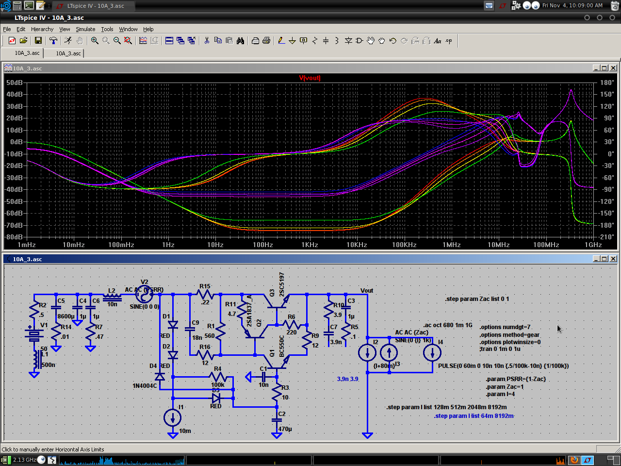

I just built this and am listening to my Fetzilla using it to filter the positive rails. It is a high-current version of one of my K-multipliers, HIGHLY experimental. So far I have 50MHz oscillation, though I'm not sure where from... But that's actually not bad, compared to the worst case scenario of it dumping lots of amps into the output capacitors and blowing stuff up. No, it doesn't store power, but it will replace a capacitor bigger than your head for filtering purposes. It is not a simple as it looks...
ROYG traces are PSRR, purple traces are output impedance.

Well, the oscillation wasn't the amp OR the K-multiplier, because it is still present when the circuit is off. It must be interference. Sometimes I suspect my oscilloscope is oscillating. 🙁
The K-multiplier lives up to it's simulations in this case. There is a ripple peak I think is caused by the capacitor charge pulses on the negative/unfiltered rail, but aside from that, I have not seen ripple during play go above 5mV peak. Though I am using sensitive FRs in a small room.
The bass definitely seems more authoritative and interfered with other instruments less, and this carries up into the midrange, making for some nice, clean guitar. However some of the treble clarity is missing, so I suspect I need to re-tune compensation. One more thing I may have difficulty doing without a signal generator.

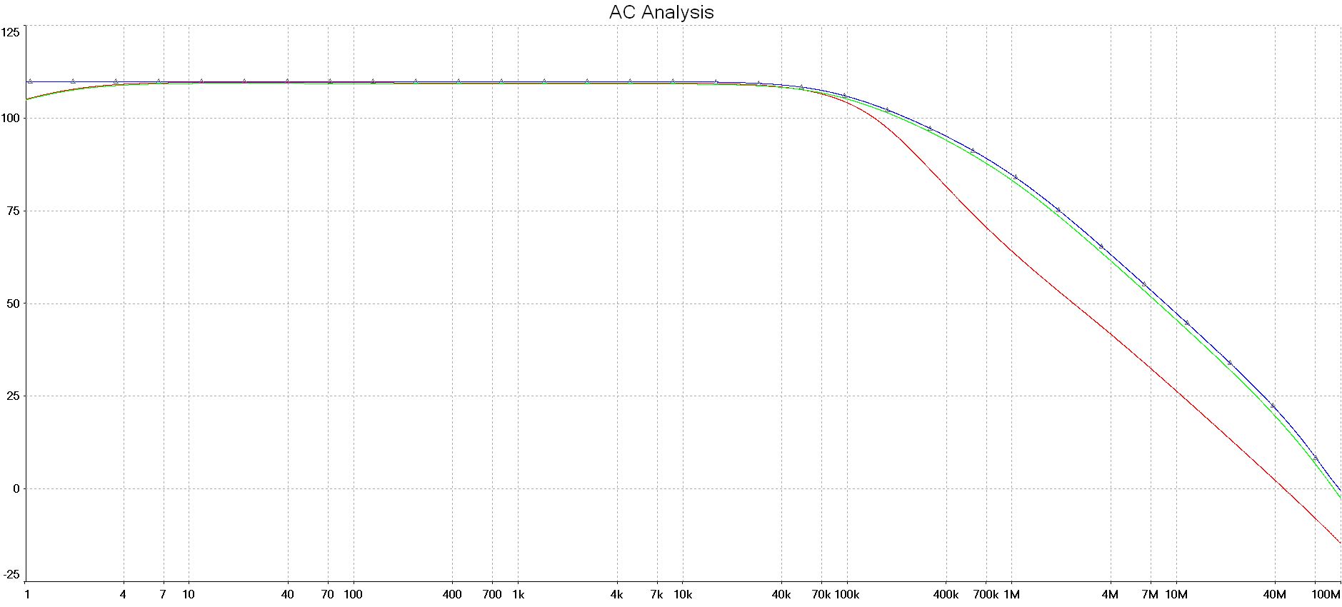

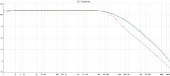

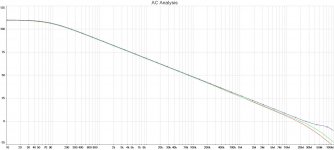

Hi Hugh,
I did some spice work on this topic after your comments got me thinking about this.
As you can see below the OLG in the audio band and up to about 100Khz, with no compensation, is substantially the same for single MF o/p device ( red ), darlington o/p MF ( green ), and MF CFP o/p ( blue ). Above 100khz both the darlingtons & CFPs show similar increase in OLG - up to about 20db more.
However, when 33pF of lag compensation is applied, the three different o/p options show very little difference in the critical regions - only about 2db difference between them.
But, the MF darlingtons give a considerable phase margin advantage and the CFPs appear to give even more.
Provided, as you suggest, the MF CFPs are less susceptible to ringing / oscillation than the bipolar version, then I think they could be a good sounding o/p option for this design.
As you can see from the graphs I have already defected to the "high feedback" school of thinking by using a CCS in my i/p but as long as this is suitably curtailed before critical region I find no disadvantages and many advantages - because, so long as we employ about 33pF of lag compensation, the OLG in the critical region is more or less the same with this design regardless of whether we use an i/p CCS and regardless of which of these o/p options is chosen.
This has encouraged me to add the CFP o/p to my list of things to try. 🙂

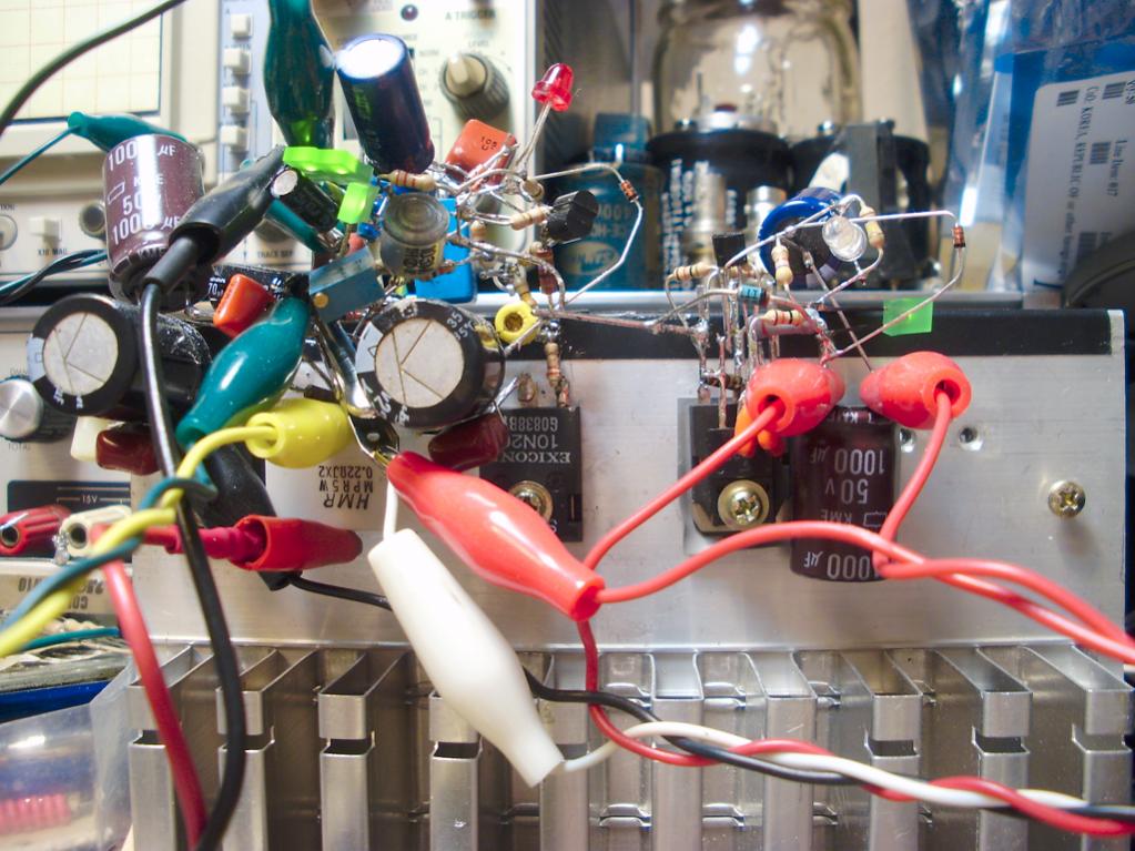

Today after connecting the high-current K-multiplier I disconnected the frontend rail filter. There was an increased clarity in the treble and midrange. Since the rail variations are below 5mV, I don't think it is necessary. I will next adjust the convenient trimmer cap I have placed as the phase lag compensation to try and dial in the enjoyable sound again... Unfortunately this does not necessarily coincide with a stable amplifier.
