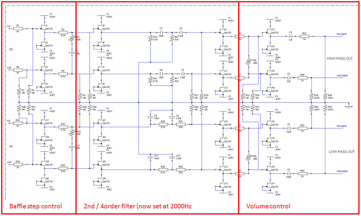

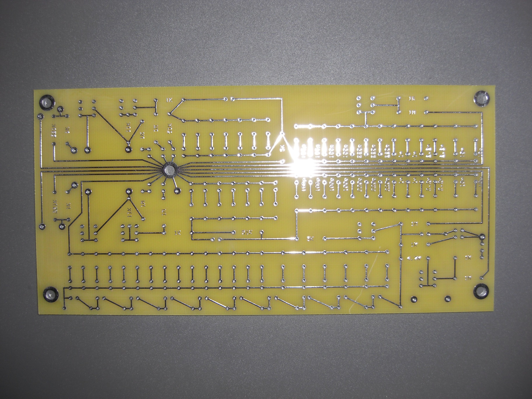

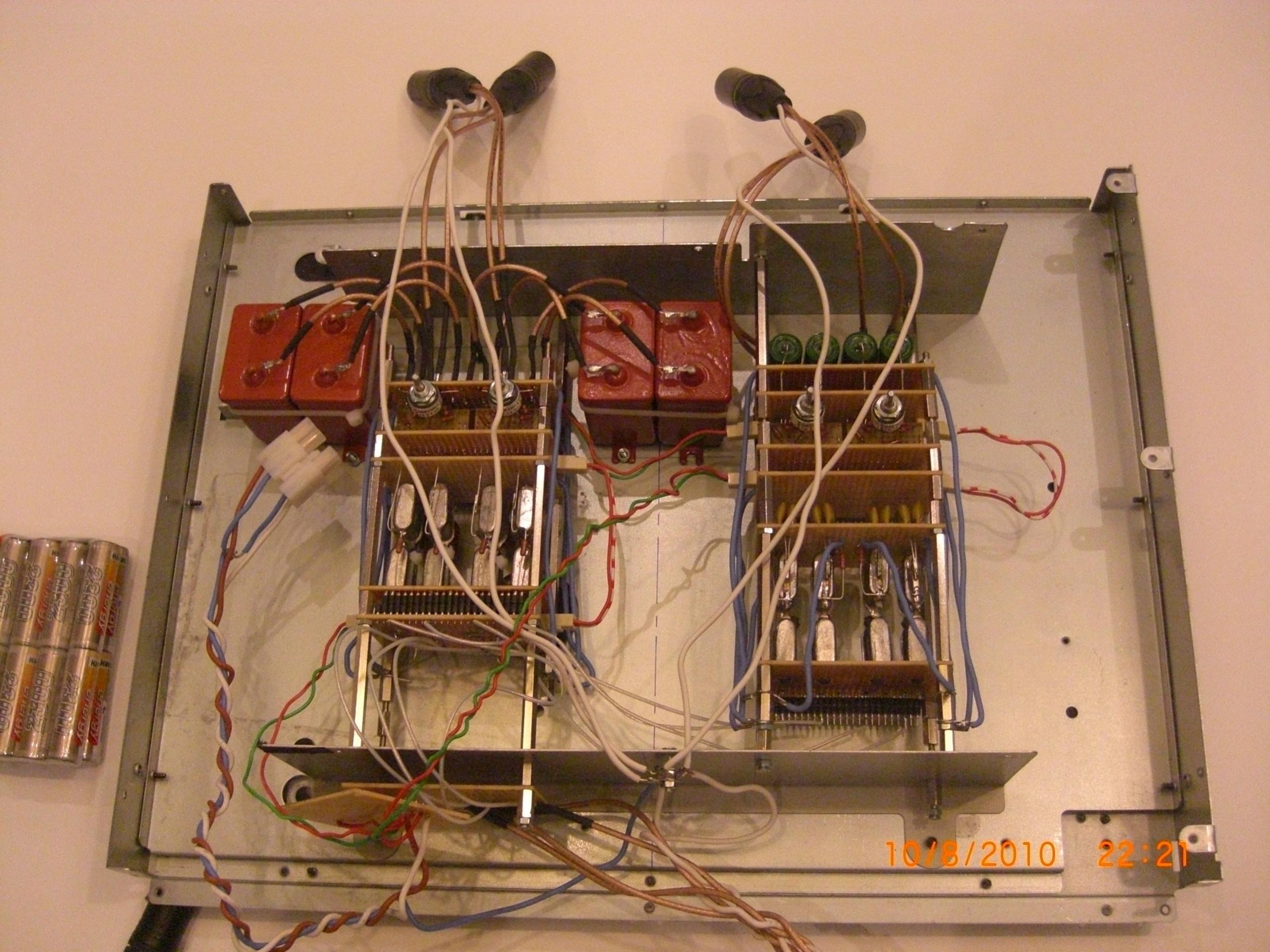

Hello all,
i have posted this in another thread as well. I use a prototype of a PLLXO with discrete buffers (B1) in a symmetric setup. This works very well. Sound is astonishing. This one is battery powered.
I am now building a high quality pre amp. There will be a jfet based line stage, a 46 stepped attenuator. and a integrated crossover. Complete symmetrical setup, 4 PSU included. The new cross over also has an incorperated shelving filter
The components in the divider stages and de baffle step (shelving filter) are kp1830. The coupling caps are russion PIO or silver mica (still have to experimanet with that). The filters are variable and can be set with jumpers.
I had some PCB's made by PCB express for the crossover and now i am soldering all components to the boards.
I have shunt stepped (12 steps) attenuators on the LP and HP. Probably one only needs an attenuator on the HP section. The attenuators are not in the signal path.
