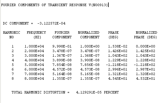

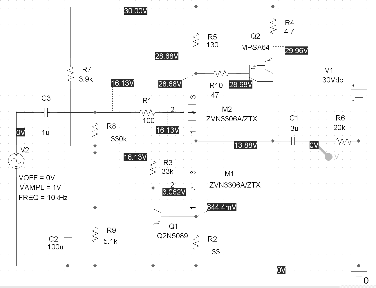

I'm starting a new crossover circuit for my latest preamp, that will incorporate RIAA amp, lineamp, and crossover in a single box. The unity gain block for the filters is a variation on circuit "D" in the first menengerie. If you use a 2SK170 or a small signal mosfet for the input device with sufficient bias current, the THD is vanishingly small (~3-5 X 10-5).
The option of using a small-signal mosfet is attractive, as they are readily available from the usual distributors, unlike certain exotic Japanese jfets. Anyway, since this is a unity gain circuit operating at high signal levels, noise is not anywhere near as much a concern as in an application like an RIAA preamp, thus the choice of devices can be more broad. The lowly 2N7000 general-purpose small-signal mosfet acquits itself well, though the main concern with that device is the relatively miserable junction-ambient thermal resistance of 300C/W. The Zetex ZVN3306A is a nice choice, and the E-line package can handle more power than the usual TO-92. Bias currents of 10-15 ma for the input device using topology "D" and a small-signal mosfet input device yield astonishingly small THD levels in simulation. Even if the THD is 10X higher in practice, it looks like a nice circuit to try. I'm using something similar for the lineamp in my current system, and I have no complaints about the sound.

This is the "gain" block for the new filter I'm making, using reasonably non-exotic parts available from places like Digi-Key and Mouser. The Darlington stage fed back 100% to the input mosfet source helps limit the current excursion of the input device and pumps up linearity.
The part values shown would more or less work in real life, though one can take some liberties with the values for the input and output coupling caps, especially for the high pass section. I'm using 0.1uF Russian polystyrene caps for all the inputs, and for the high pass outputs. The output caps for the low pass section will be 3uF polypropylenes made by Aerovox. The frequency-determinimg caps are Roederstein KP1830 series polypropylene/foil, 1.5 nF, 100V. All the caps were obtained from Ebay/surplus sources.
