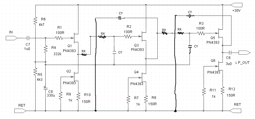

Here's a representative schematic for a 24dB HP filter in the style I've been using so far. The R's and C's for frequency/Q determination are left open for whatever the experimenter has available. All the Cx values will be equal. The Rx and RY values are chosen and ratioed for the required crossover frequency and Q. The Linkwitz site on active filters (Google is your friend...) is an excellent and concise guide for this.
I use the PN4393, as it is a good middle-of-the-road fet cheaply available from sources like Digi-Key and Mouser. You can be snobby and use something like the 2SK170 (or a BC-style Euro-fet for that matter), but You'll have to adjust the values on the current sink resistors for appropriate operating current. Adding some bypass caps across the power supply wouldn't hurt, either.

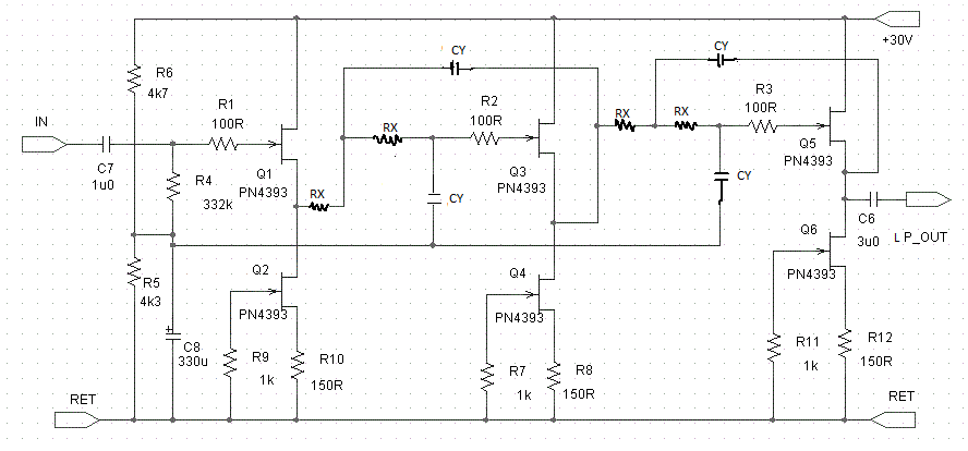

Is correct the attached pic for 24dB LP filter?
Like the attached schematic?

The unity gain followers must be set to 2pole Butterworth to obtain 4pole LR.
The doubled capacitor is required to get Butterworth.
Wrench is refewrring to the other Cy.,
the feedback from the output must connect to the midpoint of the two resistors.
The Cy to the gate cannot pass half supply bias and so there is no need to take them to the bias supply.
The gate connected Cy can go to supply -ve/ground.
But when you do the HP, the gate connected resistor MUST go to the bias supply.
