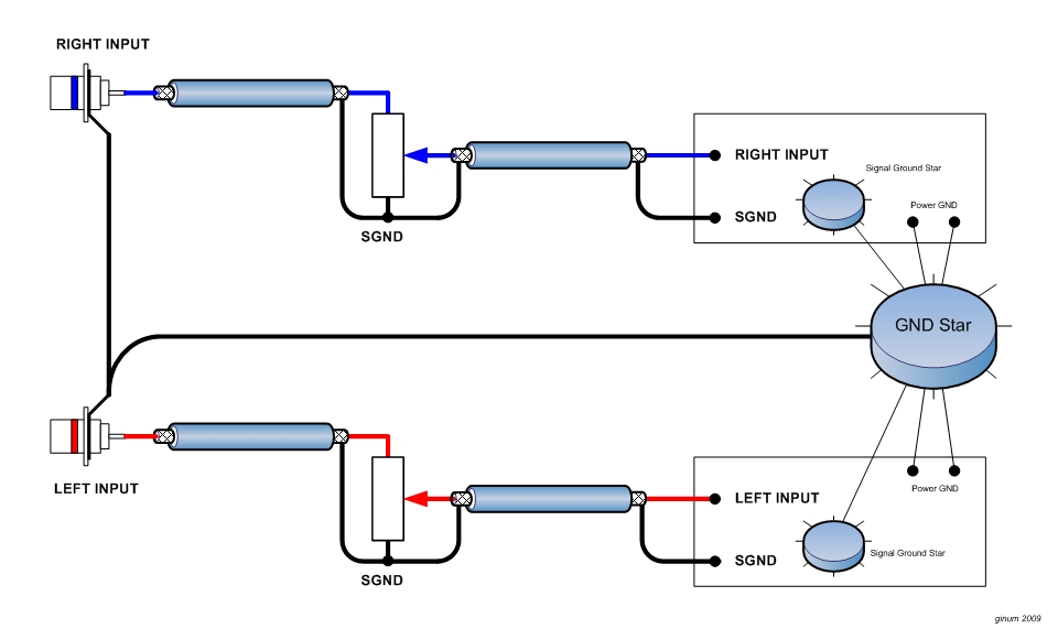

I'm not sure about your drawing- What exactly is that represented by the arrow in your diagram?
-Chas
Not what you said. You said you were connecting shield to black on RCA, and that you had an isolated RCA. I'm saying connect the shield to chassis, not the RCA.
connect the shield to the chassis at the RCA end, and leave it unconnected at the PCB
That's what I'm doing
and label both ends, "grounded shield" or "floating shield"
The input cable I've chosen is a shielded, symmetrical twin-conductor (red for positive, black for negative plus a shield with drain wire).
is that cable shielded twisted pair?
The twisted pair gives the main attenuation of interference, both magnetic field and electrostatic field.
The shield gives a little attenuation of electrostatic field only and non for magnetic field.
If it's a parallel pair with a shield you are wasting your time. Get unshielded twisted pair (UTP).

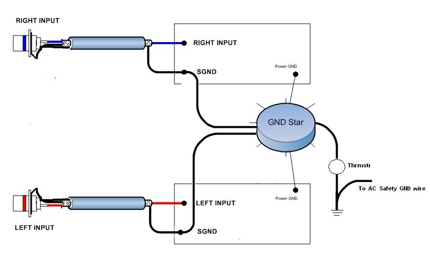

If you have humming, it is not likely to be due to this shielded input connection. In fact, unless this line is long and comes near the power cable or transformer, this line should not be an issue. As Andrew said, the twisted pair should provide most of any rejection.
Keep that line away from power lines and the transformer. If they cross, try to cross at 90 degree angles. This will be the the most likely cause of any humming from WITHIN the chassis, and the shield will do little or nothing to stop that.
The shield would only be effective for RF radiation, and the grounded chassis should keep that out, except for any from the bridge rectifier.
If you have any humming after that, and you connected everything as Leach specifies, your most likely cause would be a ground loop via the preamp, especially if it has a grounded chassis. If you get humming, follow Leach's instructions on his web site under the construction link to rectify it.

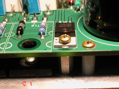

Question on the T21/22 Transistors. Given picture below: The metal post carries heat to the Heat Sink from T21/22. Should the back of the transistor use insulator or is this juncture metal to metal (using heat sink compound)??
regards, BP

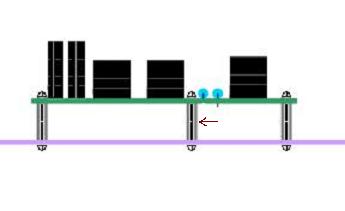

It's a good idea to insulate these boards from the chassis, using nylon standoffs, nylon washers and maybe even nylon screws as well.
While doing final testing for shorts before powering the Leach boards I noticed that even with (tapped) nylon standoffs and short screws coming in from top and bottom(see drawing), I was getting a short between one of the rails and ground. I traced it to one of the mounting screws. A metal washer was barely cutting through the paint on the board covering the edge of a trace and it so happened that very screw that was a tiny bit longer than the others, due to some flashing on the end, which just made contact with the bottom screw, grounding to the chassis. I had tested everything before "torquing" all screws down during final assembly and it was fine... 😱
Just another example that the "Devil is in the details" !
