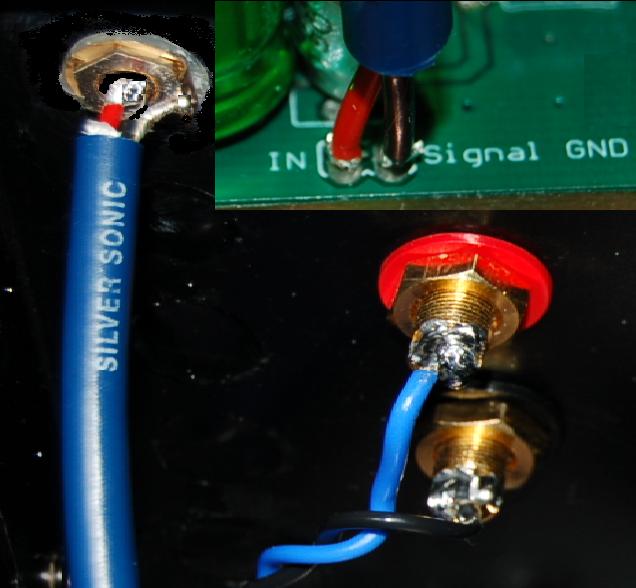

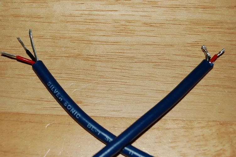

Input wiring
Doing the final signal wiring, and have a question:
The input cable I've chosen is a shielded, symmetrical twin-conductor (red for positive, black for negative plus a shield with drain wire).
Since the input GND on the PCB is already wired to the star GND,
should the drain wire(shield) be connected to the black wire at:
a) the RCA jack(which is insulated from the chassis),
b) the point of connection to the audio GND on the PCB , or
c) both?
Thanks in advance.
-Chas

Re: Input wiring
According to Morgan Jones, (a) - always connect the shield to the ground of "source" end. In this case, the RCA end.
