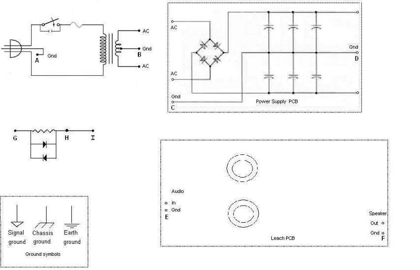

Ground connections
OK, Guys. I'm almost ready to hook everything up; BUT, knowing that we have here a vast resource of information, I did a search for info on "ground connections". To my surprise, I found as many different recommendations as there were contributors! So many, in fact, that I'm feeling a bit confused and discouraged (and I'll bet I'm not alone)...

, I'll stick my neck out and ask for guidance in this thread, specific to this Leach Class A/B amp, regarding connection of the various "grounds" without excessive theory or unnecessary complication(there are already enough threads suffering from that). Basically, what connects where for minimum hum and noise?
Attached is a diagram showing a center-tapped transformer, diode bridge with smoothing caps(PCB-mounted in my example), one token ground-decoupling circuit, and the (Rasmussen-Leach) amp PCB. For simplicity, lets say the amplifier is built upon a conductive metal chassis. All possible ground connections are given letters, and a legend of conventional ground symbols is provided for reference, taken from Wikipedia:

Chas,
Some of the best ground schemes can be found in the Pass section. The way Nelson connects most of his grounds is to use a common star for all of the board circuit grounds leading back to the ground for the power supply caps and transformer center tap. Then semi-isolate the chassis ie, power cord,
ground to this with a thermistor.
Make sure the power cord ground is firmly fastened to the chassis DIRECTLY. Make sure to include the speaker grounds in this common location.
The pcb screw mounts have to be isolated from the heatsink on Jens board ie, nylon standoffs or the like.
I really do not think you will have much problem with noise in this design. My amp is dead quiet. I also use a full isolated ground on my projects. It is a 10 foot copper rod driven into the ground and connected to the ground on my dedicated power plug at the wall. This is completely isolated from the rest of the house. Works good. Of course the rest of my house only has 2 prong plugs.

Chas -
As Tad said, it is an absolute requirement to connect the ground lead on the power cord, A in your picture directly to the chassis. Use a star washer or lug to ensure that it establishes a good contact with the chassis.
For an extra bit of clarity early Saturday morning:
Let's use point D in your picture as the star ground.
The signal ground is one is separated from the power ground by R4. Connect the input jack ground to E and also run a wire from E to D. (28 gauge or similar) In Leach's article he mentions that if you experience ground loops, you can eliminate the D-E connection.
The speaker output F is also the board's power ground. I should connect to the star, D. Same with the transformer center tap B. Use heavy gauge wire (14 gauge or heavier) for this connection and the ones below.
Connect the speaker output ground F to D.
I'd consider C just the other end of the bus between the power supply caps. For belt and suspenders grounding, you can connect it to D. If using screw terminal caps, each one gets a wire to D, and C doesn't exist.
So far we have the amp electrically isolated from the chassis. It will work this way. This is the only way I can get mine quiet if connected to my laptop and it's noisy PSU.
Most grounding schemes connect the star ground to the chassis. Connect G to D and H/I to the chassis and you're set. This can be at or near the point you have connected the power cord ground or another convenient spot assuming good electrical connection between chassis panels. Be sure that the diodes are fairly high current rated (3+A continuous) and use a 5W resistor. You can substitute a thermistor for the resistor//diodes as Tad pointed out.
Pass speaks of grounding in many of the threads in his section of the forum. I'd give his (and the other big names) thoughts on the subject much more weight than regular members like me. As I see it the common thread is star grounds for the amp isolated from earth by diodes//resistor or thermistor. Leach adds the resistive connection between power and signal grounds, which seems to anticipate ground loop problems.
Another item gleaned from building a Hafler kit years ago concerns wire routing. The DH500 power leads are twisted tightly together and run against the chassis as long as possible. Hafler said that this contributes to noise prevention and not doing so could result in hum. True or not, it makes your build look more professional. 😉
